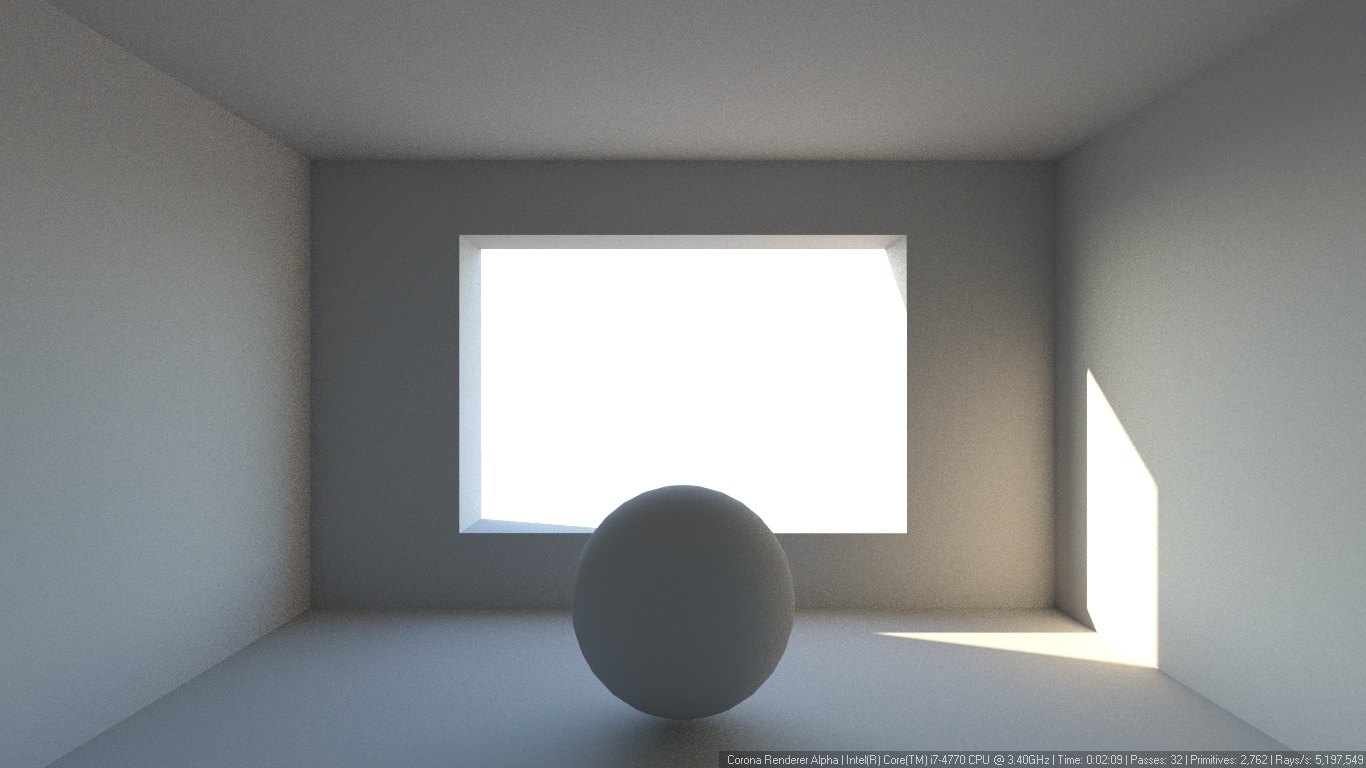

1. GI samples
1.1. Image rendered at default settings. 4 passes. There is much GI noise and geometry edges are not smooth.
Per-pixel:
1AA sample per pass * 4 passes = 4 AA samples total
16 GI samples per pass * 4 passes = 64 GI samples total
2 * 16 direct light samples * 4 passes = 128 direct light samples total
1.2. Image rendered at default settings. 16 passes. There is less GI noise and geometry edges look better, but the image is still low-quality.
Per-pixel:
1AA sample per pass * 16 passes = 16 AA samples total
16 GI samples per pass * 16 passes = 256 GI samples total
2 * 16 direct light samples * 16 passes = 512 direct light samples total
1.3. Image rendered at default settings. 32 passes. There is less GI noise and geometry edges look good. This means that no further antialiasing is required for this scene (no more passes) but GI needs more samples to refine.

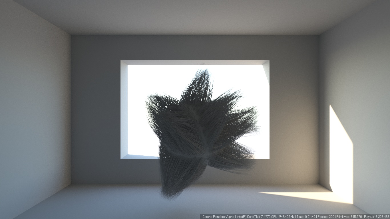

5. Fine geometry
5.1. Hair and fur modifier. 4 passes.
5.2. Hair and fur modifier. 16 passes.
5.3. Hair and fur modifier. 32 passes.
5.4. Hair and fur modifier. 200 passes.
Conclusion: number of passes (AA samples) decides the quality of fine geometry, especially where dark and bright edges meet.
