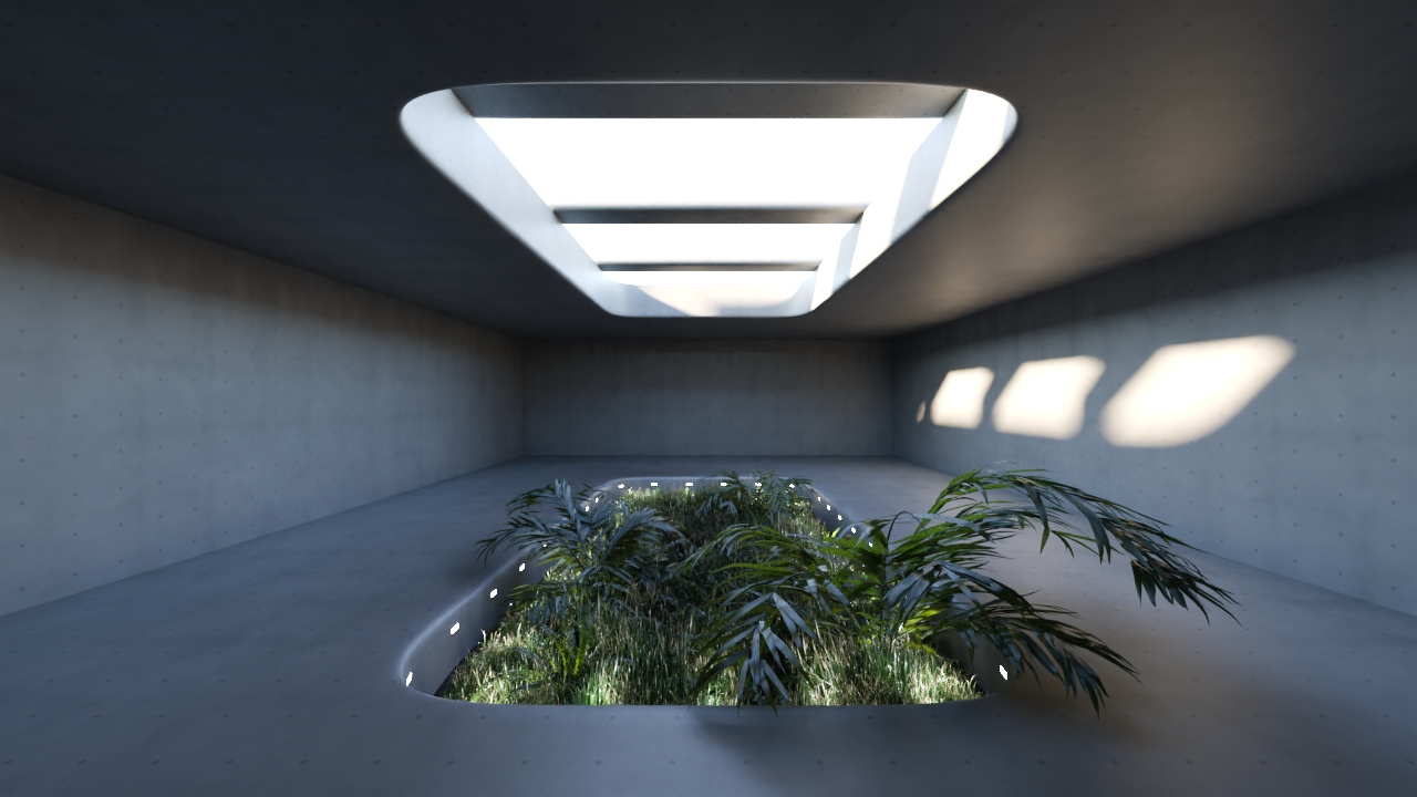

Examples
1. No denoising
2. Corona High Quality Denoiser - amount: 1,0
3. Corona High Quality Denoiser - amount: 0,65
4. NVIDIA AI Denoising - amount: 1,0
5. NVIDIA AI Denoising - amount: 0,65
6. Intel AI Denoising - amount: 1,0
7. Intel AI Denoising - amount: 0,65
