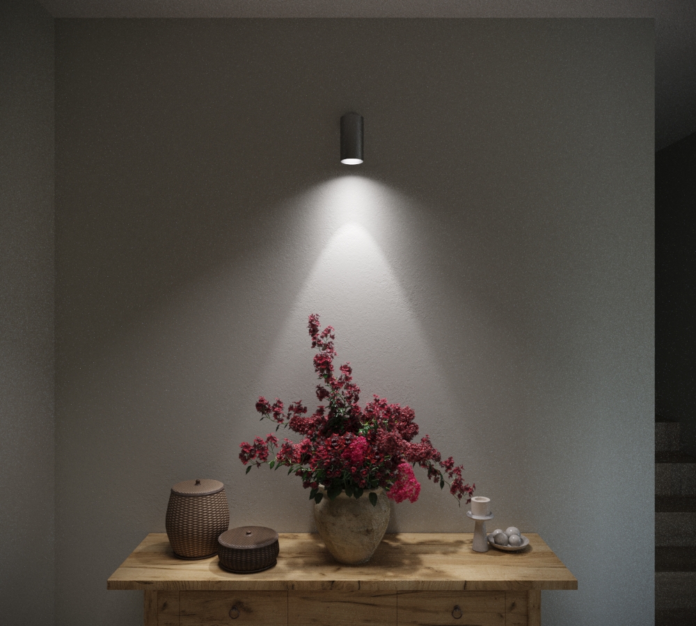

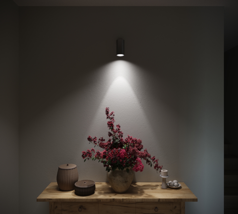

2. GI Solvers.
2.1. Comparison between a scene rendered with the same settings, using Path Tracing + UHD cache, and Path Tracing as both solvers:
- PT + UHD;
- default settings;
- 200 passes.
- PT+PT;
- default settings;
- 200 passes.
Conclusion: using the UHD cache as a secondary GI solver significantly reduces the number of required passes, thus reducing the render time.

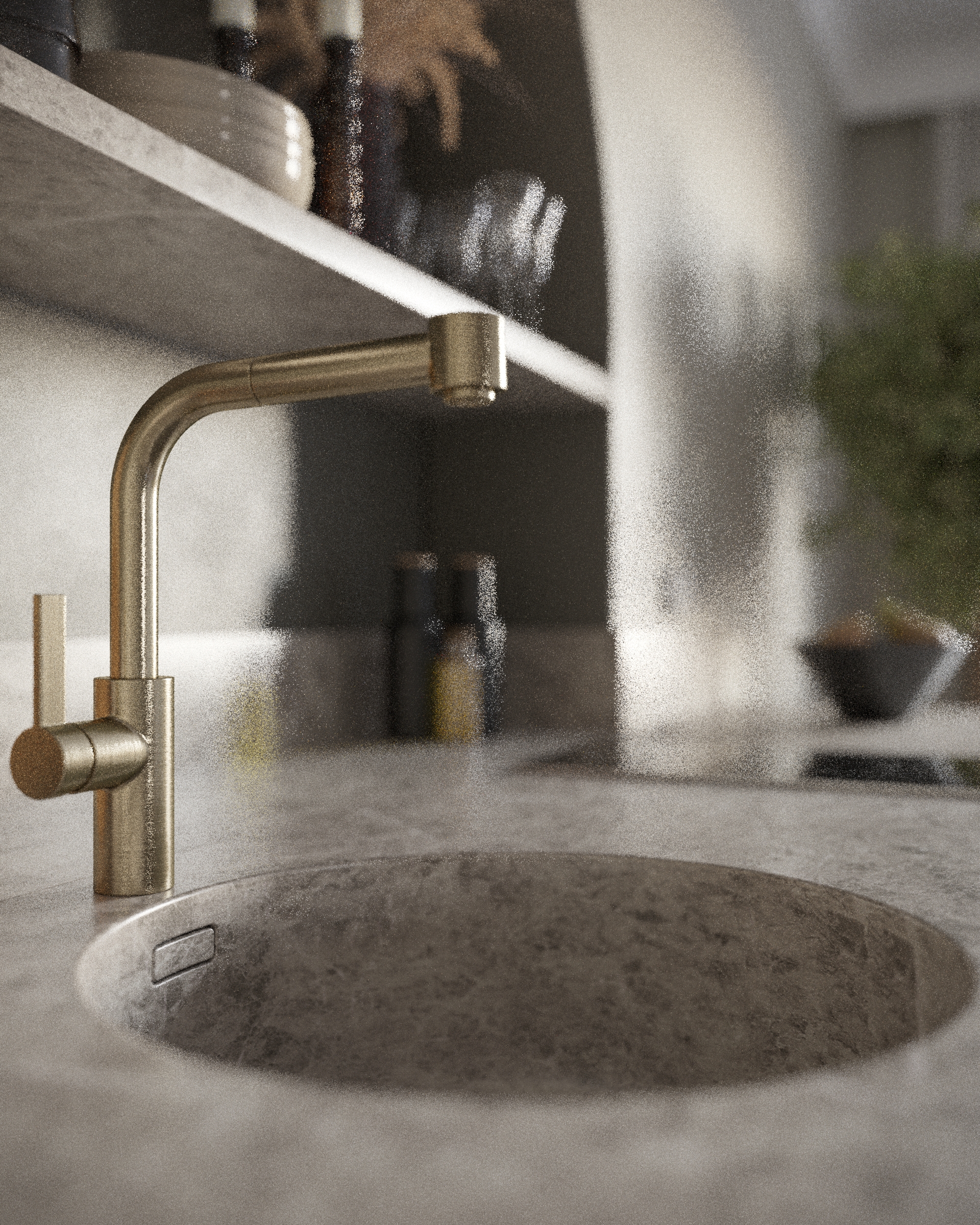

4. DoF & motion blur.
4.1. Scene with strong DoF effect - 4 passes:
4.2. Scene with strong DoF effect - 16 passes:
4.3. Scene with strong DoF effect - 64 passes:
4.4. Scene with strong DoF effect - 200 passes:
Conclusion: the number of passes (AA samples) decides about the quality of depth of field. This also applies to motion blur.

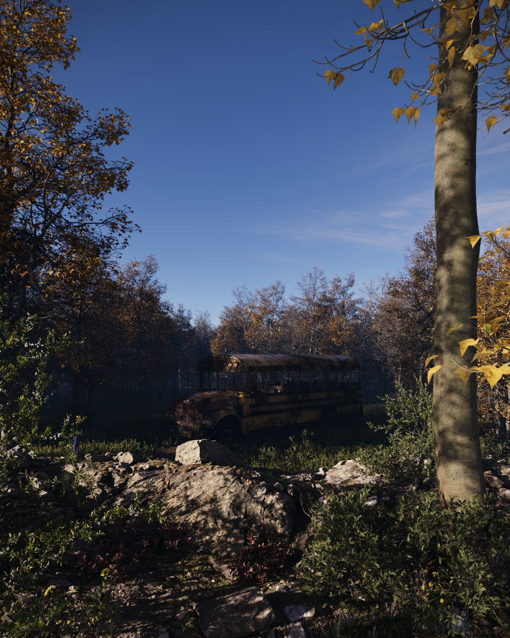

5. Fine geometry.
5.1. Fine geometry - 4 passes:
5.2. Fine geometry - 16 passes:
5.3. Fine geometry - 32 passes:
5.4. Fine geometry - 200 passes:
Conclusion: the number of passes (AA samples) decides about the quality of fine geometry, especially where dark and bright edges meet.

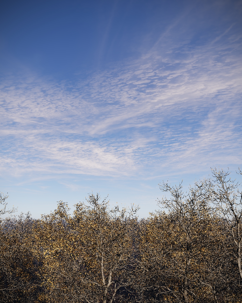

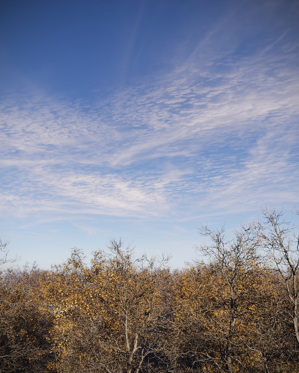

6. Fine textures.
6.1. Textured objects - 4 passes:
6.2. Textured objects - 16 passes:
6.3. Textured objects - 64 passes:
Conclusion: the number of passes (AA samples) decides about the quality of textured materials, especially if the texture is very fine.
