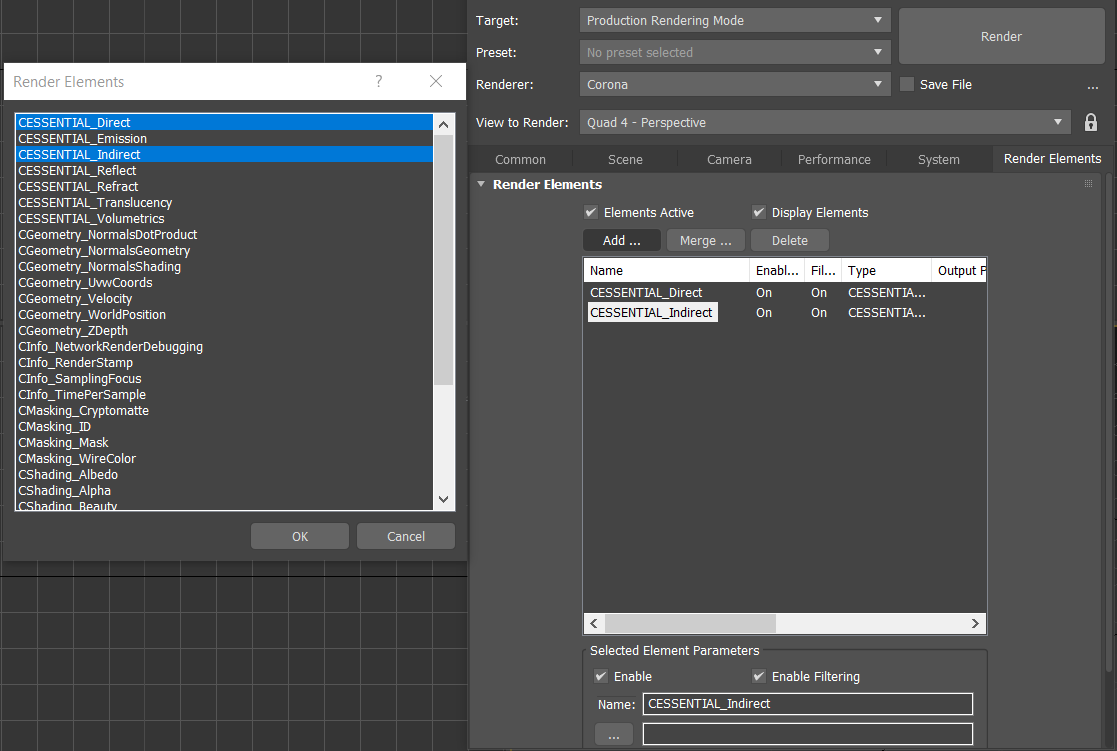

3ds Max:
Go to Render Setup > Render Elements > Render Elements rollout and press the "Add..." button. Pick CESSENTIAL_Direct and press ok, then repeat the same process with the CESSENTIAL_Indirect element:

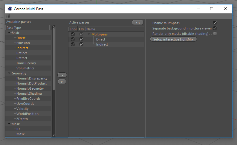

Cinema 4D:
Go to Corona > Multi-Pass..., enable the Multi-Pass, then add a Basic > Direct and Basic > Indirect passes:
Once this is done, you will be able to see the selected render elements on the roll-out in the Corona VFB during rendering.

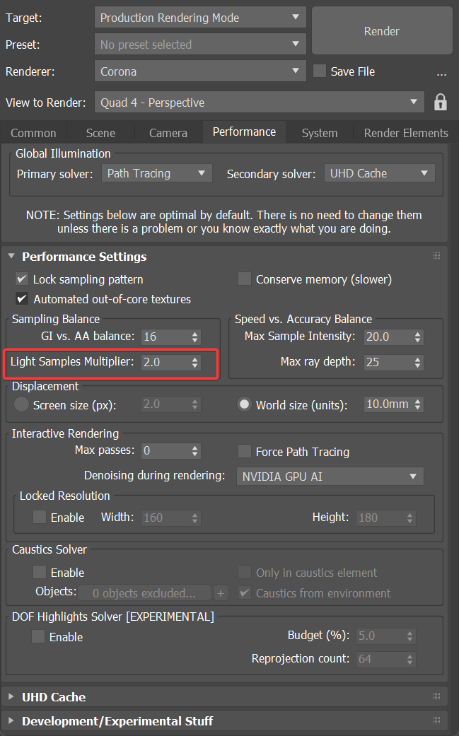

    • 3ds Max:
      Render Setup > Performance > Performance Settings > Sampling balance and slightly increase the Light samples multiplier. The default value is 2, and it is not advised to increase this value above 4.

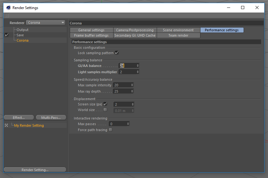

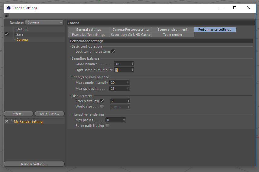

    • Cinema 4D:
      Render Settings > Corona > Performance Settings > Sampling balance and slightly increase the Light samples multiplier. The default value is 2, and it is not advised to increase this value above 4.

    • 3ds Max:
      Render Setup > Performance > Performance Settings > Sampling balance and slightly increase the GI vs. AA balance. The default value is 16, and it is not advised to increase this value above 64.
    • Cinema 4D:
      Render Settings > Corona > Performance Settings > Sampling balance and slightly increase the GI vs. AA balance. The default value is 16, and it is not advised to increase this value above 64.

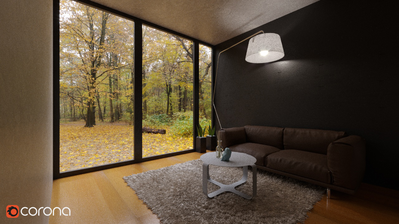

A standard beauty render after 16 passes with no denoising:

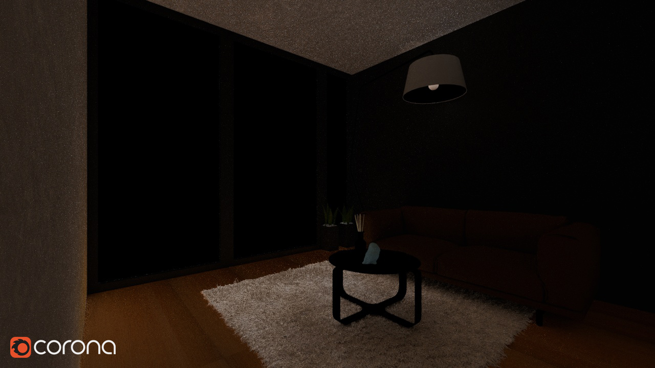

Noise visible in direct light (the Direct pass):
After 16 passes there is still visible noise in direct light. If it persists, this may suggest that more direct light samples are required to efficiently render the image.
