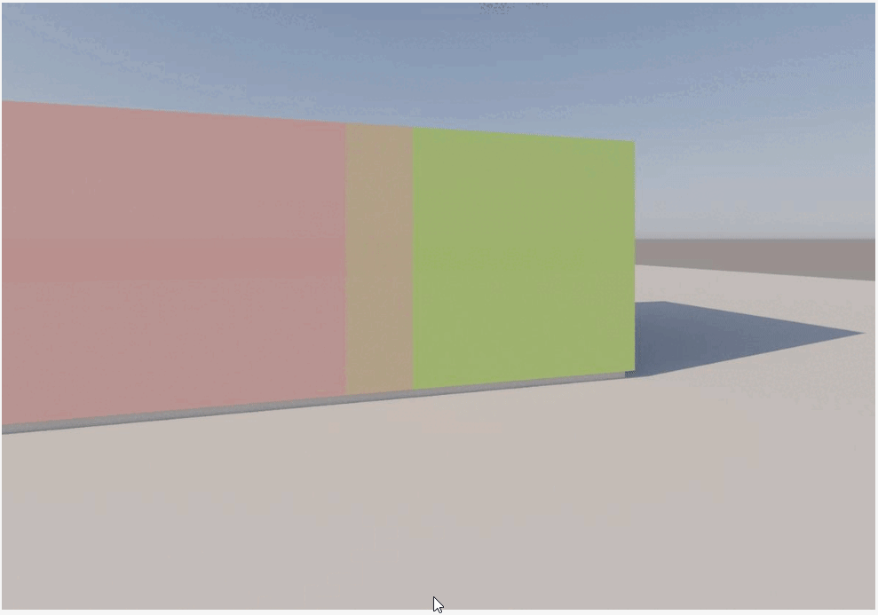

  1. Large splotches
    Splotches can be caused by various issues. In this case - wrong UHD Cache settings.
    Solutions:
    - Make sure your Secondary Solver in the Performance tab of the Render Setup window is set to UHD Cache
    - Make sure you are using the "Animation (flicker-free)" preset in the UHD Cache settings rollout.

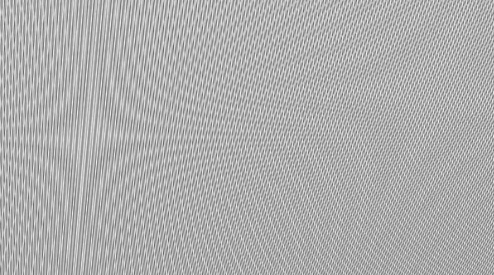

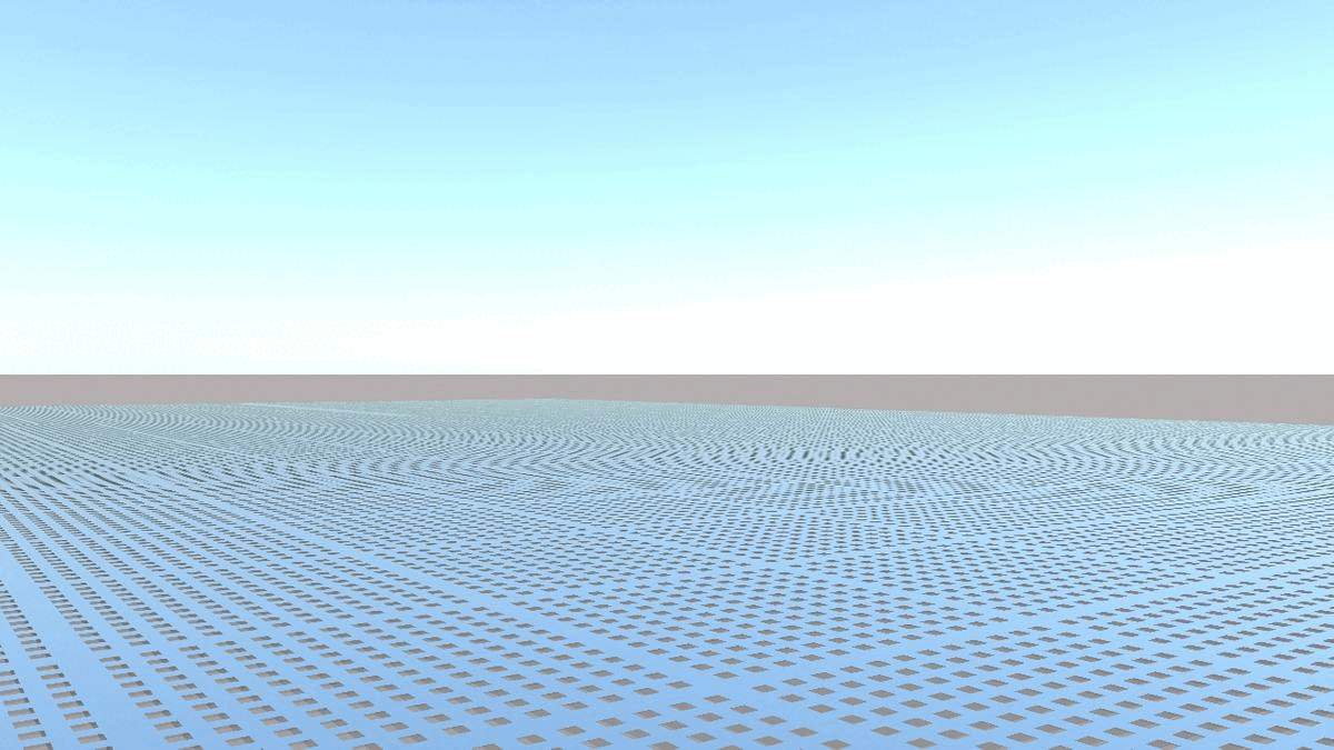

  3. Moire - usually a shimmering effect is seen when two or more patterns (such as two sets of parallel lines) are placed on top of each other. This can happen with such things as wire fences, floor tiles, etc.
    Please note that this is an expected effect which also happens in real life and is seen, for example, in digital photography. For more information about moiré patterns - check this article.
    A static moiré pattern.
    A moiré pattern appears when the camera is moving over a surface with a detailed texture.
    Solutions:
    - Render your frames in a higher resolution and downscale them in postproduction.
    - Use an Image Filter with a higher Width value - it will suppress the moiré pattern and other artifacts by slightly blurring the image during rendering (you can choose your image filter and change its width in
    - 3ds Max: Render Setup > System > Frame Buffer > Image Filter
    - Cinema 4D: Render Settings > Corona > Frame Buffer Settings

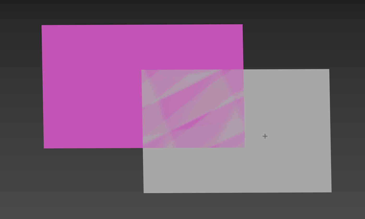

  4. Z-fighting  - occurs when two polygons overlap with each other. If polygons occupy the exact same 3D space they will fight to display and flicker through each other due to some imprecision in the 3D viewport display and the rendering itself:
    Z-fighting as seen in the 3ds Max viewport:

    Solution:
    Move any flickering polygons to a different location if more than one is in the same space (for example: move the flickering object up or down just a little bit so that it does not overlap with other objects).

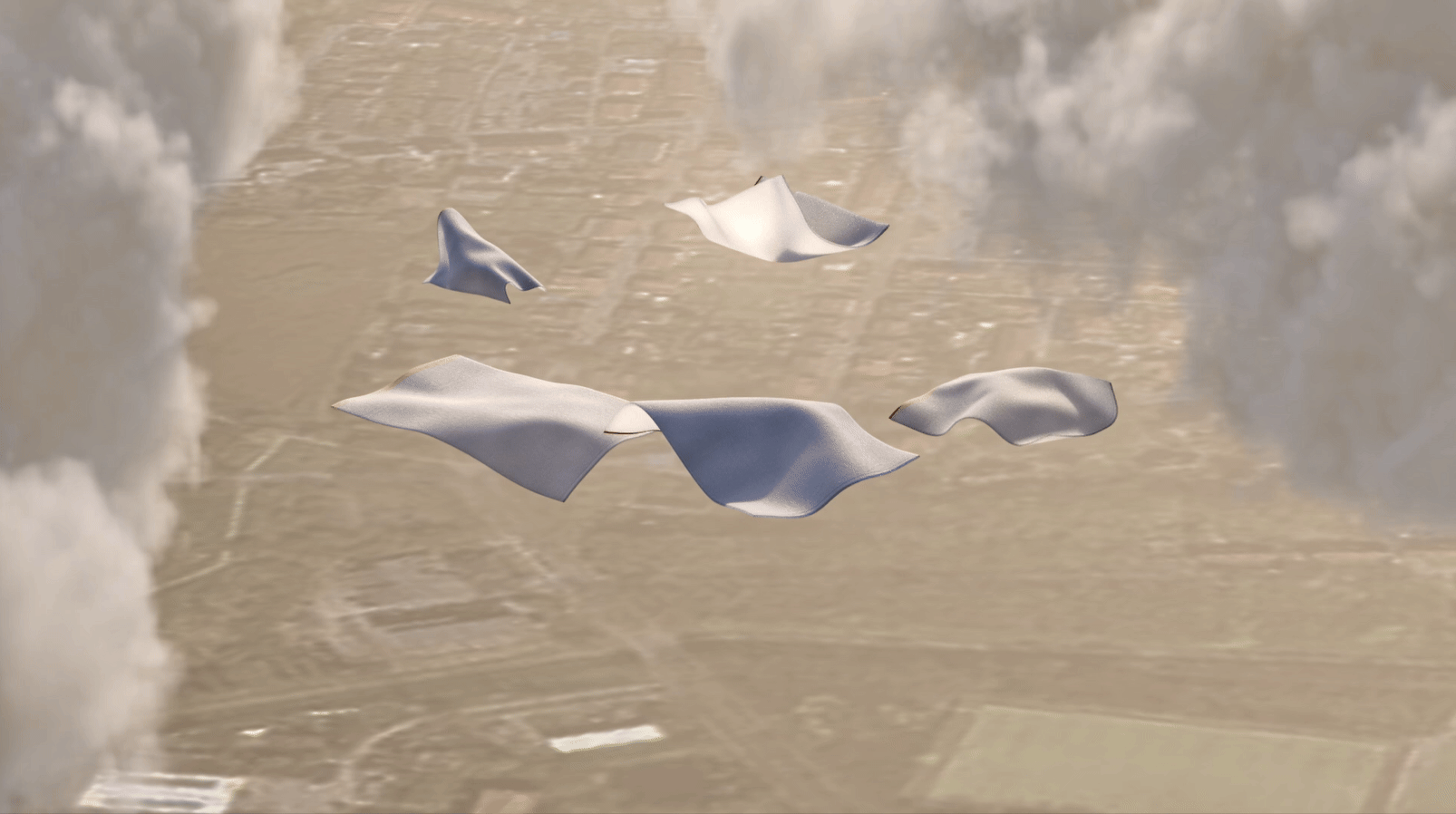

  6. Caustics - currently rendering caustics in animations works fine in many cases, but sometimes flickering may appear depending on scene scale, complexity, camera movement speed, etc. In such cases, it is best to check the information provided in this article: How to render caustic with the new caustic solver? ( Max | C4D )
