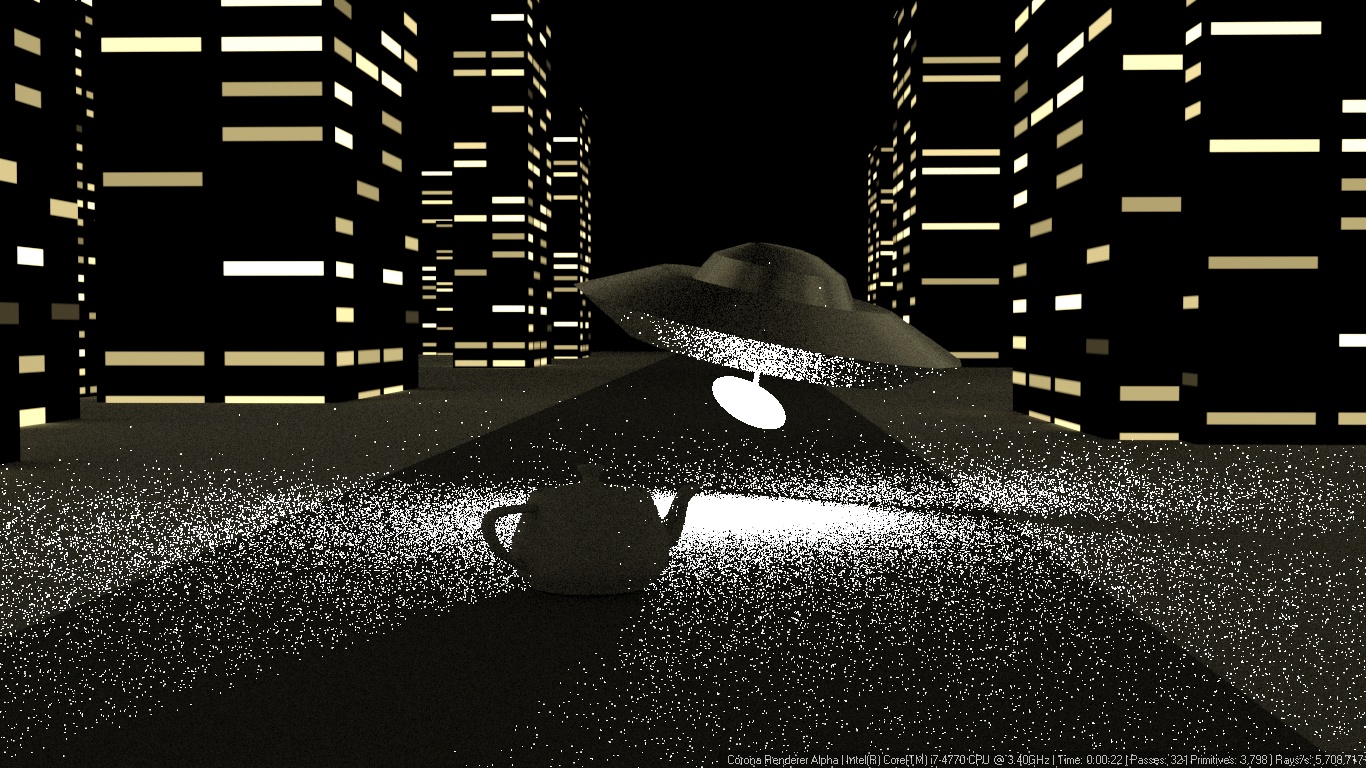

2. Key light and faint light sources
City lights - self-illumination
UFO light - Corona Light material
32 passes
Rendering time: 28s
Rays/s: 6,195,195
Correct setup.
B
City lights - Corona Light material
32 passes
Rendering time: 56s
Rays/s: 3,206,471
Incorrect setup. Samples required by the UFO light are "stolen" by light material assigned to the buildings. Rendering is slower and its quality is worse.
C
UFO light - self-illumination
32 passes
Rendering time: 23s
Rays/s: 5,699,721
MSI=20 (default setting)
D
32 passes
Rendering time: 23s
Rays/s: 5,699,721
MSI=0 (unbiased mode)
