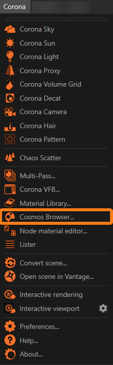

How to find the Corona Material Library in C4D?
Using Corona 12 and newer:
  • Launch the Cosmos Browser using the Corona menu > Cosmos Browser...
    or
  • You can find it in the Corona menu > Material Library.
C4D_HowTo_CoronaMaterialLibrary_01_UI_Comos.png C4D_HowTo_CoronaMaterialLibrary00_UI_Comos.jpg

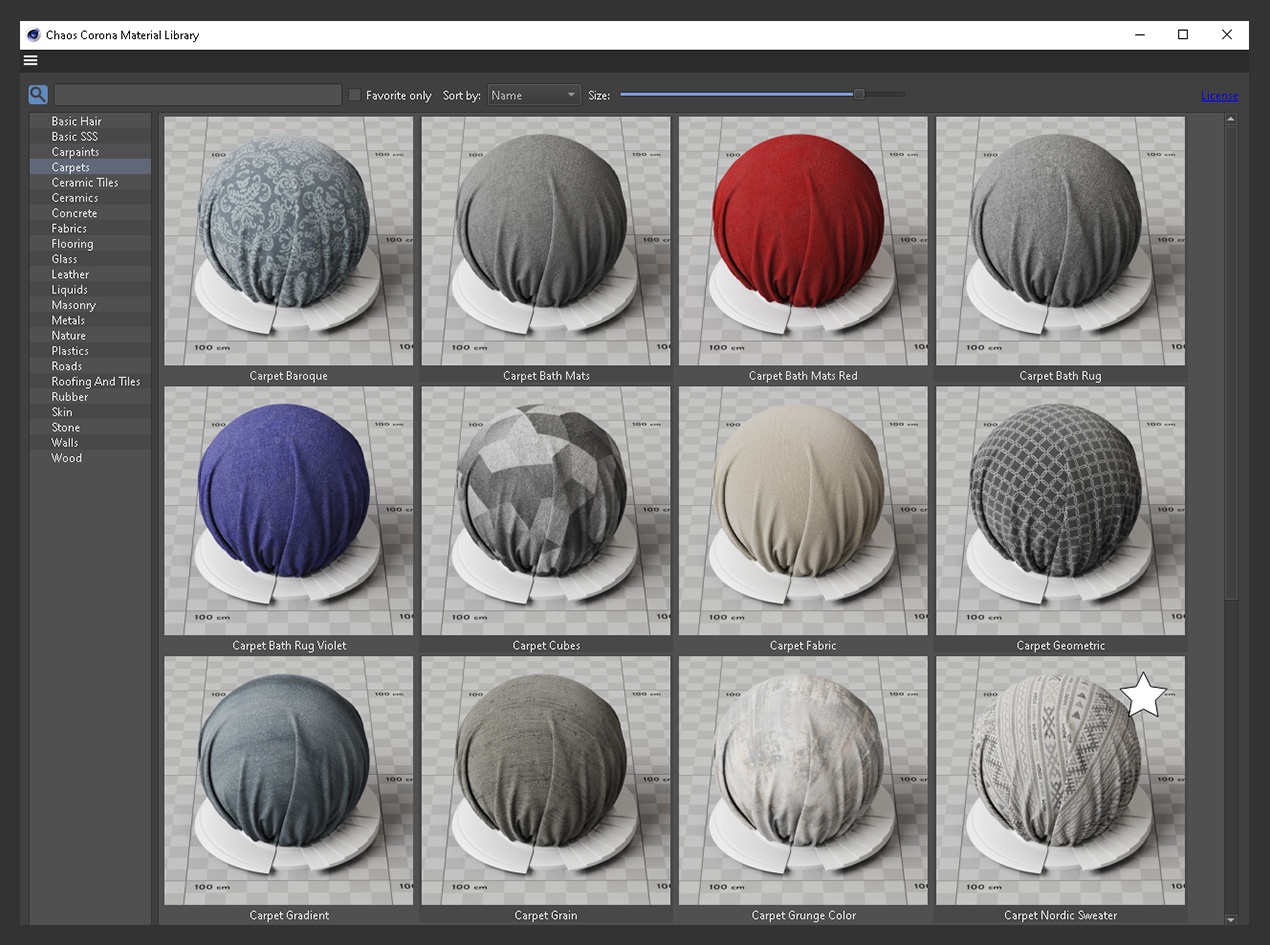

What are its features?
The most common uses/features are:
  • View materials by category.
  • Set and view only favorites.
  • Drag and drop materials directly into the objects at the viewport.
  • Double-click to add a material to the Material editor so you can customize it or assign it to an object.
  • Select all objects in the scene that use a certain material.
  • Many of the materials don’t need UV mapping, as they use the Corona Triplanar shader.

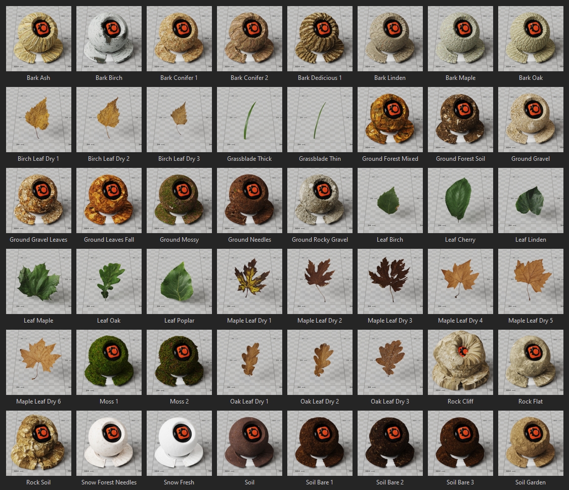

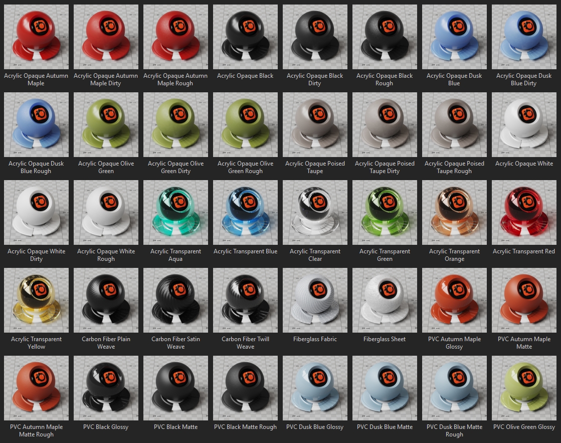

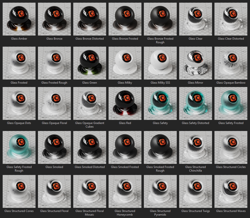

Material Library updates in Corona 8
  • 33 new materials in Nature category
  • 9 new materials in Plastic category
  • 13 new materials in Glass category
