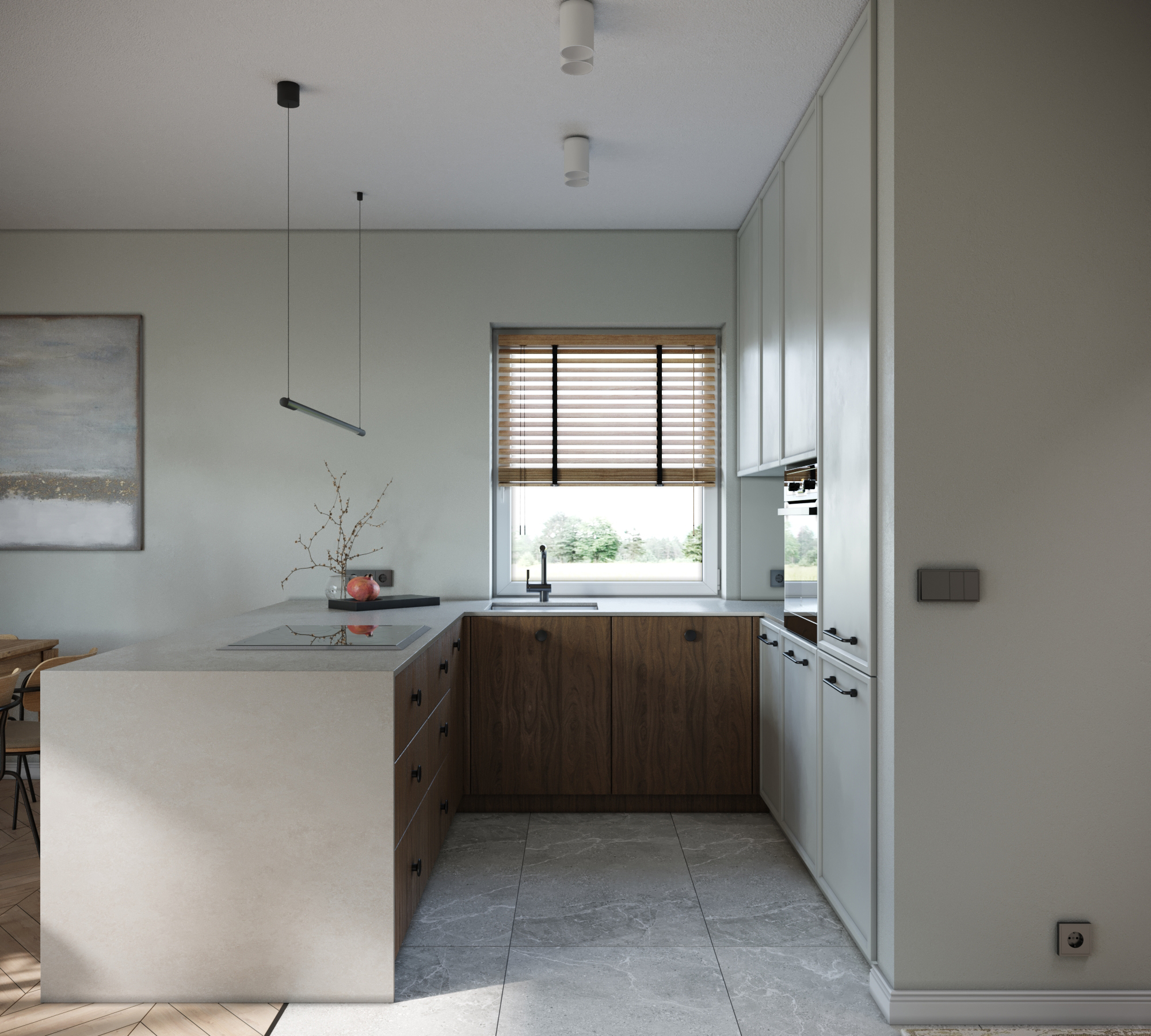

1. The beauty pass:

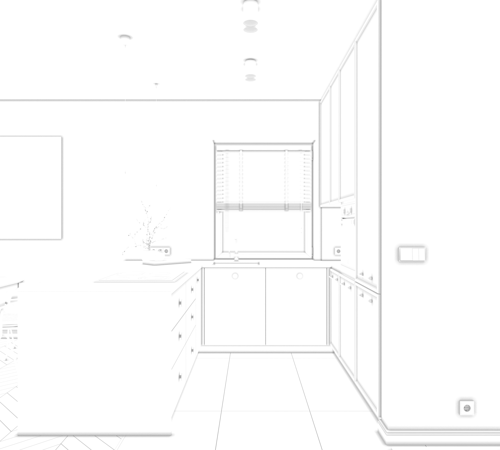

2. Ambient occlusion map (CoronaAO) used in the CTexmap render element:
Result:

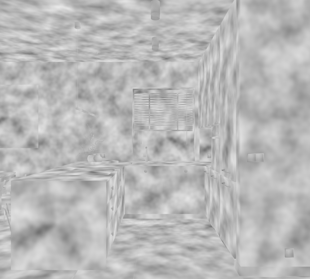

5. A procedural noise texture used in the CTexmap render element:
