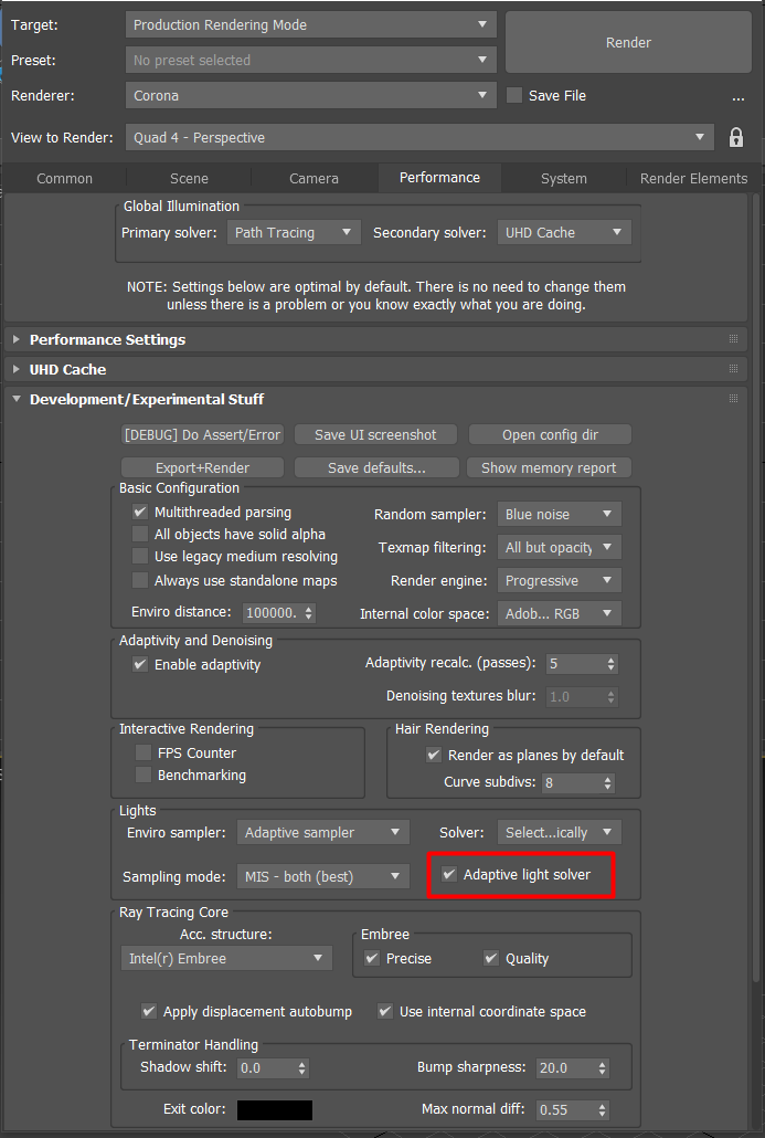

The Adaptive light solver option (formerly known as New light solver) found under Render Setup > Performance > Development/Experimental Stuff > Lights toggles the new improved method of rendering lights and starting from Corona 4 this option is ON by default.

If the Adaptive light solver checkbox is enabled by default and can be found under Render Setup > Performance > Development/Experimental Stuff > Lights.
Check this article for How to enable the "Development / Experimental stuff" rollout in Corona for 3ds Max?

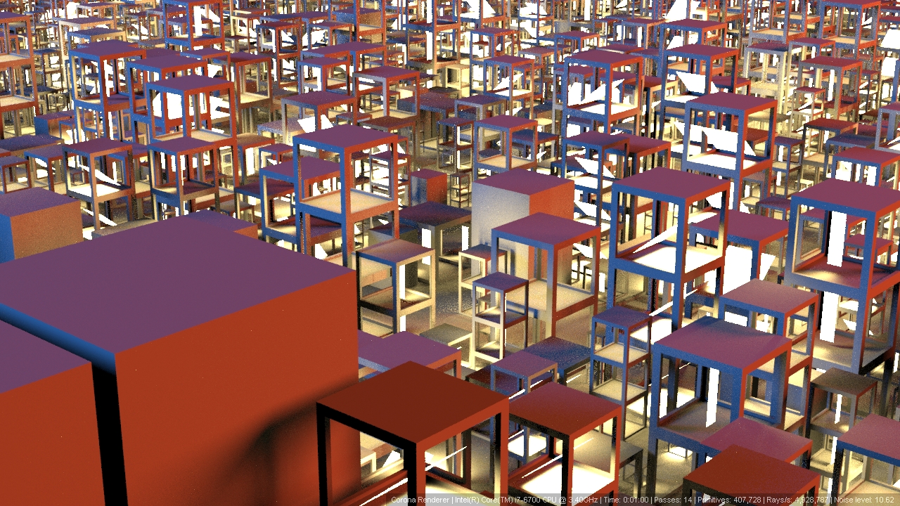

1. Abstract scene with multiple light sources occluded by geometry
Render time 1 minute.
Interactive comparison

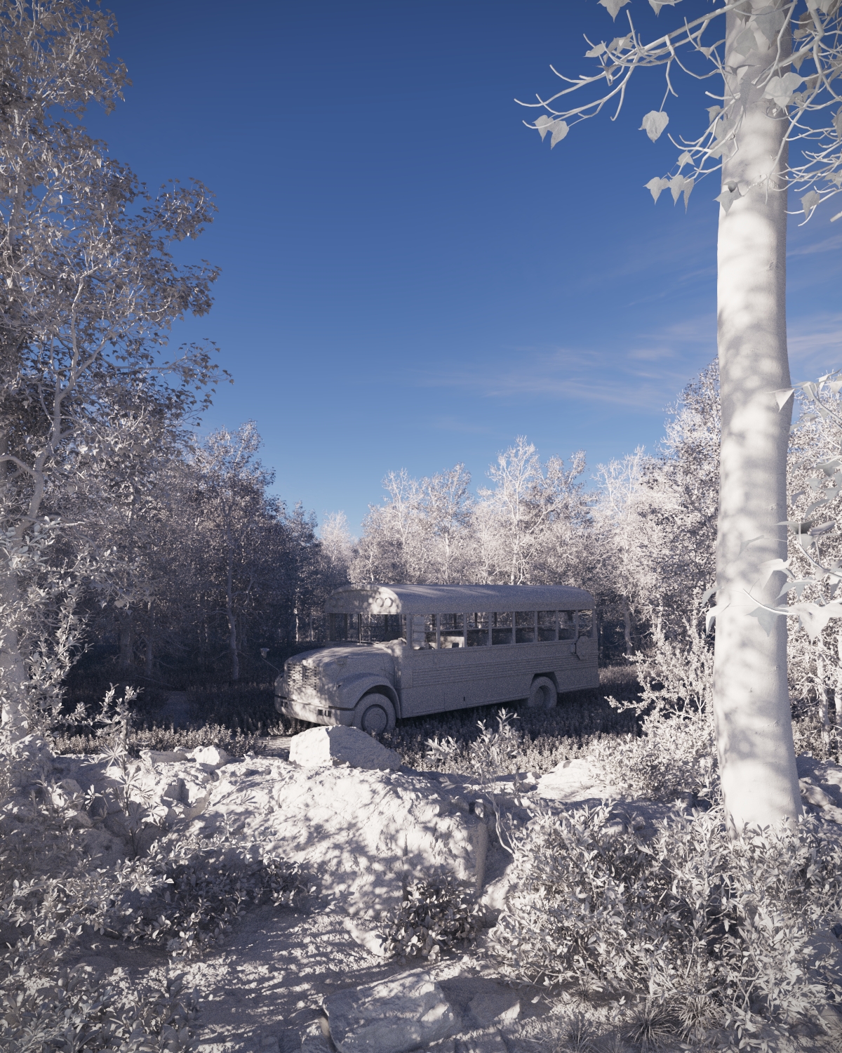

2. Exterior scene with clay material applied to show differences in noise level.
Render time 12 minutes.

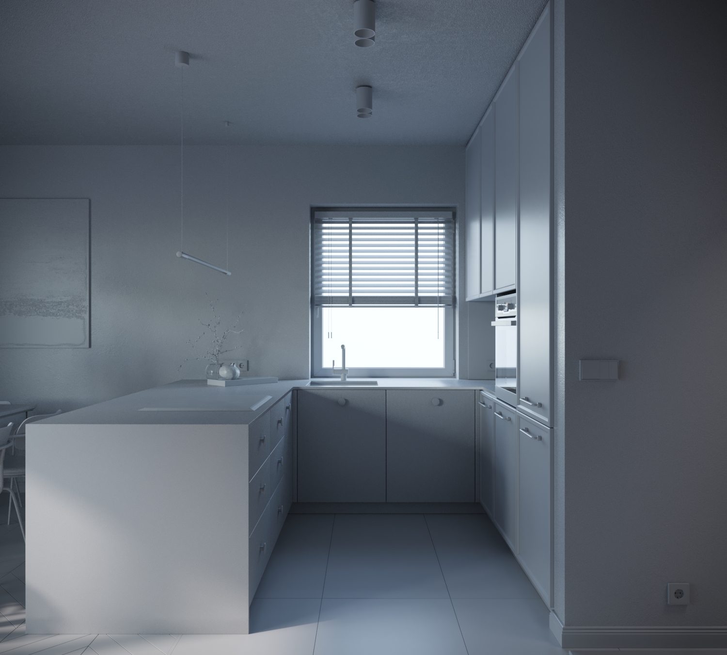

3. Interior scene with clay material applied to show differences in noise level.
Render time 20 minutes.
