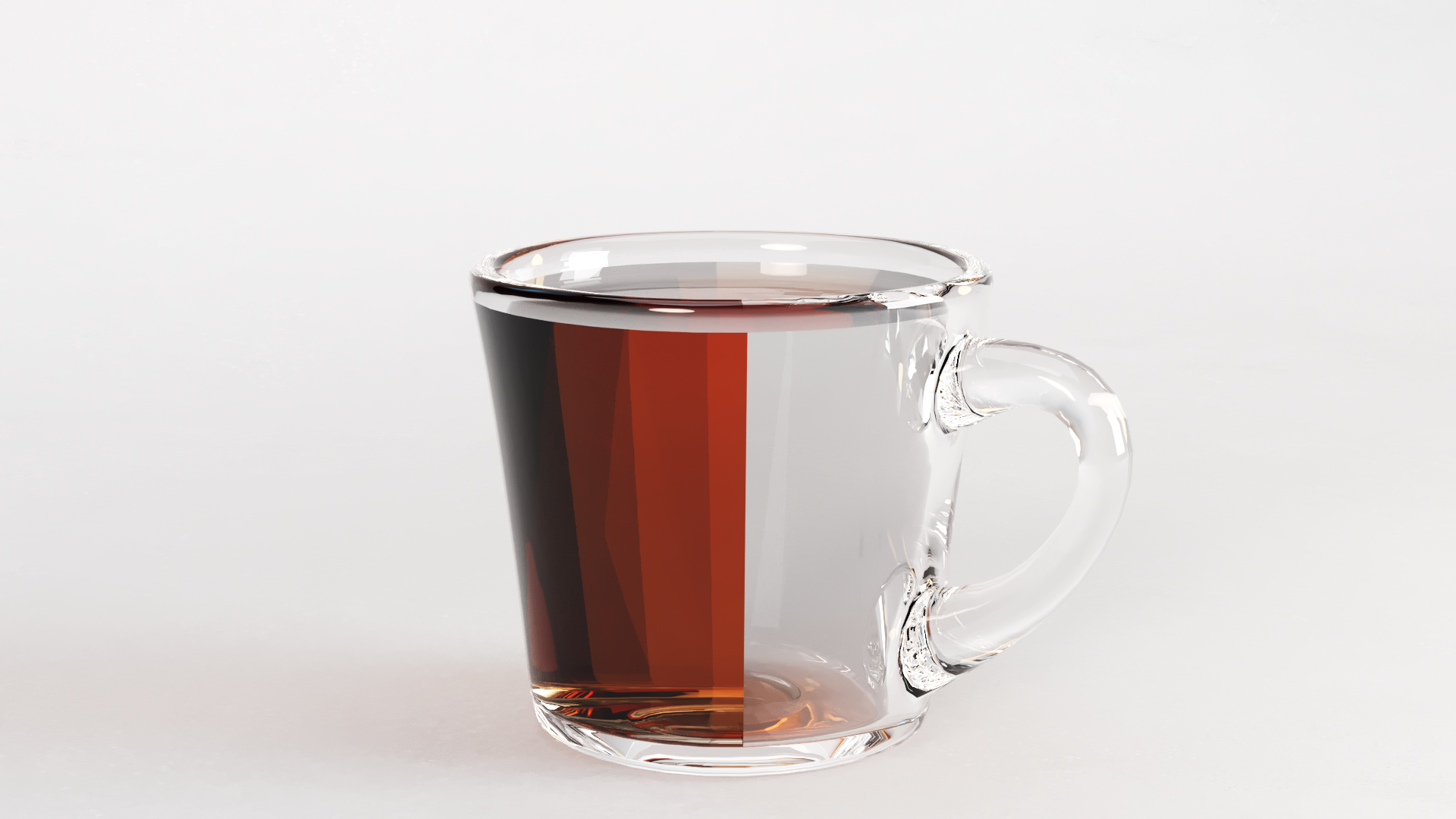

a) Liquid mesh perfectly overlaps with the faces of the inside of the container mesh - this produces wrong results and artifacts are visible (faceting, triangles).

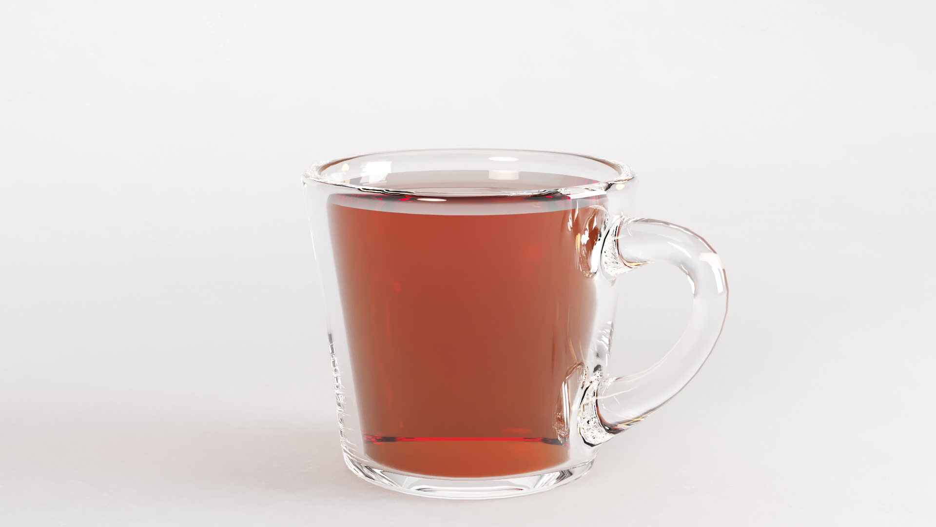

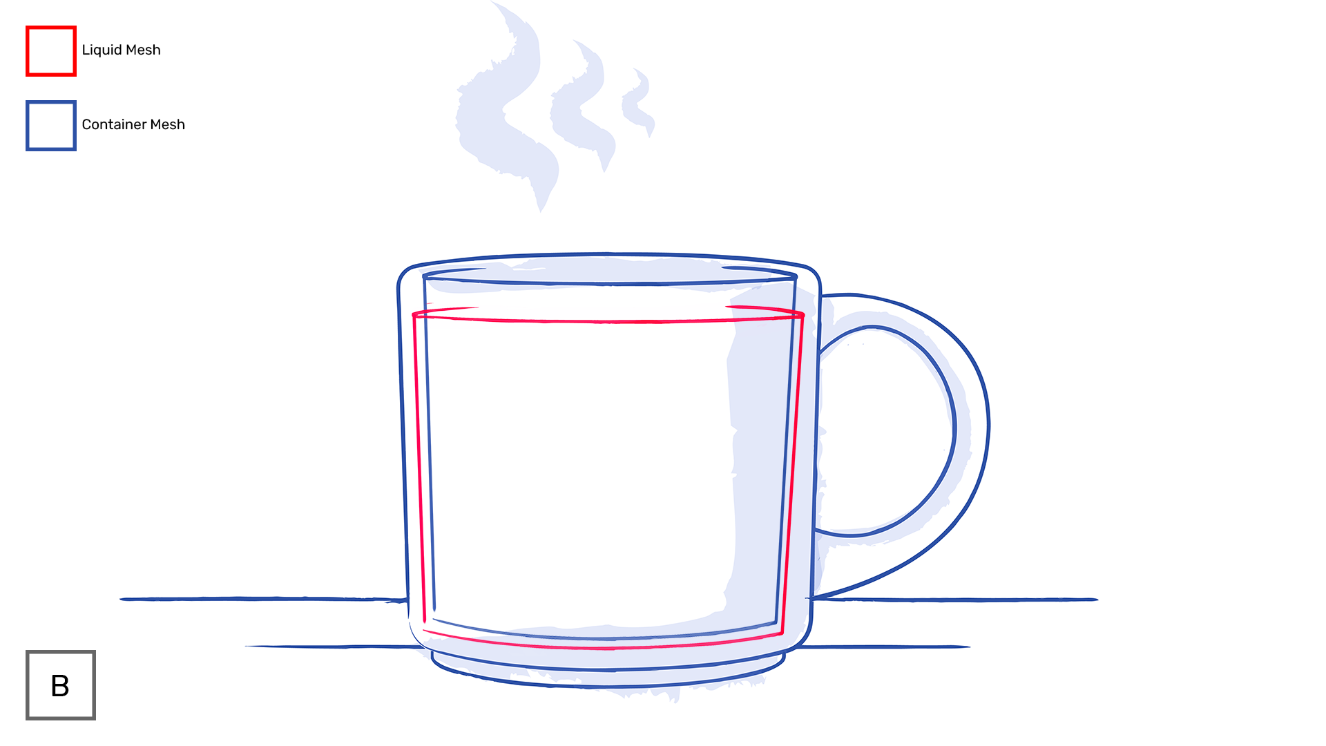

b) Liquid mesh is slightly bigger than the inside of container mesh - this is the correct method.

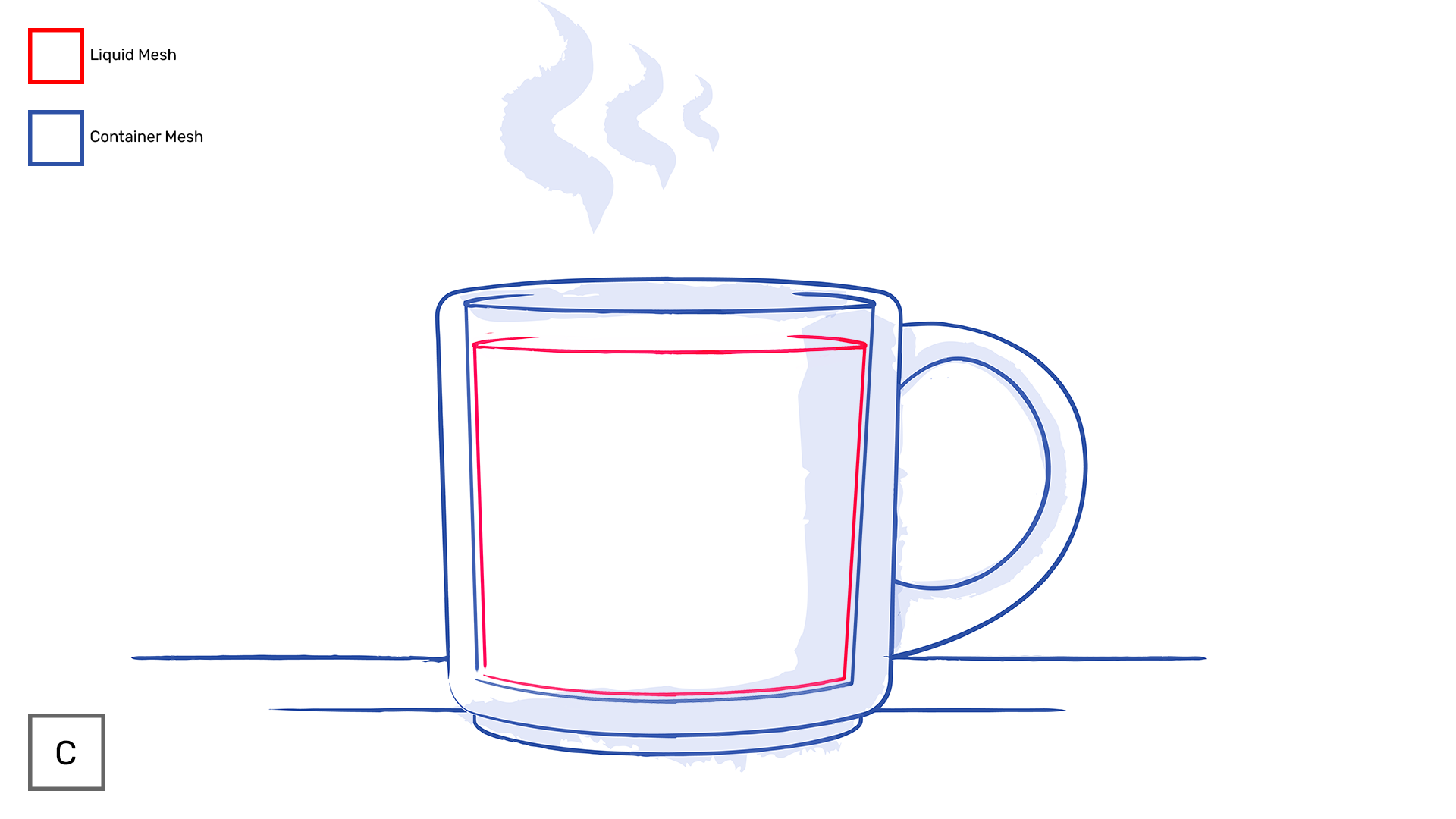

c) Liquid mesh is slightly smaller than the inside of the container - this produces wrong results.

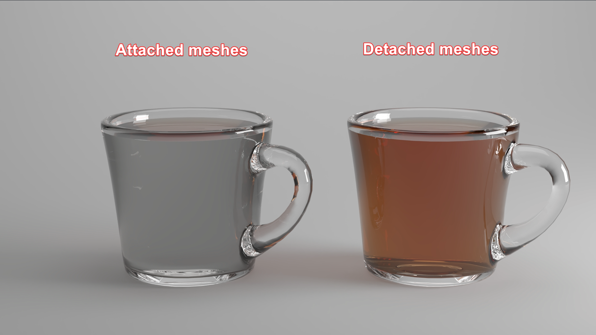

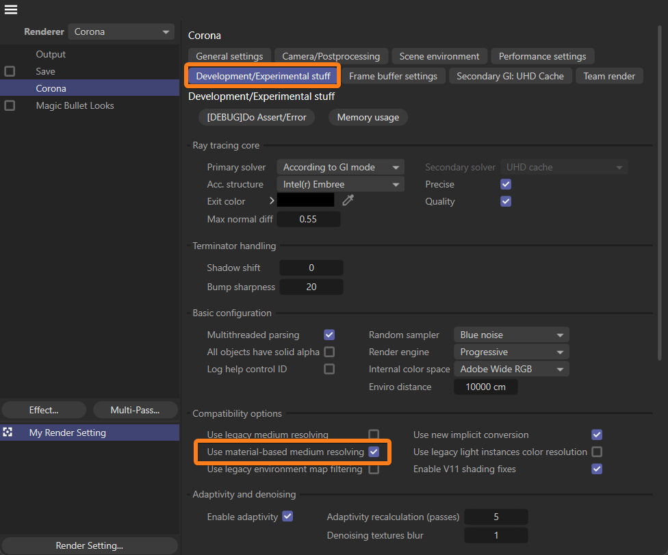

Material-Based Medium Resolving

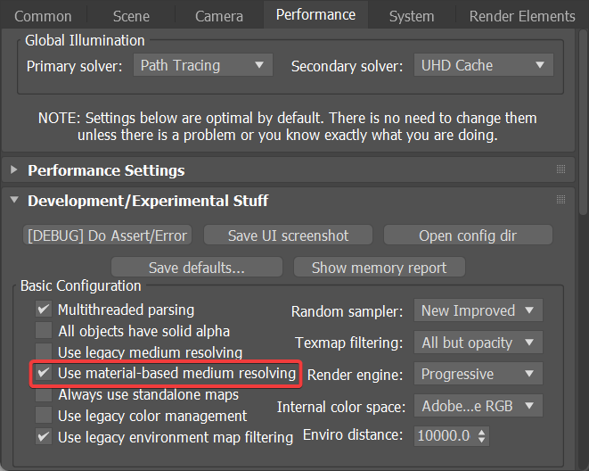

Corona 12 introduced the "Use material-based medium resolving" option, which assures that materials like glass and liquid are rendered correctly, regardless if they are attached or detached from each other.
Note: This option is enabled by default and in most cases there is no need to change it!
| In 3ds Max, this is available in the Performance tab under Development/Experimental Stuff |
In Cinema 4D, this is available in the |
In Corona 11 and below, two intersecting objects with different materials would render differently depending if the objects were attached or not:
Example - Corona 11 Hotfix 2
Starting from Corona 12, when the Use material-based medium resolving option is enabled, this allows to correctly identify the difference between two or more materials assigned to overlapping volumes, regardless if they are attached or detached:
Example - Corona 12 (with Use material-based medium resolving option enabled)
