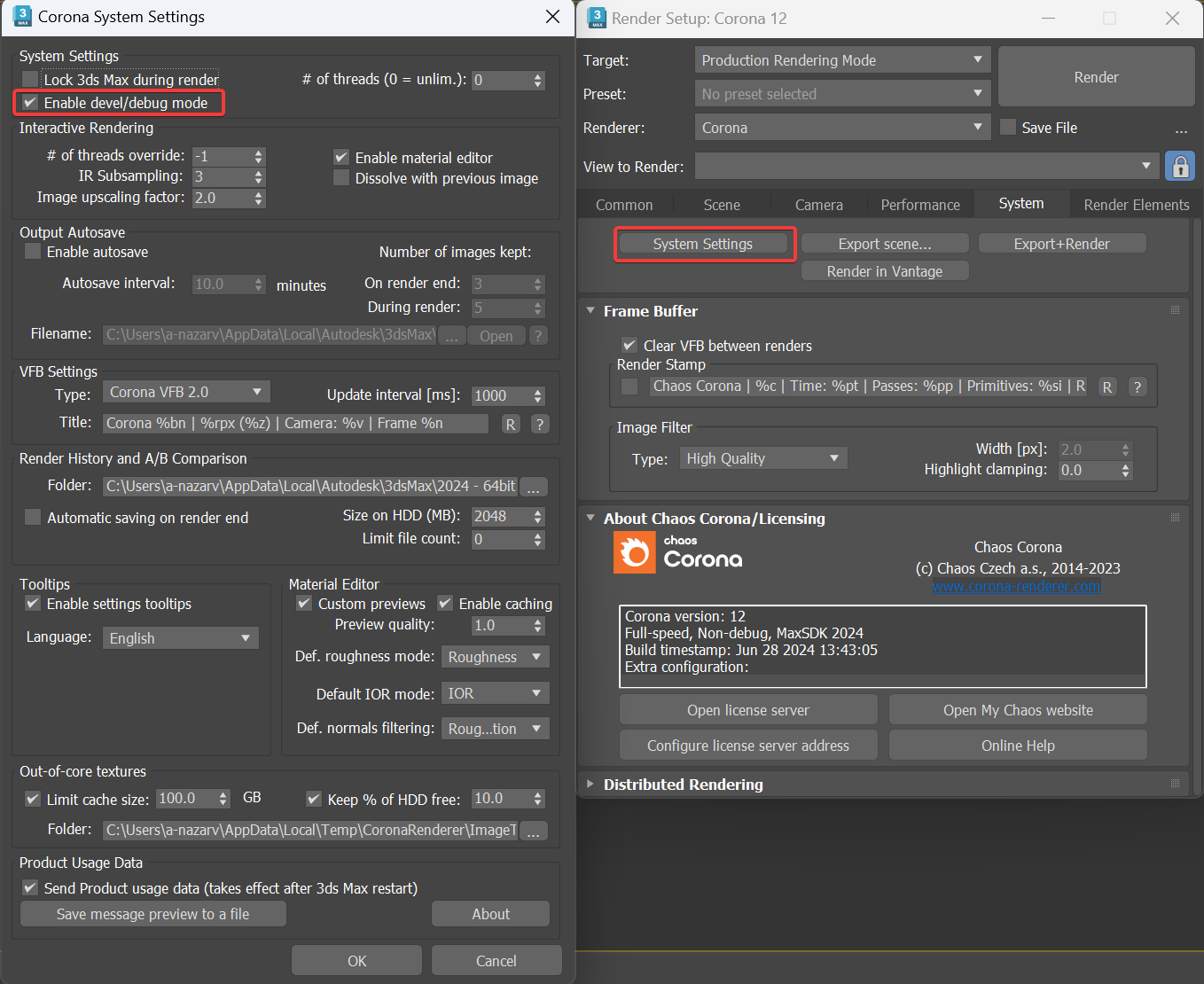

To enable the "Development / Experimental stuff" rollout in Corona 1.5 or newer:
  1. Go to Render Setup > System
  2. Click the "System settings" button
  3. In the "System settings" window enable the checkbox "Enable devel/debug mode"
  4. Go to Render Setup > Performance
  5. You can now find the "Development / Experimental stuff" at the bottom of the Performance tab
Note: options in the "System settings" window are system-wide, which means that they are valid for any newly created or opened scenes, even if they were previously saved with different settings!
