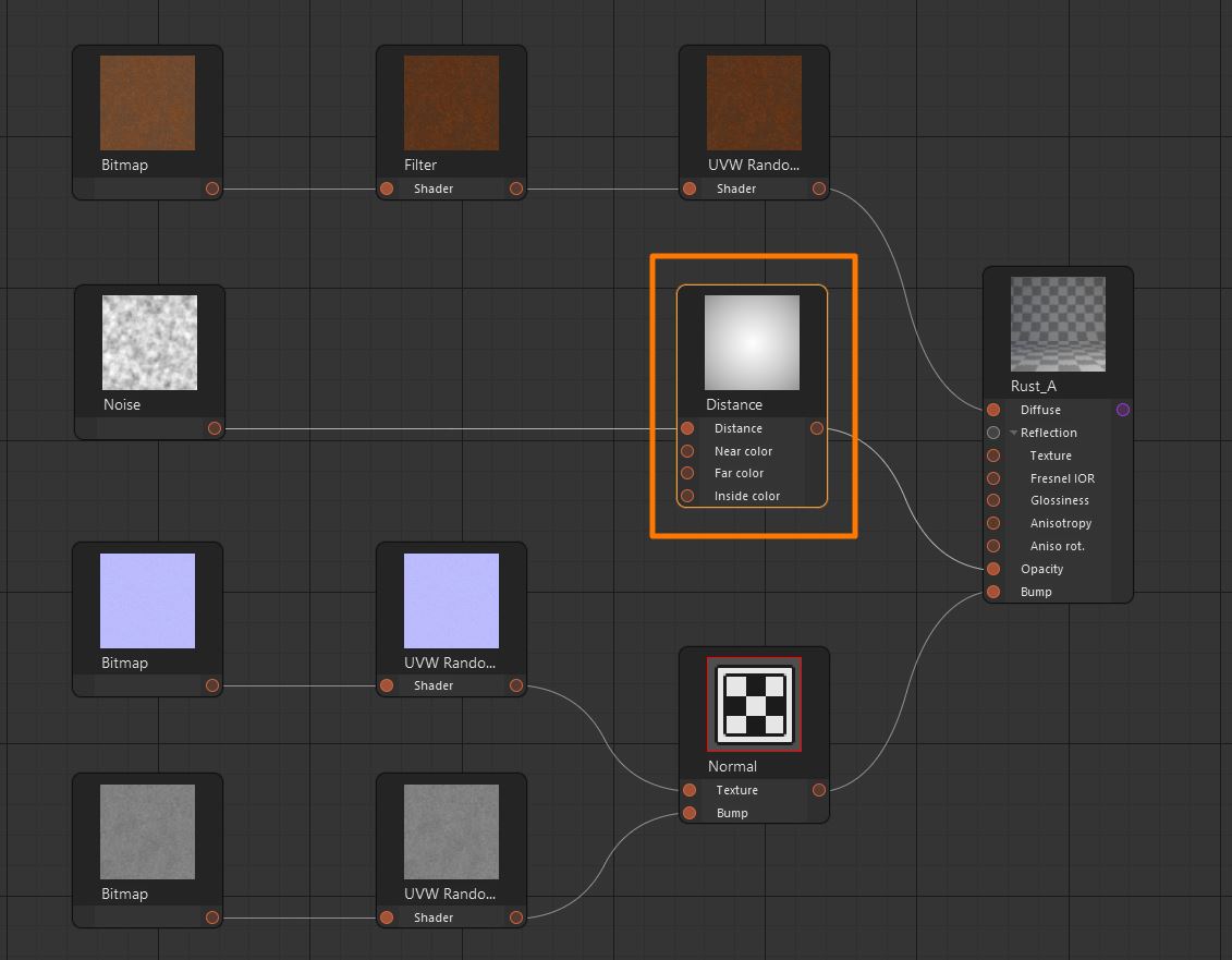

Wear and tear on objects which are close to each other:

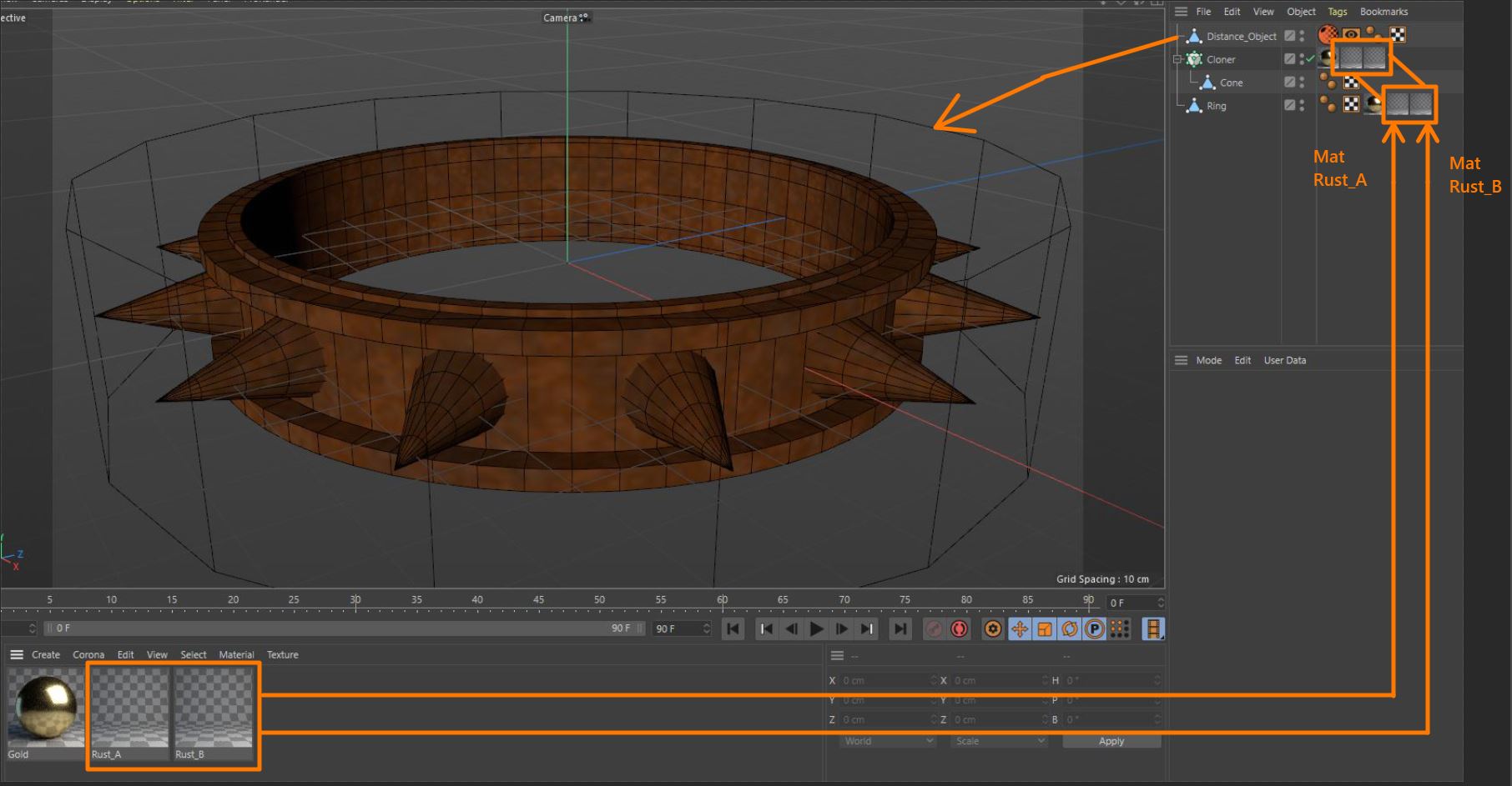

Material Setup:
A Noise map is used to vary the distance scale, producing the "rust" effect. In this case, the Corona Distance Shader is feeding the Opacity channel.
The material tag is stacked over the base material.
The material Rust_A measures the distance from the sides of the cylinder that acts as the Distance Object through the Corona Distance Shader. The material Rust_B measures the distance from the floor and feeds that info to the Corona Distance Shader.

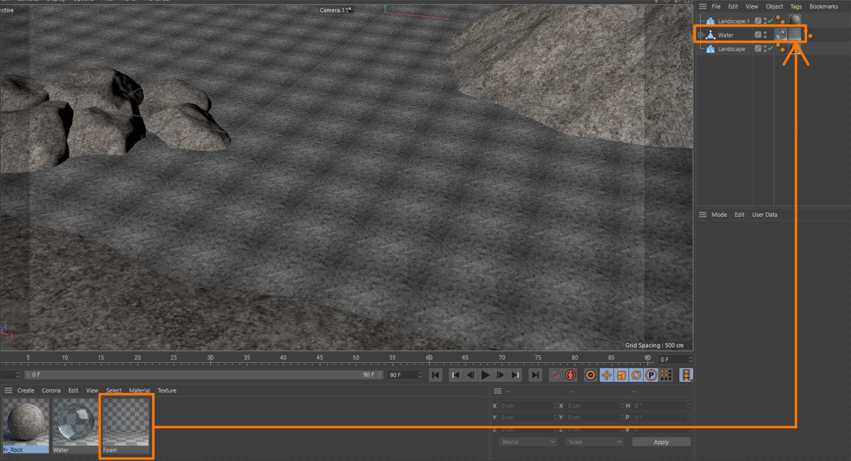

Foam close to the shore:
Material Setup:
A Noise shader is used to vary the distance scale, producing the "variation" at the edge of the foam. In this case, the Corona Distance Shader is feeding the Opacity channel.
The material tag is stacked over the base material. The foam material measures the distance from the landscape objects that act as the Distance Objects and feeds that info to the Corona Distance Shader.

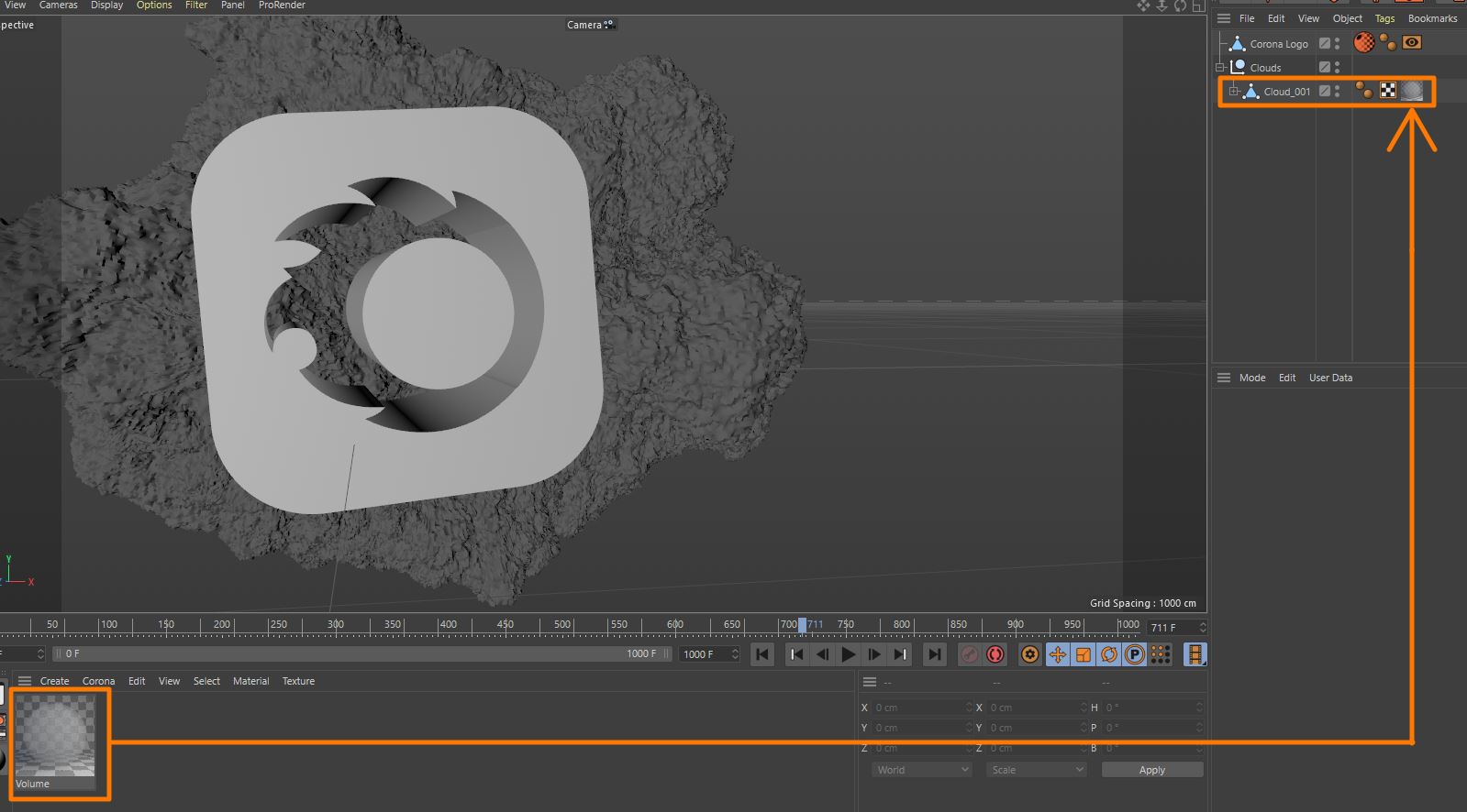

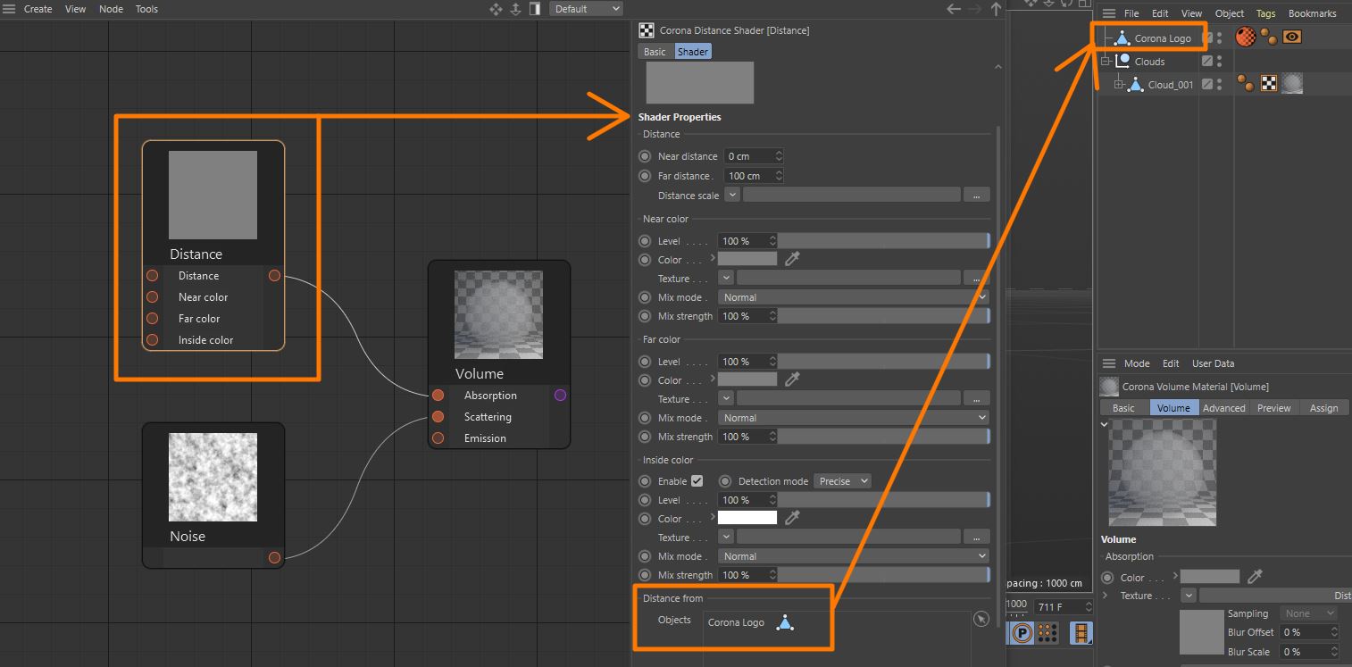

Cutting-out objects with Corona Volume material applied:
Material Setup:
In this case, it's a "boolean-like" example; there is an invisible object (Corona Renderer's logo) cutting through the volume. The Corona Distance Shader is used in the Absorption slot of the Corona Volume material to define the areas that should be transparent and those that should be solid.
The material tag is applied to the cloud object, and then the Corona Distance shader measures the distance between the Corona Renderer logo and the cloud, and it uses that info to cut out the cloud object.

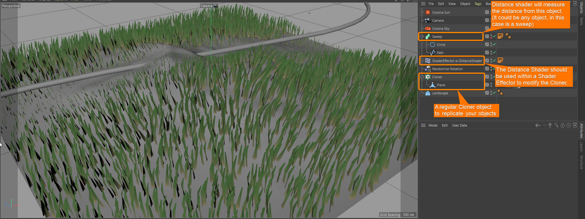

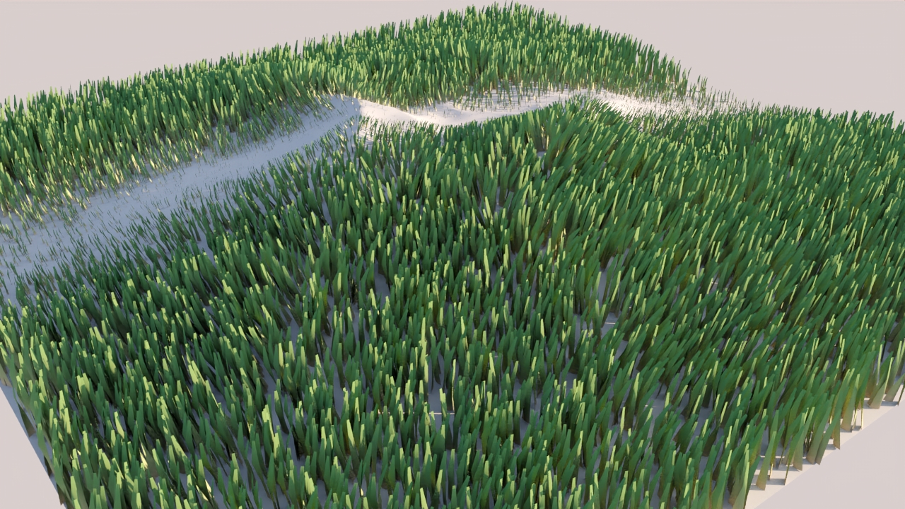

Using the Distance shader to affect Cloner objects.
Objects and setup:

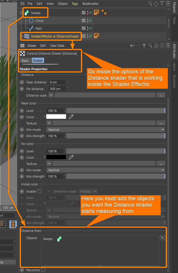

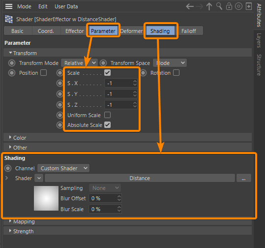

You can use the Corona Distance Shader to affect the result of a cloner.
The setup of the Corona Distance Shader is pretty straightforward.
Use a Shader Effector to affect the Cloner, then add the Corona Distance Shader using the
Custom Shader channel and modify the effector parameters.
Finally, add the objects to the Corona Distance Shader.
