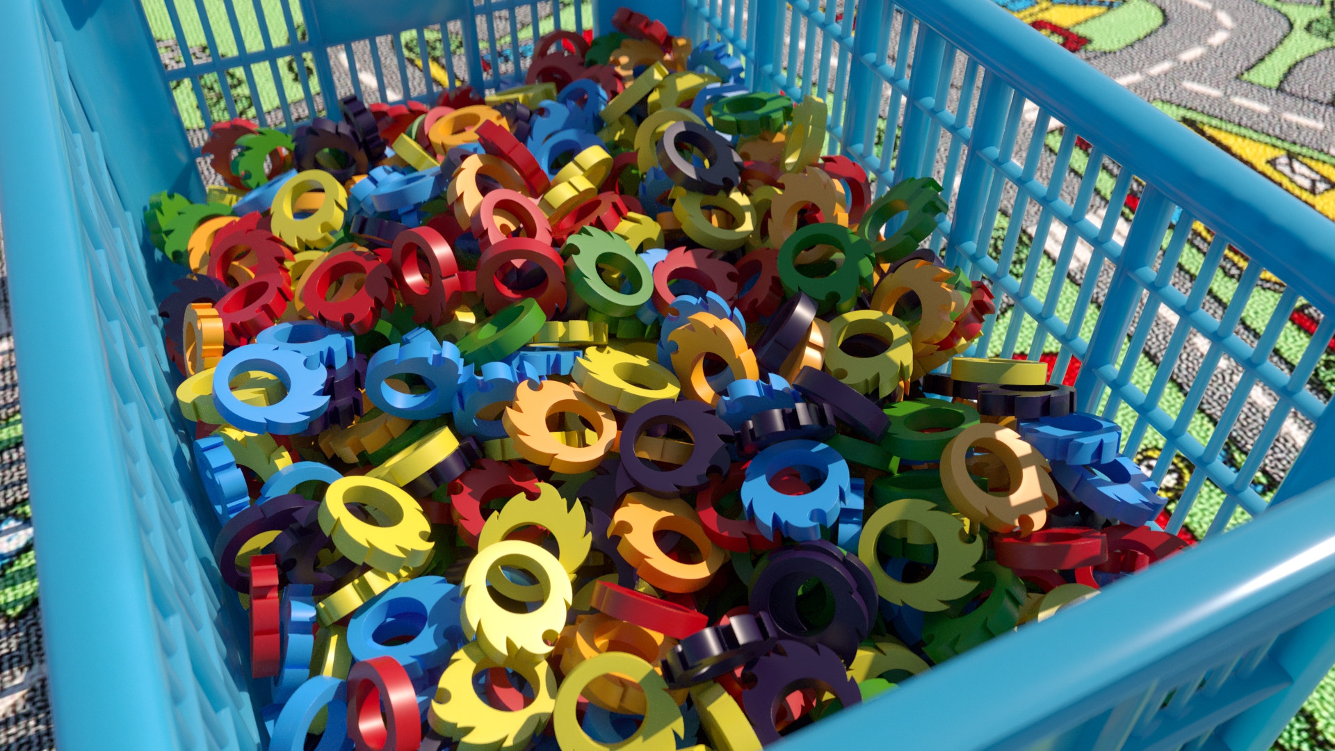

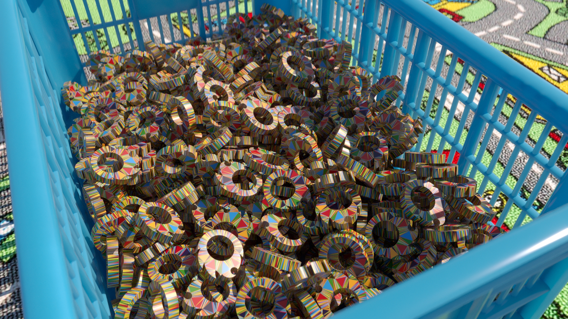

  • Primitives - each of the items will be distributed on each mesh primitive (triangle):

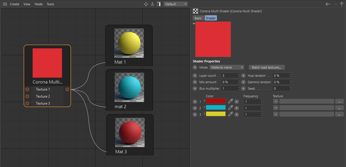

  • Material name - the items will be applied to different materials the Multi shader is assigned to:
  • Object - each of the items will be distributed on each of the instances (objects):

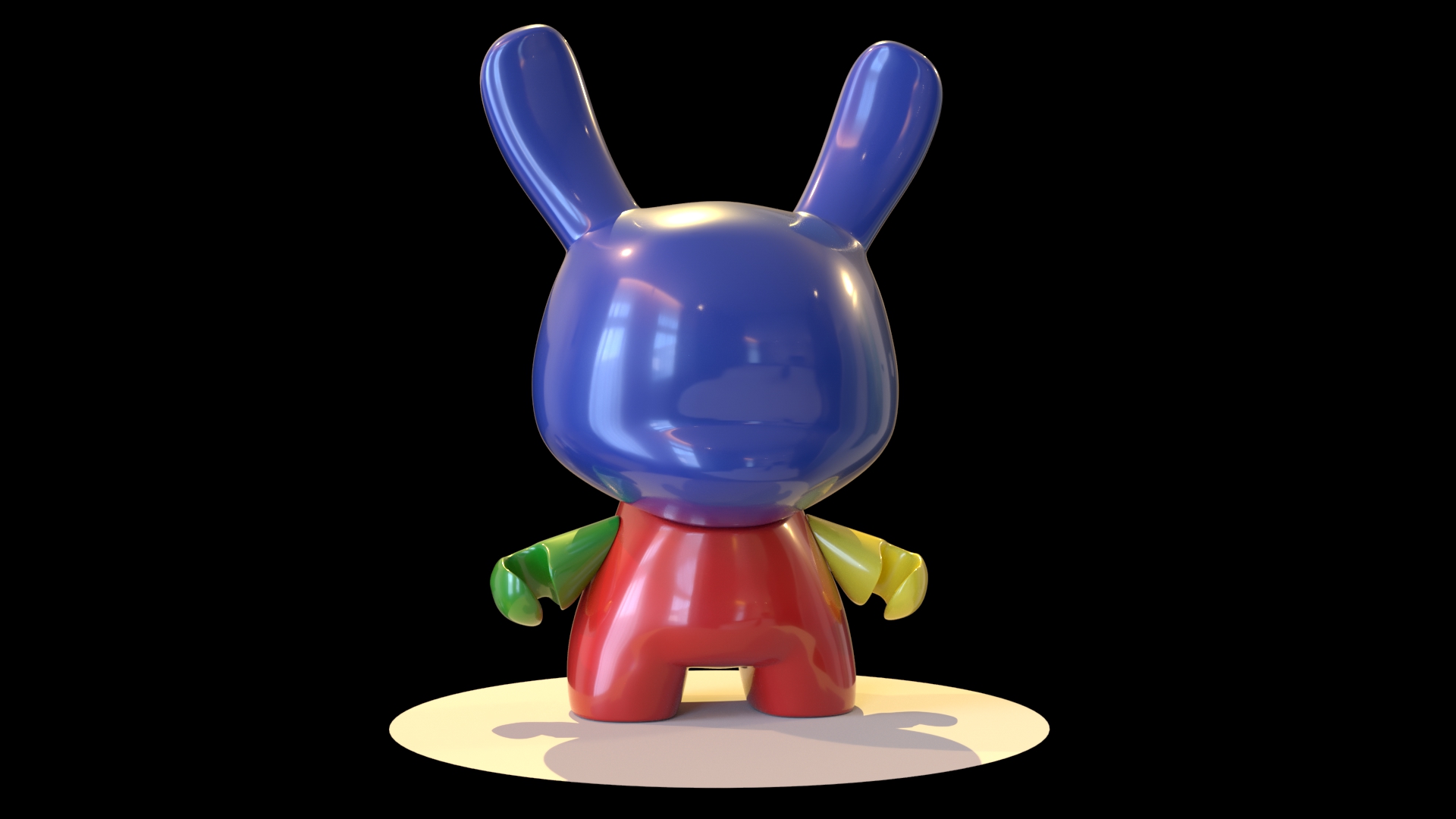

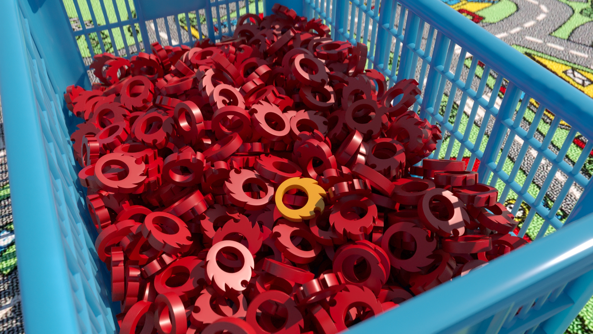

  • Material tag index - each of the items will be distributed based on the object’s material ID. In this case, the central logo uses a material with a different material ID than the rest.

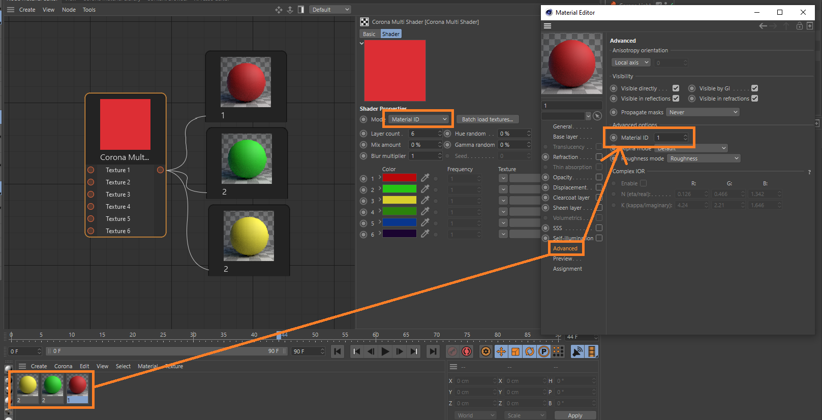

  • Material ID - each of the items will be distributed based on the material’s Buffer ID. This can be set via the advanced tab in each material.

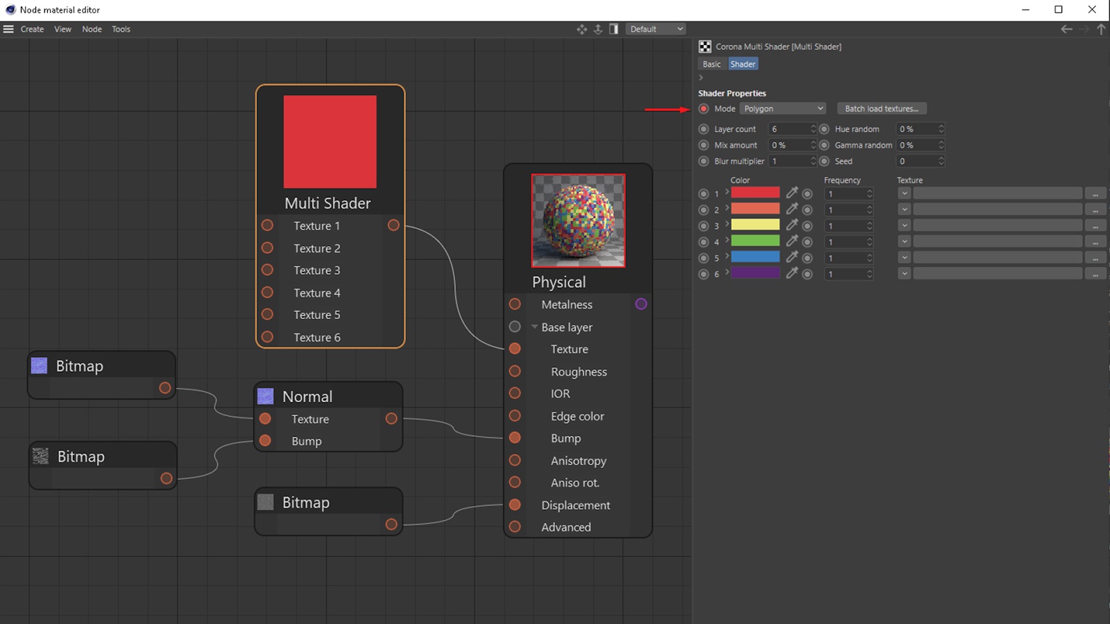

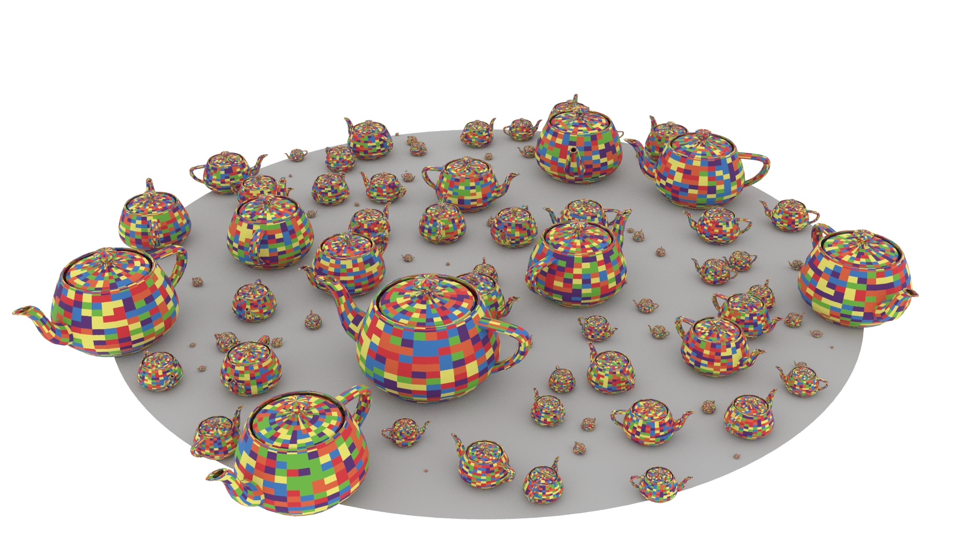

  • Polygon - items will be distributed randomly on all mesh faces:

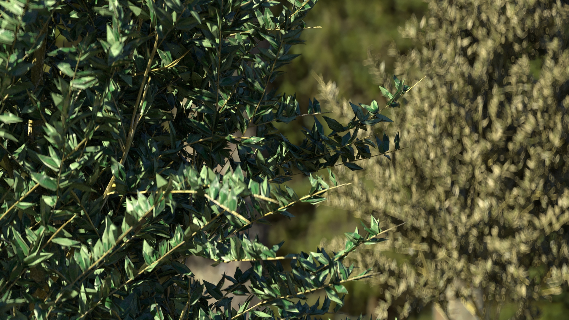

Color variation of tree leaves
Corona Multi shader was used to produce a subtle variation of green between each tree:

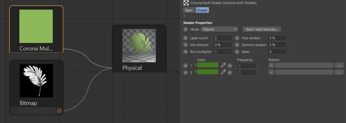

Identical colors can be used as both items in the Multi shader. The variation is achieved by increasing the random hue and gamma values:

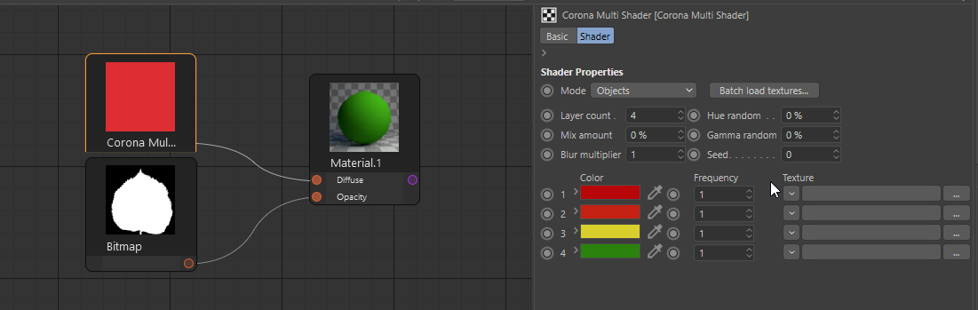

More distinct variation between the colors can be used to achieve an "autumn" look:

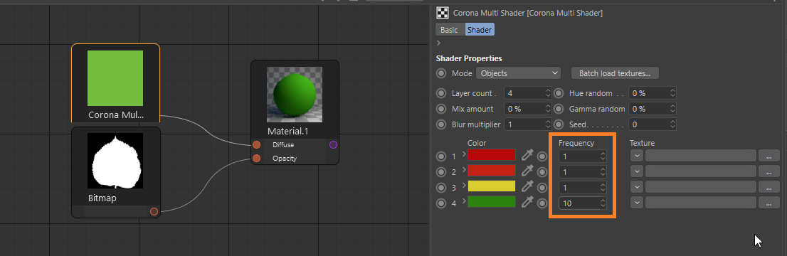

Material setup:
Additionally, the frequency of each color version can be controlled using the "Frequency" value:
Result of the above material setup. The red trees are much more frequent than other variants:

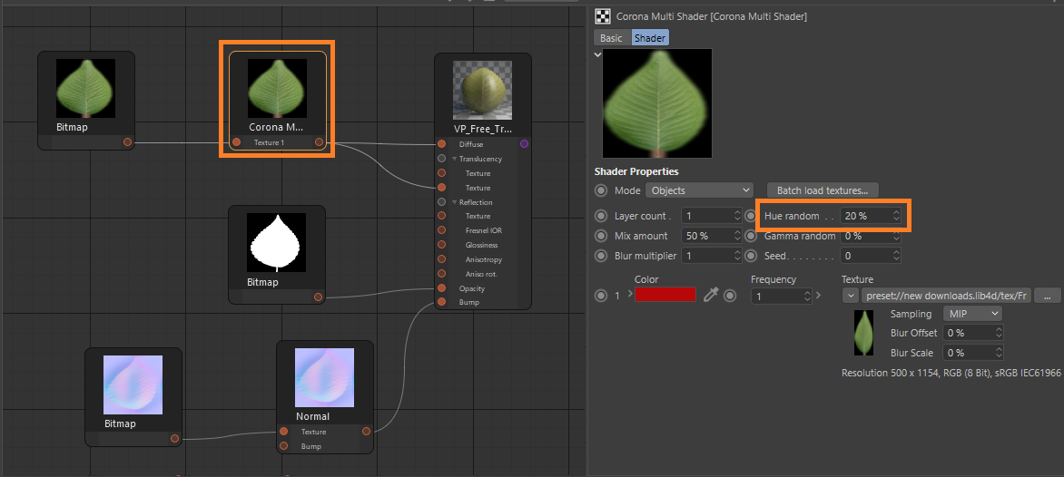

A single texture for the leaves with an increased value in the "Hue Random" settings will distribute a slightly different color across each tree:
Result of the above material setup:

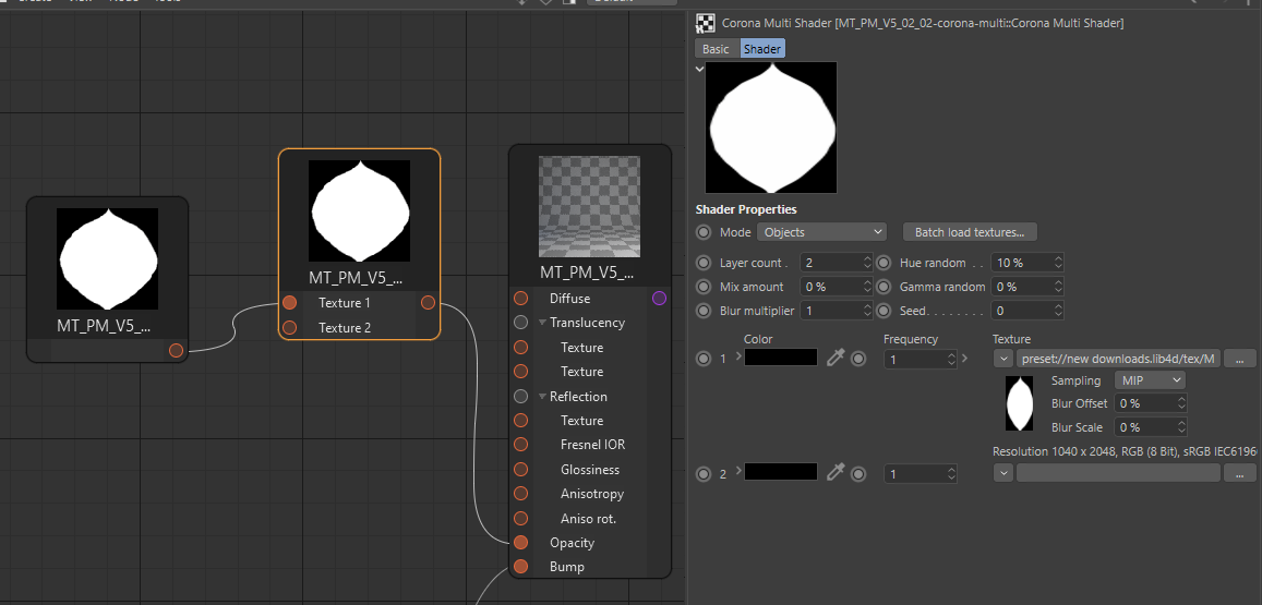

A "Winter" version of the scene can also be achieved by randomizing the opacity of tree leaves. This way, some of the trees will appear leaf-less:
Material setup:

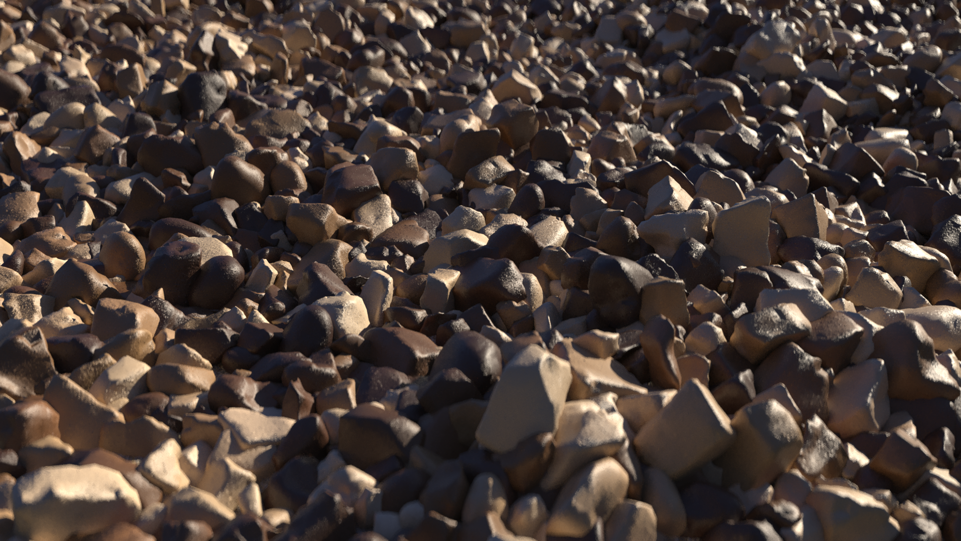

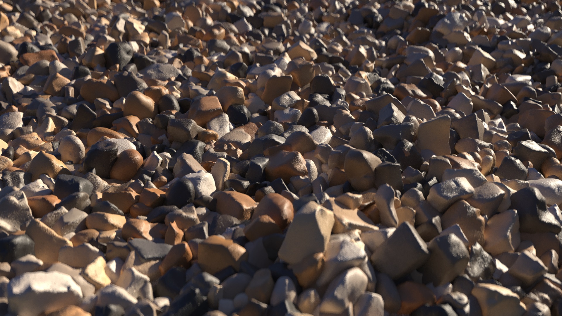

Texture variation of pebbles
Material setup:

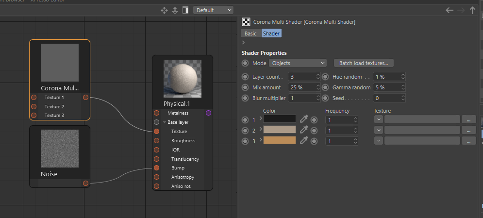

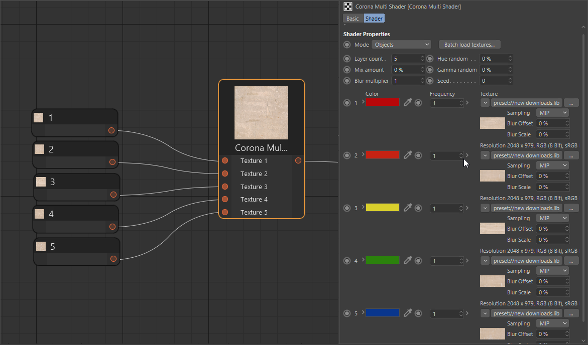

Different textures on floor tiles
Material setup - "Batch load textures..." option can be used to quickly load multiple textures as the Multi shader items:
Polygon distribution mode in Corona Multi shader can be used to create variations of texture or color in each polygon of any 3D model:
(only available in Corona 8 and newer)
Material setup:

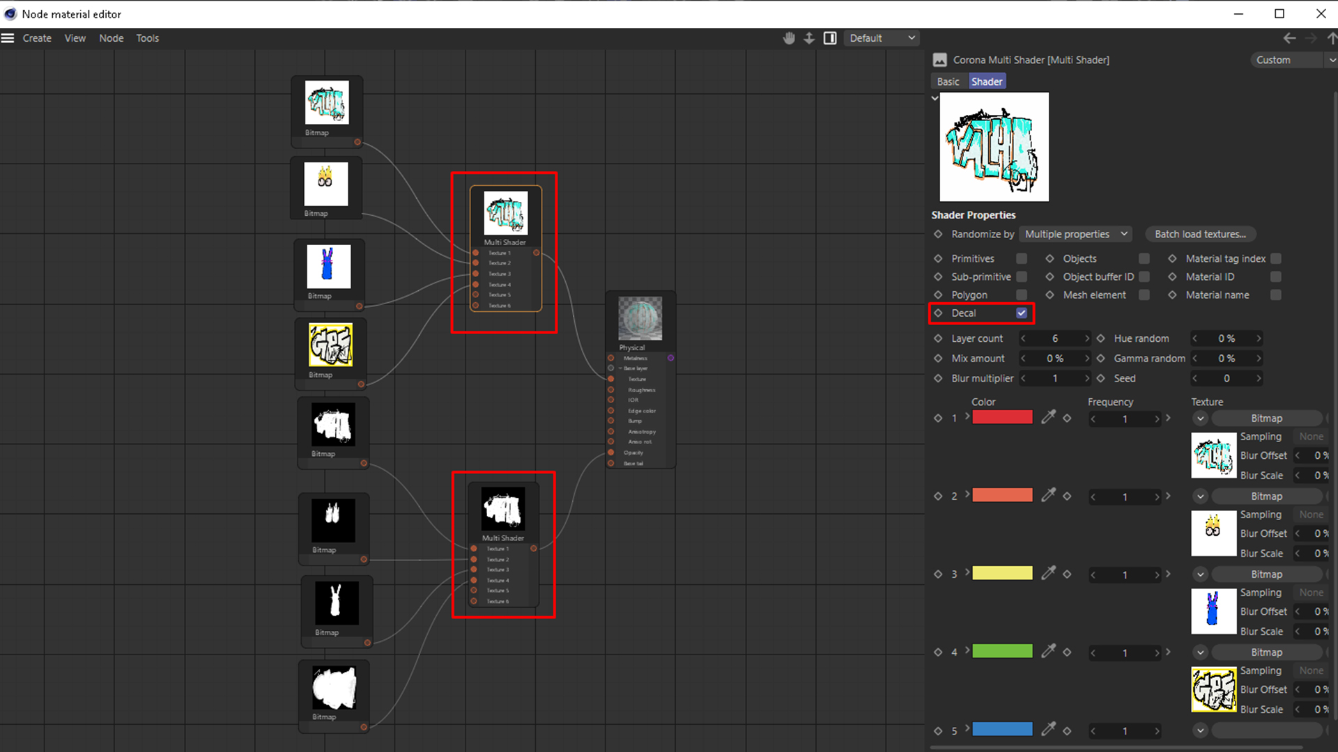

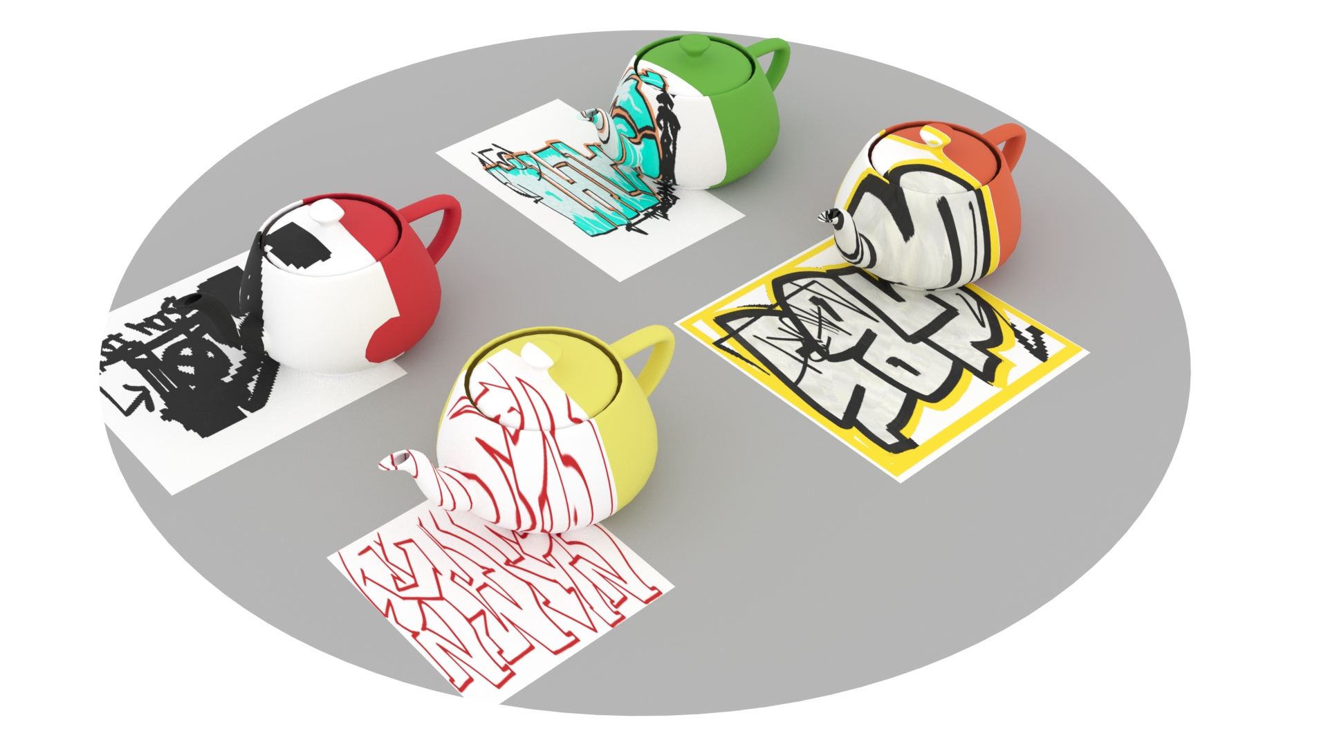

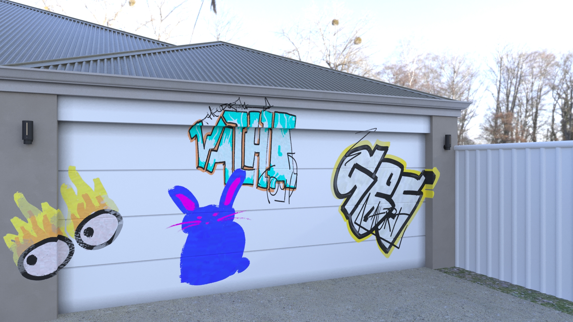

Using Corona Multi shader with Corona Decal to randomize textures per Decal object
We can apply a single material to multiple Corona Decal objects and easily randomize the decal textures using the Multi shader's "Decal" randomization mode:
Material setup:

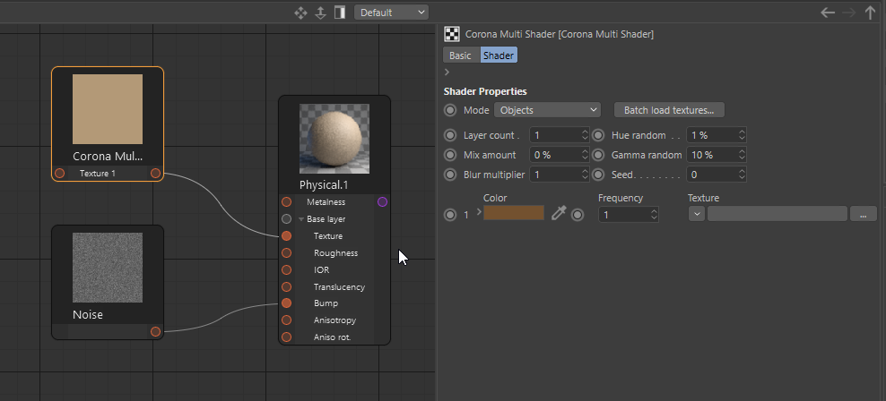

Note that the Corona Multi shader can be as well used with one item only.
You can then use hue and gamma values to randomize the colors.
Material setup:
