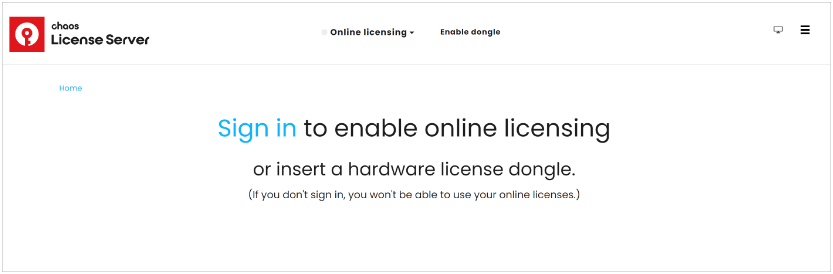

If you're not redirected to the Chaos License Server
  1. Open your web browser.
  2. Enter the URL: http://localhost:30304/
  3. Click "Sign in" and enter your registered email address and password.
Chaos License Server sign-in page
After signing in, your product will be activated.
