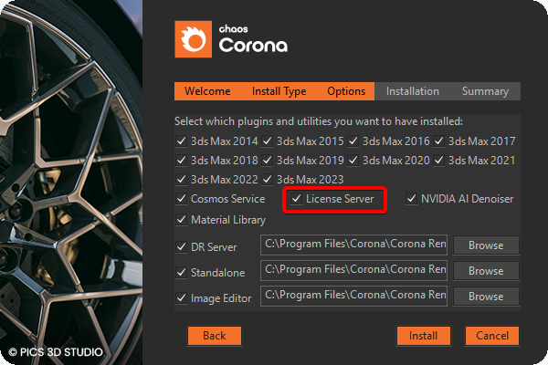

Windows:
Run the Corona installer and select the Custom installation mode:
Press Next and make sure that the License Server item is selected:
Press Install to finish the installation process.

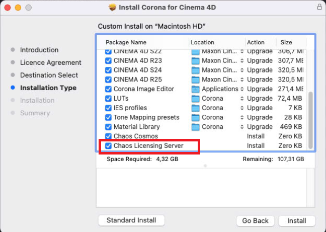

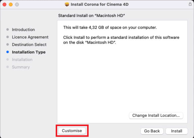

macOS:
Run the Corona installer and select "Customise":
Make sure that the Chaos Licensing Server option is enabled:
