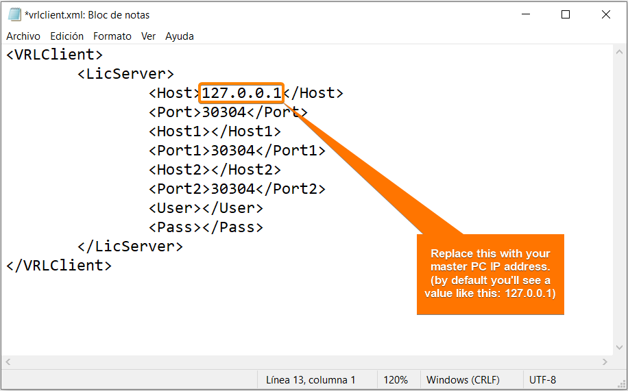

  4. Edit the copied vrlclient.xml file with a plain text editor to include the IP address of your PC running the Chaos License Server. Editing the vrlclient.xml file on Windows

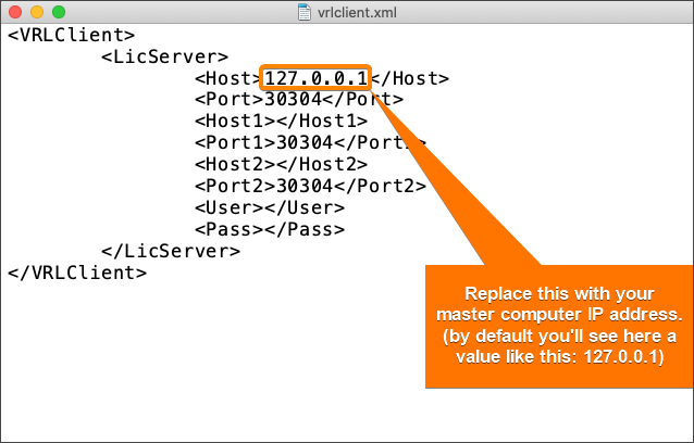

  3. Edit the copied file with a plain text editor like TextEdit to include the IP address of your computer running the Chaos License Server. Editing the vrlclient.xml file on macOS

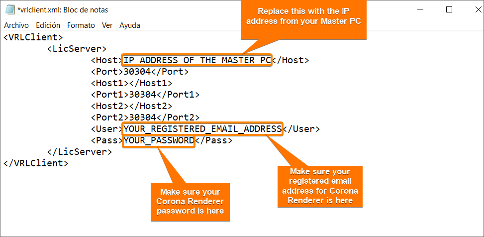

  • You can add your credentials to the vrlclient.xml file, but be aware that this exposes your registered email address and password. Adding credentials to the vrlclient.xml file
