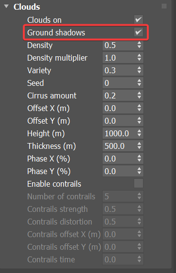

Preview of the VRaySun's Clouds rollout in 3ds Max

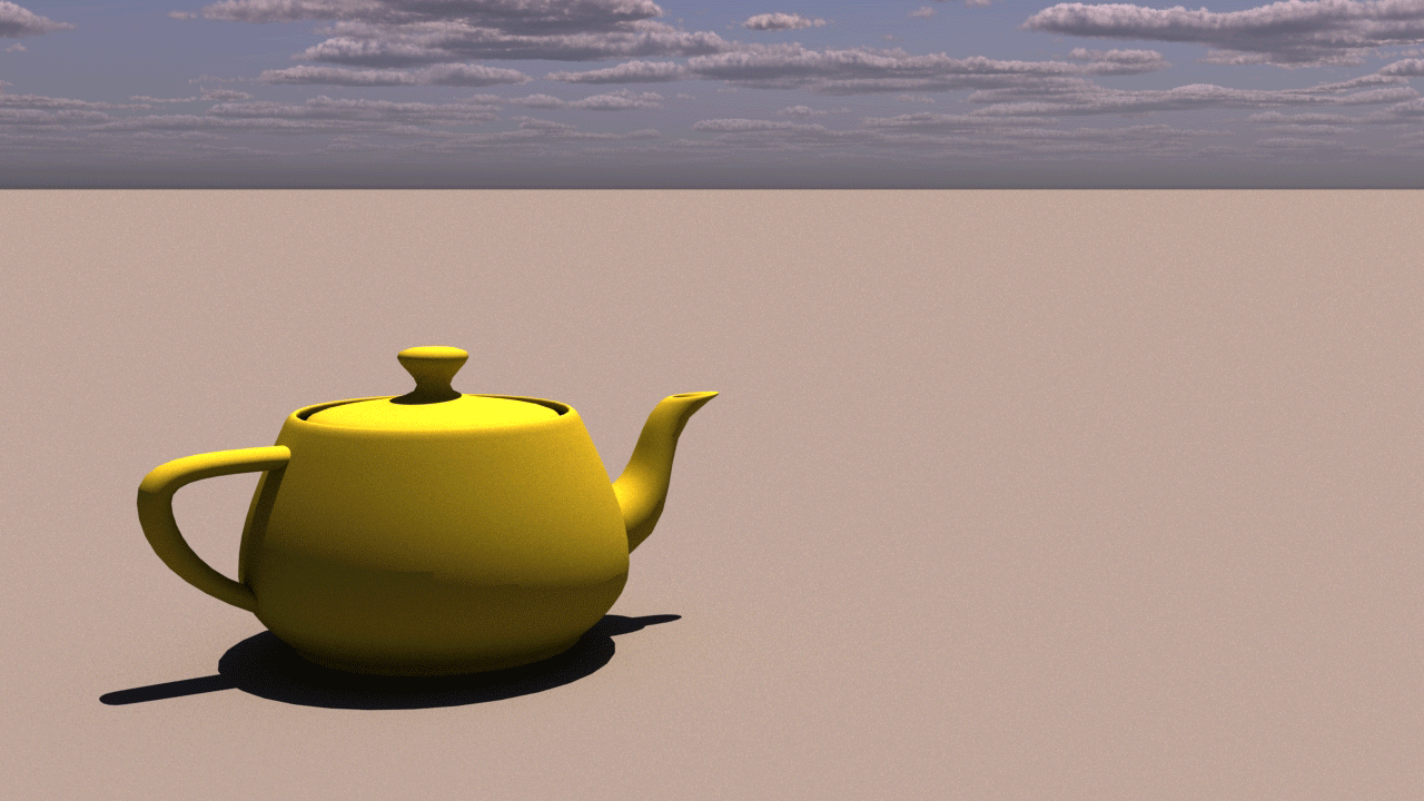

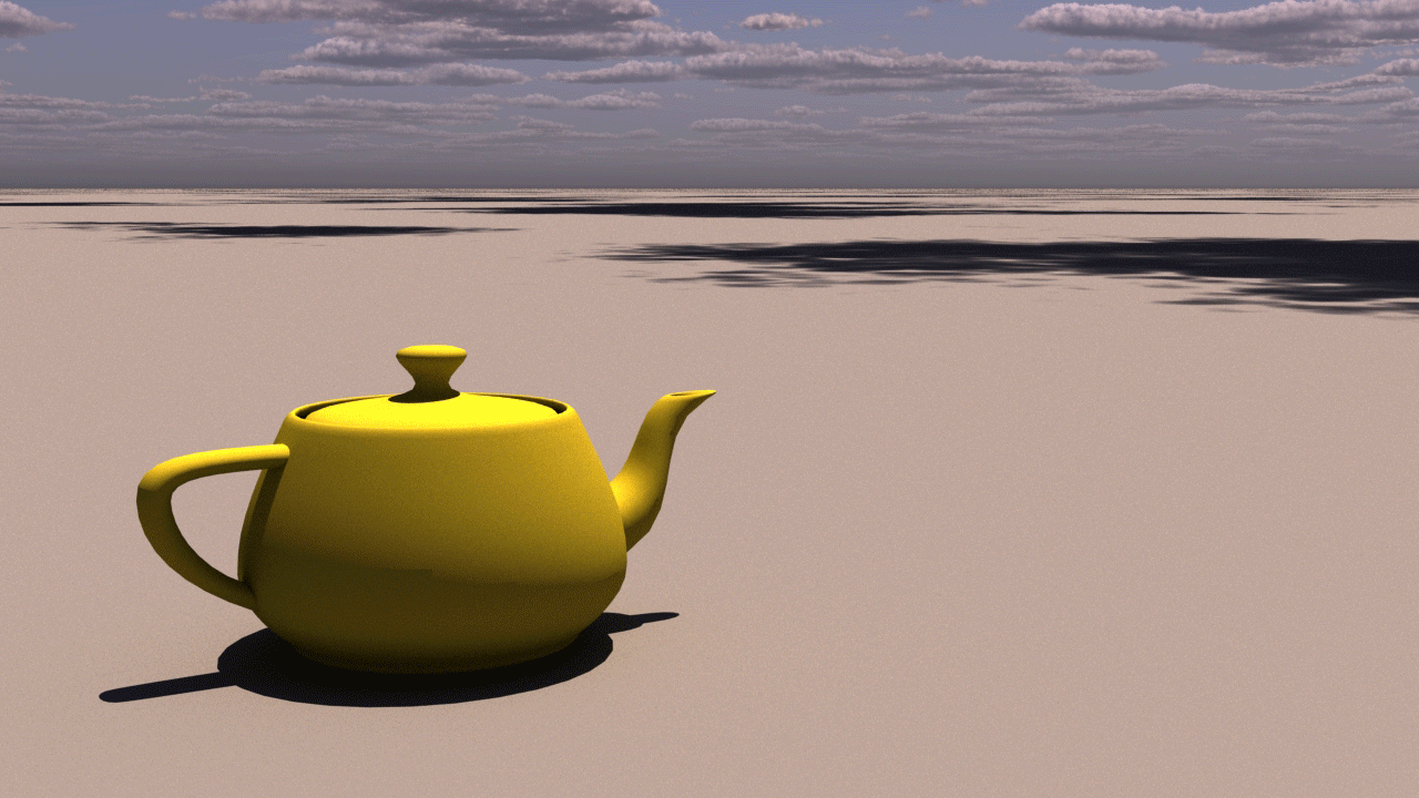

Switching the "Ground shadows" on and off can lead to different lighting conditions on the ground surface and sometimes produce results as if the shadows are always active.
Example comparison of Clouds between "Ground Shadow" switched on and off

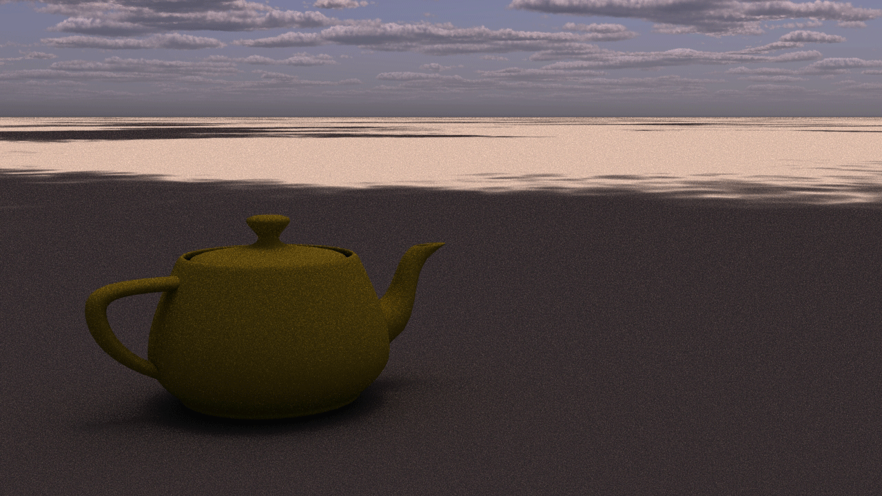

In the following examples, the camera gradually gets shadowed. Notice that the scene darkens with either "Ground Shadows" on or off.
Example sequence of Clouds with "Ground Shadow" switched on
Example sequence of Clouds with "Ground Shadow" switched off
