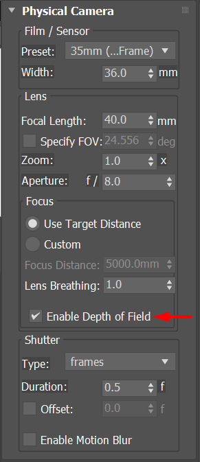

When rendering from a 3ds Max Physical Camera:
  1. Select the active 3ds Max Physical Camera.
  2. Enable "Enable Depth of Field" in the camera settings.
Depth of field is then controlled using the provided photographic controls.
Depth of Field controls in the 3ds Max Physical Camera

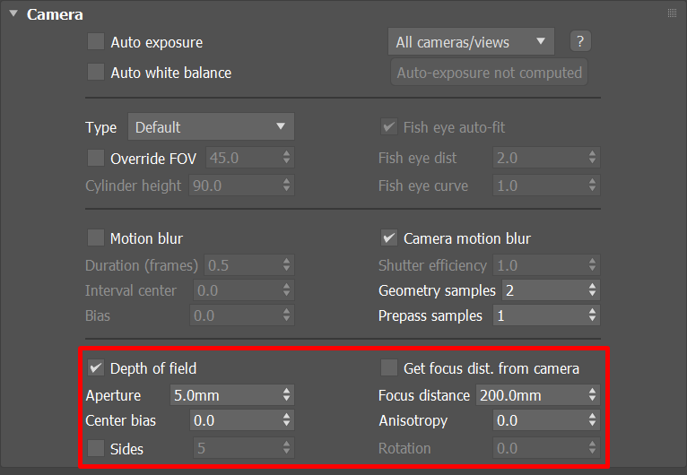

When rendering from a standard 3ds Max camera:
  1. Open Render Setup (F10) and go to the V-Ray tab
  2. In the Camera rollout > check Depth of Field
You can then use the settings available in the Camera tab of the Render Setup window to control the Depth of Field effect:
Depth of Field controls in the Render Setup
Notes:
  • It is not possible to enable Depth of Field for a free (non-camera) view.
  • The "Enable" Depth of Field checkbox in the Camera tab of the Render Setup window does not affect DOF settings when rendering from a VRay Physical Camera or a 3ds Max Physical Camera. The in-camera settings have a higher priority over this.

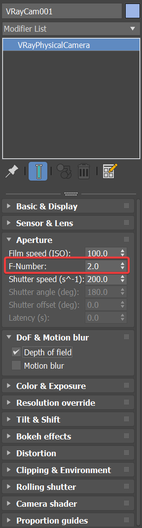

F-number
The F-number, also known as the f-stop or aperture, is a numerical value that represents the size of the aperture opening in a camera lens. It is a crucial parameter in photography and directly influences the exposure and depth of field in an image.
Just like in photography, increasing the F-stop value makes the DoF effect more subtle. Decreasing the F-stop value makes it more pronounced.
Lower F-number (more blur)
Higher F-number (less blur)
F-number: 2 F-number: 8

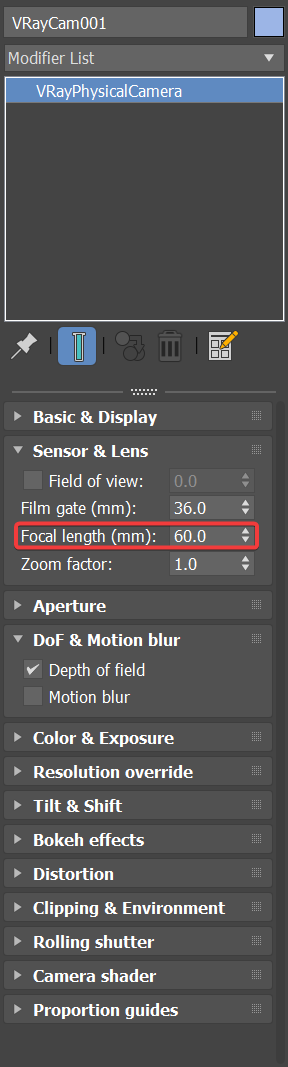

Focal Length
Focal length is a fundamental optical property of a lens and is a key specification in photography and optics. It is defined as the distance between the lens's optical center (or nodal point) and the image sensor or film when the lens is focused at infinity. Focal length plays a role in depth of field. Longer focal lengths tend to have a shallower depth of field, making them suitable for isolating a subject from the background, while shorter focal lengths provide a deeper depth of field.
Shorter focal length (wider view, deeper DoF)
Longer focal length (narrower view, shallower DoF)
Focal length: 30mm  Focal length: 60mm

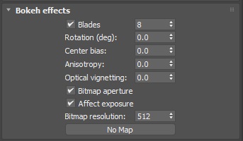

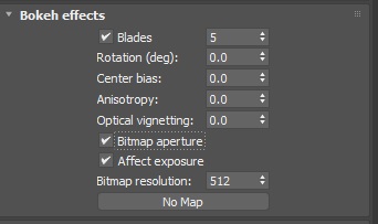

Bokeh
Bokeh occurs when the lens renders out-of-focus points of light. It is a bright spot in the places of an image where we have heavily blurred highlights. It’s shape depends on the number of blades in a lens aperture.
5 blades aperture
5 blades aperture example
8 blades aperture
8 blades aperture example

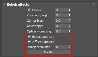

Bitmap aperture
Bitmap aperture exaple
