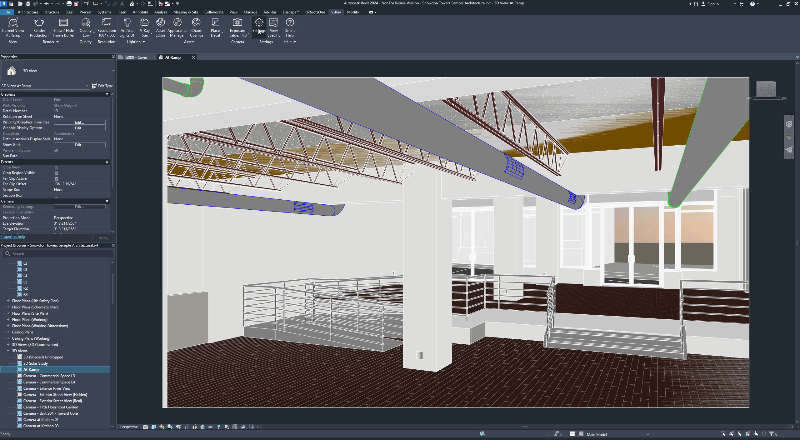

  • V-Ray for Revit: Save .rvt + linked files (if they are available). Enable Export as Archive in V-Ray Settings > Paths & Sharing, after that export V-Ray Scene.
    Revit Pack Example
