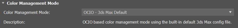

  • Color Management Mode
    The default mode uses the OCIO configuration file that is shipped with 3ds Max.
    It is located in the 3ds Max folder:
    C:\Program Files\Autodesk\3ds Max 20XX\ColorManagement\ocio_configs\3dsmax_default_ocio\

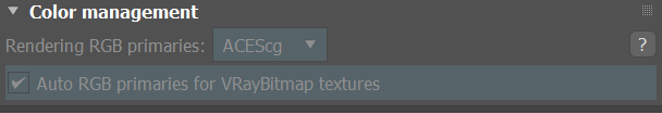

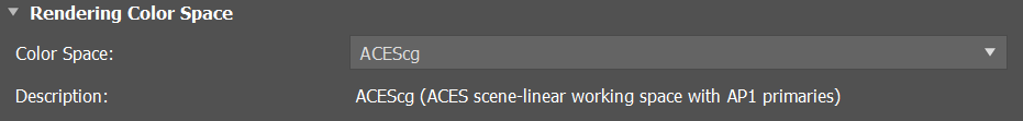

  • Rendering Color Space
    The default mode uses ACEScg as a rendering color space.
    Preview of the Rendering Color Space rollout
    The color space is automatically synced with the V-Ray Color management settings (Render setup>Settings>Color management).
    Preview of the synced V-Ray Color management

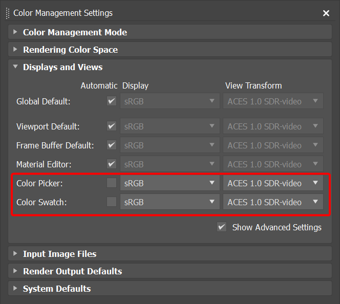

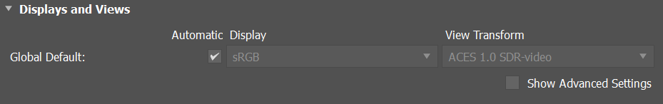

  • Display and Views
    These settings depend on your monitor's calibration and the view transform you wish to apply to the image. The default mode is "Automatic" and generally should not be adjusted.
    Preview of the Display and Views rollout
    To customize the individual settings, disable "Automatic" and check "Show Advanced Settings".

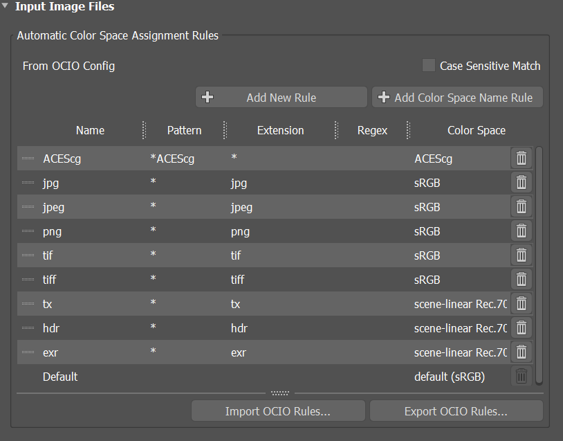

  •  Input Image Files
    The table shows the rules for automatically assigning color spaces to input images based on their filename. It works similarly to the “Auto RGB primaries for VRayBitmap textures” in the V-Ray color management settings, with the option for customization.
    Preview of the Input Image Files rollout

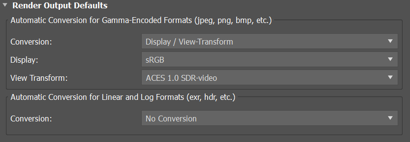

  • Render Output Defaults
    These settings control the color transformations applied to the output files. Their function is identical to the “Save in Image” option in the OCIO Display Correction layer in the VFB and analogous to the Gamma application when using the legacy Gamma Workflow.
    Preview of the Render Output Defaults rollout
    The Render Output Defaults affect all image outputs going through 3ds Max. This includes:
    • The 3ds Max Common output  (Render Setup > Common > Render Output)
    • V-Ray’s Separate render channels (Render Setup > V-Ray > Separate Render Channels)
    • VFB’s “Save Separate/Current channels”

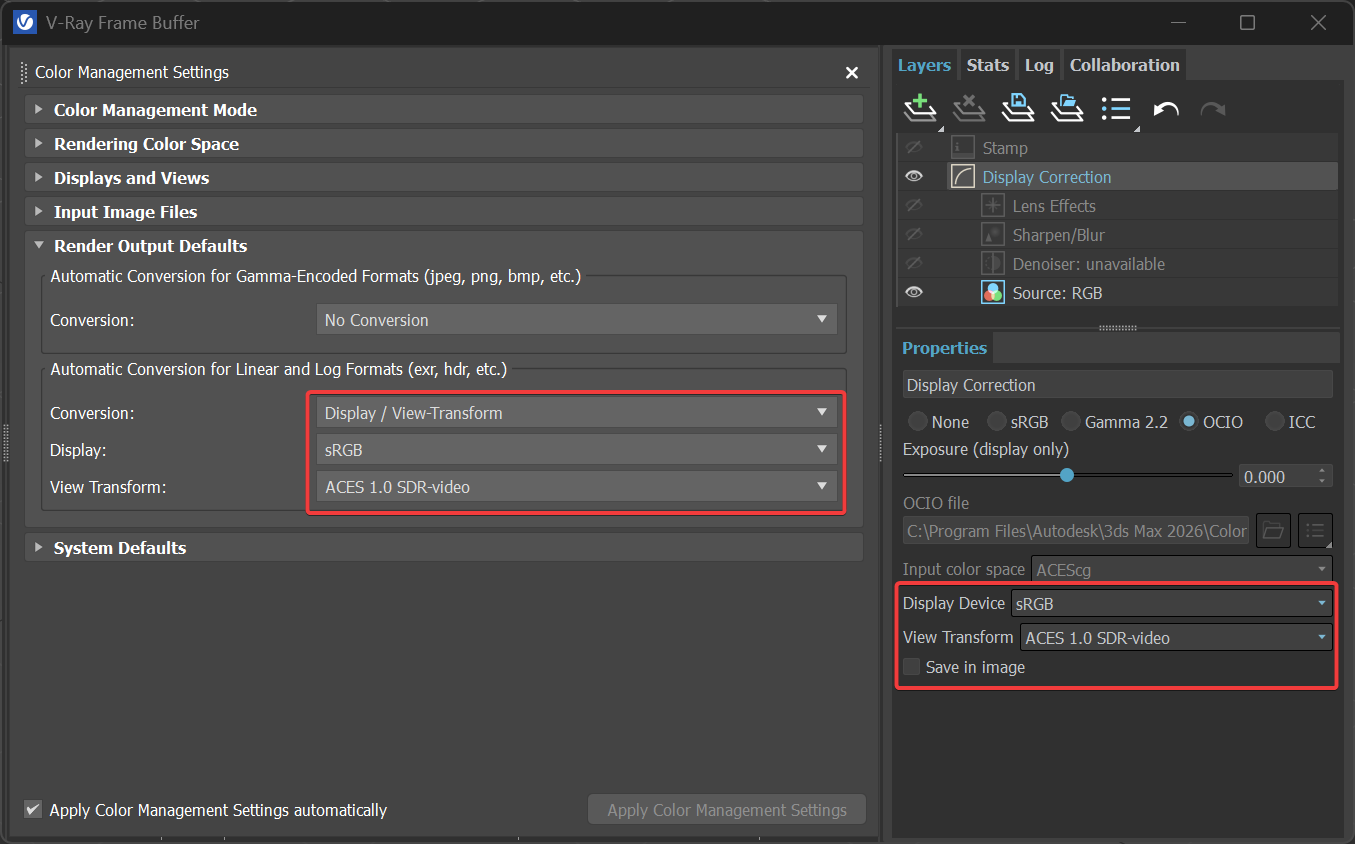

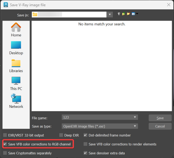

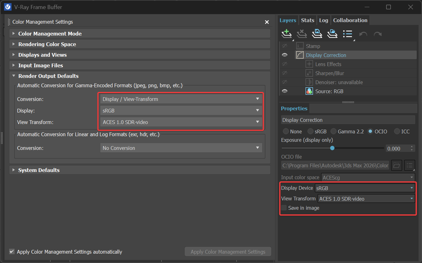

How to match my .png / .jpg output files to the VFB result?
To get identical results between the output gamma-encoded formats and the VFB result, you must save the Display Correction into the image. You can do that in two ways:
  1. By setting the Render Output Defaults in the 3ds Max Color Management Options to “Display / View Transform” and matching the Display and View Transform settings for Gamma-Encoded formats to the ones in the VFB's OCIO Layer.
    Preview of setup 1 for gamma-encoded image formats

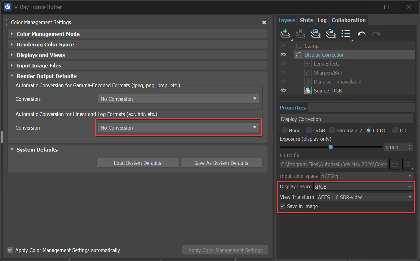

  2. By setting the Render Output Defaults in the 3ds Max Color Management Options to “No Conversion” and checking the VFB OCIO Display Correction layer’s “Save in Image” option. This way, V-Ray applies the transformations.
    Preview of setup 2 for gamma-encoded image formats
    IMPORTANT: To avoid double display correction application, you must use only ONE of the methods.

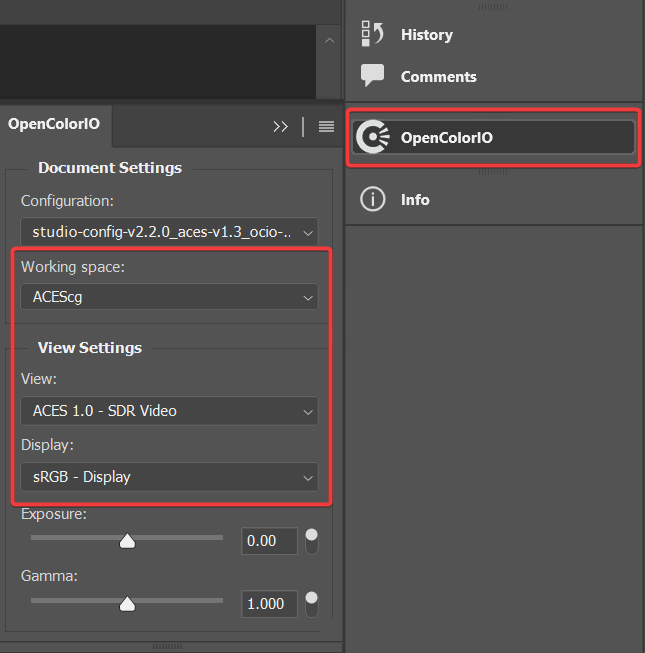

The standard workflow to get matching results between various post-processing applications and the VFB is to apply an identical Display Correction (OCIO configuration and settings) in the post-processing application.
Learn more in our How to match your V-Ray frame buffer result to external applications' preview when using OCIO article.

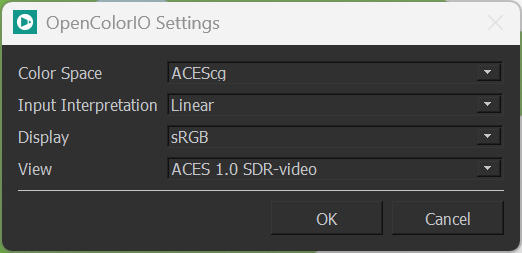

How to match the AI Enhancer result to the VFB?
When sending an image to the Chaos Collaboration to be AI-enhanced while working with the 3ds Max OCIO defaults, V-Ray converts the image's RGB Primaries from ACEScg to sRGB and does not bake the chosen View Transform. To get matching results, you need to load the AI-Enhanced result back into VFB, apply the correct Display Correction, and re-save.
The steps are as follows:
  1. Download the AI-Enhanced image (.png) from Chaos Cloud
  2. Load the image in the VFB (File > Load)
  3. Switch the Display Correction to OCIO
  4. Set the Input Color Space to "scene-linear Rec.709-sRGB"
  5. Set the Display Device to sRGB and View Transform to ACES 1.0 SDR-Video
  6. Check the "Save in Image" option
    Preview of the OCIO Display Correction setup

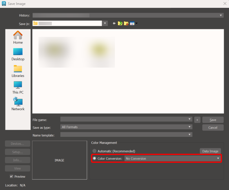

  7. Go to File > Save current channel
  8. In the browser window, set the Color conversion mode to "No Conversion"
    This is done to avoid applying a double View Transform (due to "Save in Image" being active)
    Preview of the Save Image window Color Management settings

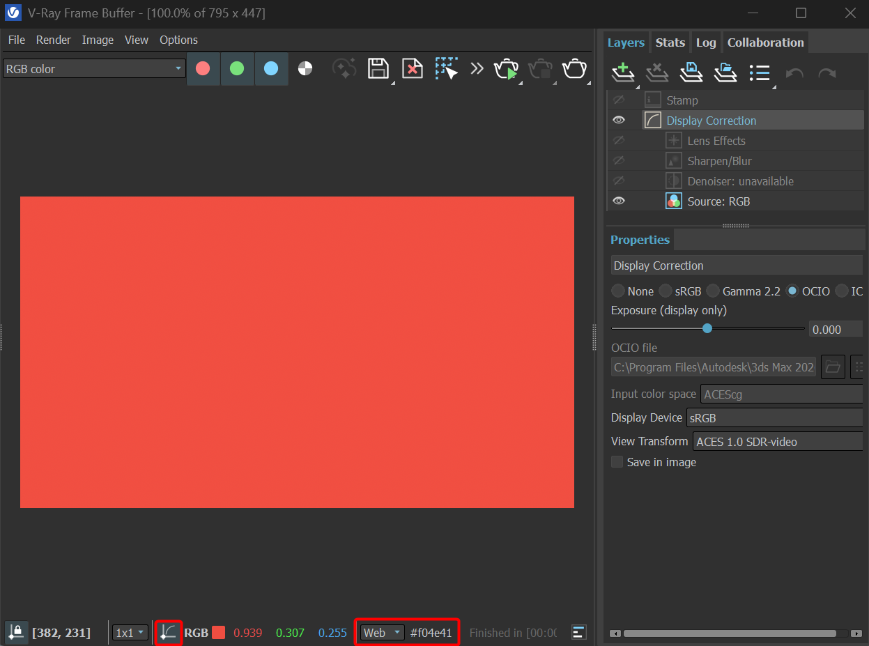

How to match a specific color to the result in the VFB?
To match a certain color's look (f.e, from the web) to the result in the VFB, you need to adjust the Color Picker and Color Swatch's Display and Views properties to consider the "ACES 1.0 SDR-video" View Transform.
  1. Go to Customize > Color Management
  2. In the Display and Views rollout, click "Show Advanced Settings"
  3. Uncheck the "Color Picker" and "Color Swatches" options
  4. Set both their View Transform options to "ACES 1.0 SDR-video"
    Preview of the 3ds Max Color Management's Display and Views settings
  5. For this example, we chose to match the #f04e41 web color.
    Example color from the web

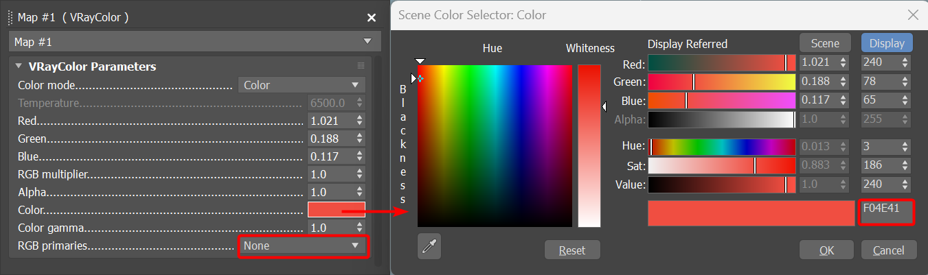

  6. Create a VRayColor node
  7. Set the VRayColor's RGB Primaries to "None"
  8. Open the Color Picker and input your web color name or its RGB values.
    Preview of the VRayColor's settings and color picker
  9. Apply the VRayColor node to an object and Render
  10. Click the "Show corrected colors" button to see RGB values instead of Raw values - the colors should match.
    Preview of the VRayColor's rendered result

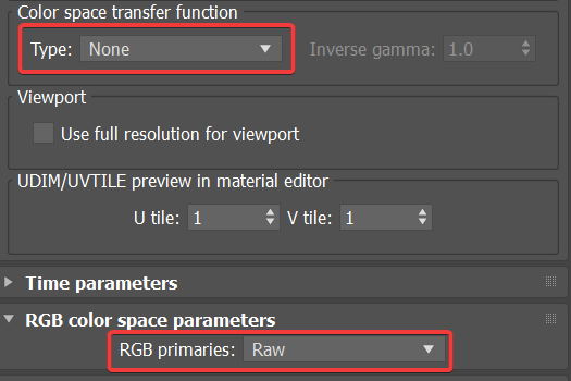

How to retain the original look of a certain texture?
To retain a certain texture look (f.e, sRGB) when working with the 3ds Max OCIO defaults, an inverse-transform must be applied through the VRayOCIO node.
IMPORTANT: The config.ocio file that is shipped with 3ds Max does not (as of 3ds Max 2026) contain an input space corresponding to “ACES 1.0 - SDR Video” to inverse-transform an image. A custom config.ocio must be used. Alternative OCIO configs that work well are provided by Marcin Piotrowski. Learn more in the Chaos Forums.
  1. Create a VRayBitmap node and load an image
  2. In the VRayBitmap node:
    • Set the Color space transfer function to Type: None
    • Set the RGB color space parameters to RGB primaries: Raw
      Preview of the VRayBitmap setup

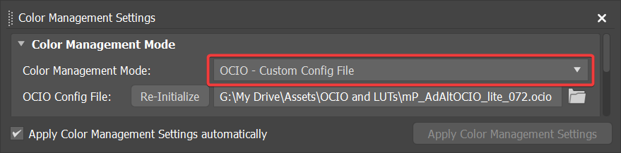

How to retain the original look of my Background layer's image?
To retain a certain Background layer look (e.g., sRGB), an inverse transform must be applied through the VFB Background layer's color transformation options.
  1. Go to Rendering > Color Management
  2. Set the Color Management Mode to “OCIO - Custom Config File” and load the custom OCIO configuration
    Preview of the 3ds Max Color Management settings

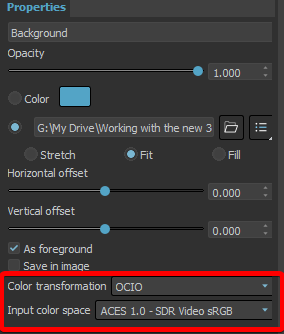

  3. Open the V-Ray Frame Buffer
  4. Create a Background layer and load an image
    • Set Color transformation to OCIO
    • Set Input color space to “ACES 1.0 - SDR Video sRGB”
      Preview of the Background layer setup

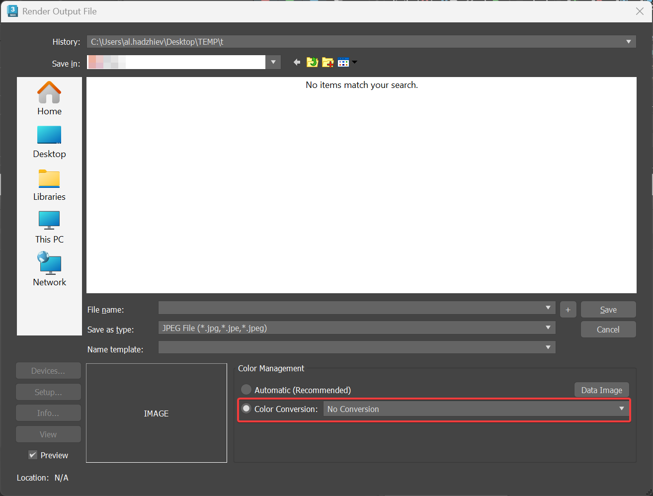

How to correctly bake texture nodes in the Material Editor?
To get identical results between a map and its baked version, loaded in a VRayBitmap, it must be saved without the 3ds Max render output defaults applied. Otherwise, the Display Correction will be baked, and it will have double Display Correction applied when bringing it back.
  1. Open the Slate/Compact Material Editor
  2. Right-click on the map and choose Render Map
  3. Set desired settings and choose an output path
  4. In the Render Output Window, set the Color Conversion to “No Conversion”
Preview of the Render Output File window setup
