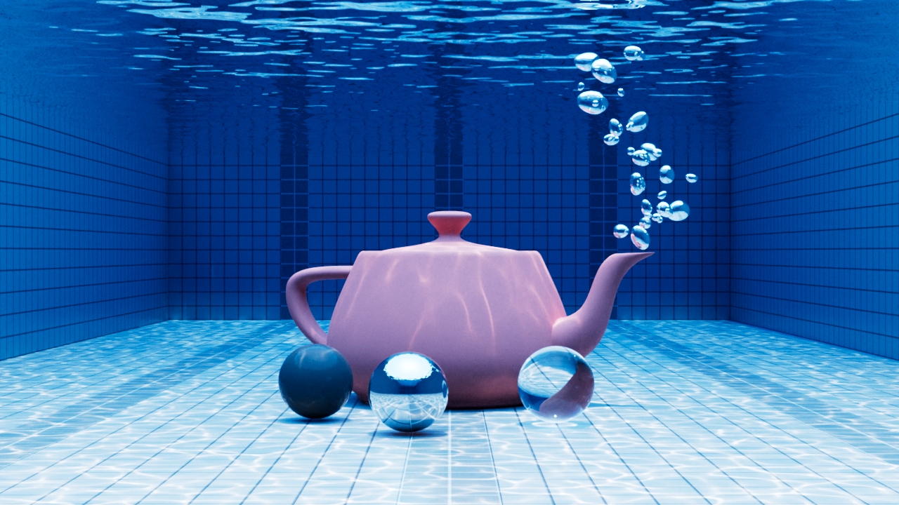

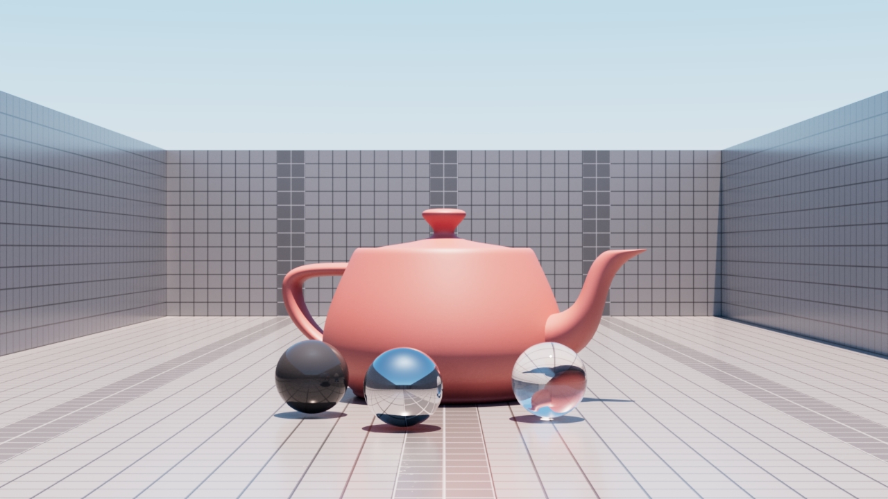

Pool scene, no water. Spheres from left to right: dielectric material (IOR 1.5), metal material, glass material (IOR 1.5).
Pool scene, with water.
Observe that the appearance of the spheres has changed. The dielectric sphere (left) appears less reflective. Refraction has changed in the glass sphere (right) - it now shows a different part of the teapot object. The biggest difference is in how the air bubbles are rendered (IOR 1.0). Without the water, they are completely invisible, because they have the same IOR value as the environment they are in (in Corona, the IOR for air is 1.0. In reality, it's slightly higher). This is expected when rendering from inside a medium with its IOR different from 1.0 (1.33 in case of water).
