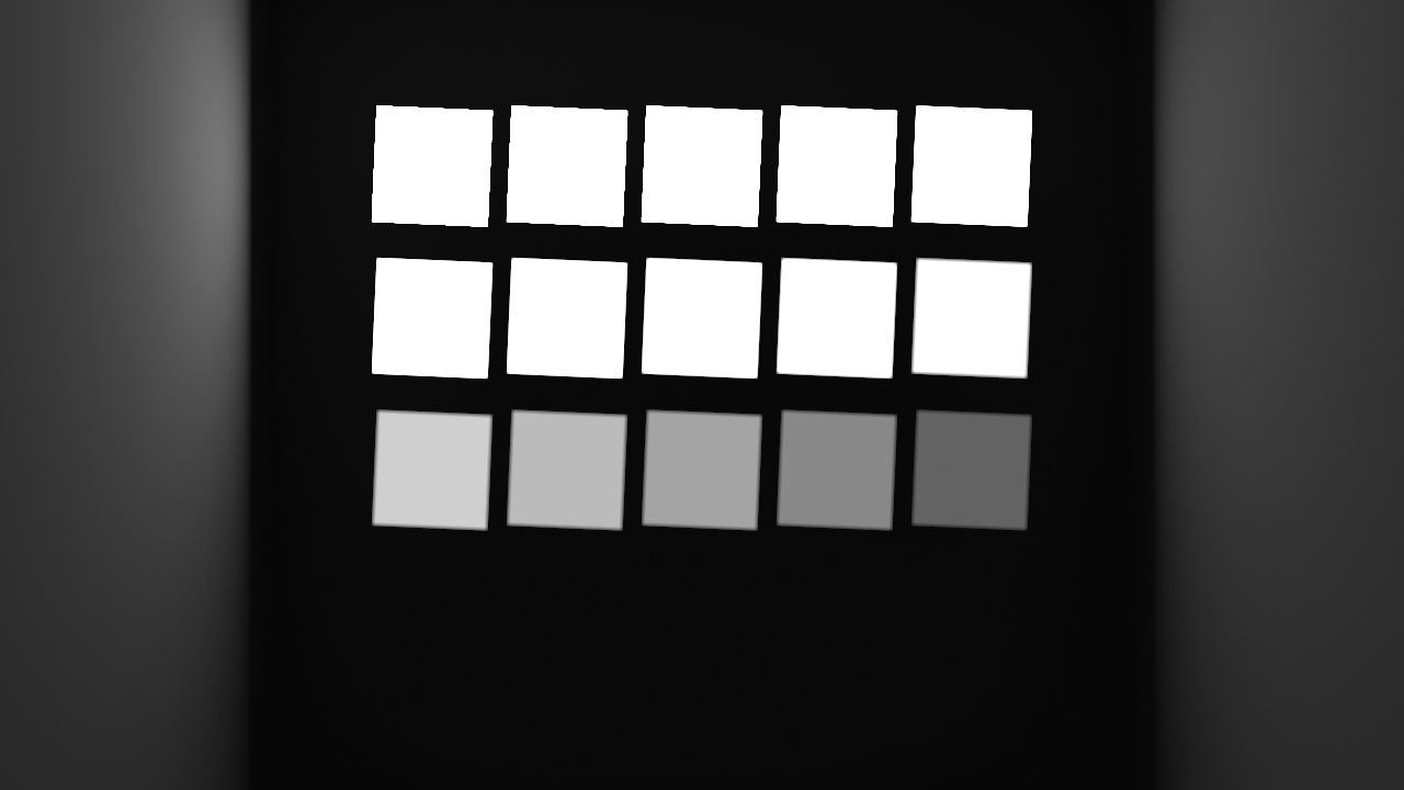

In some situations, particularly when there are places where bright and dark pixels meet, "jagged" or "aliased" edges may appear:
The scene above contains square lights with various intensities. Jagged edges are especially visible in places where very bright areas meet very dark areas.
Click to enlarge.

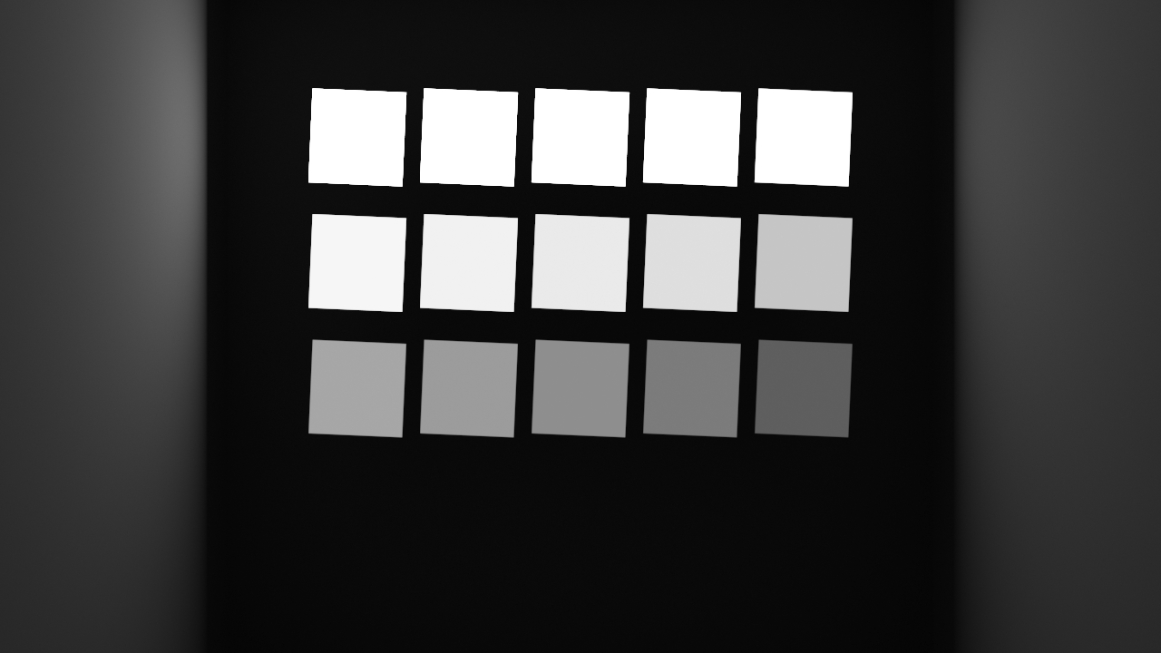

  • Add a new Reinhard Highlight Compression operator in the Post tab of the Corona VFB and increase its value:
Highlight compression increased to 10. This will "compress" the brightest areas of the image, while still preserving high dynamic range.
Click to enlarge (and compare with the original image above).

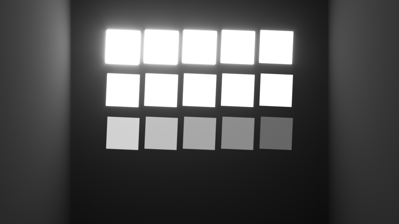

  • Enable Bloom & Glare in the Post tab of the Corona VFB:
Additionally enabling Bloom and Glare will help get rid of the jagged edges, however it will also add a "glow" effect around some of the brightest objects.
  • Go to Render Setup > System > Frame buffer > Image filter, change Image Filter Type  to Box and Width to a higher value (like 4):
Changing filter type to Box and increasing its width will help get rid of the jagged edges, but will also make the image much blurrier.
