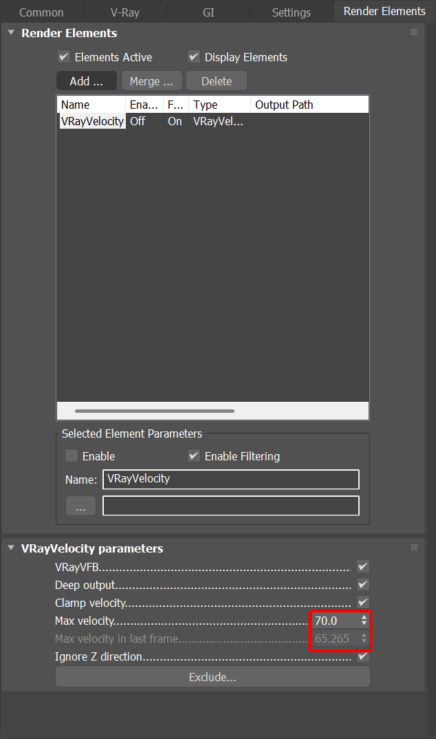

  2. Set the Max velocity parameter.
    To know what value to add, find a frame where the movement is the fastest and render it. Afterwards, look at the Max velocity in last frame parameter's value in the VRayVelocity element. Use a slightly higher value than the one displayed.
    Preview of the VRayVelocity setup in 3ds Max

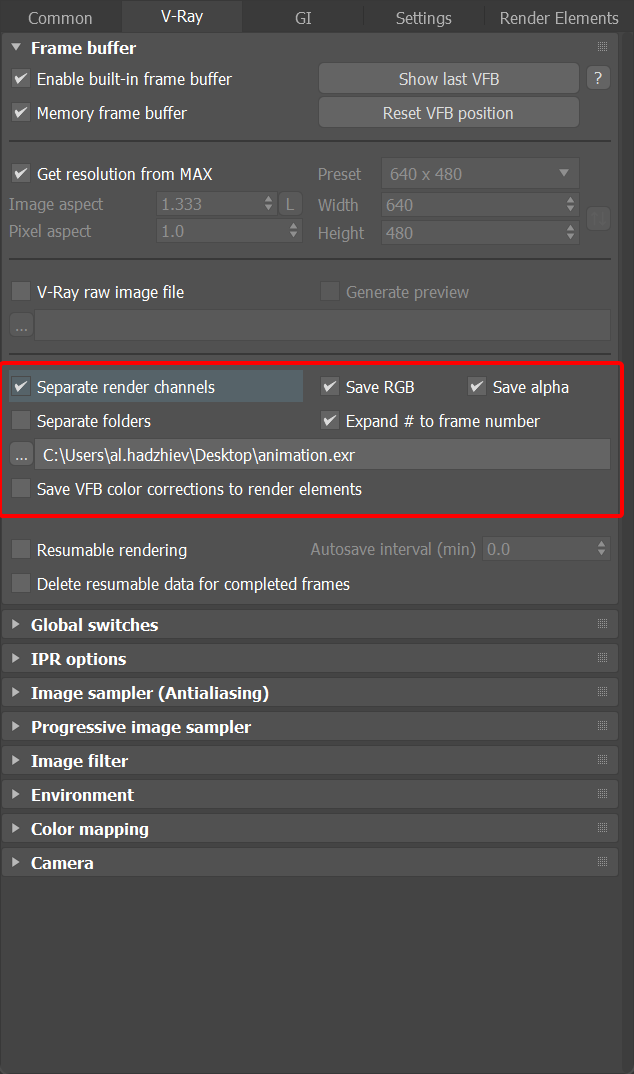

    In this tutorial, we'll output the sequence, using the .exr format, through V-Ray's Separate Render Channels option.
    Where to find the option:
    Preview of the output setup in 3ds Max
  4. Render

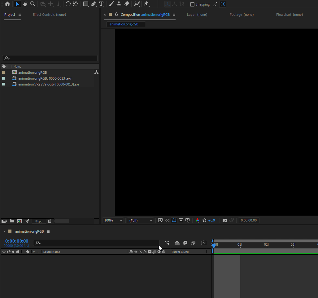

  1. Create a new composition, then load the RGB and Velocity sequences
  2. Ensure the Preserve RGB option is active for the Velocity sequence
    This will disable Color Management conversions for the element so as not to distort the values.
    Right-click on the Velocity sequence, then go to Interpret Footage > Main, and in the Color Management tab, enable Preserve RGB:
    Demonstration of preserving the RGB values of the VRayVelocity element in AfterEffects

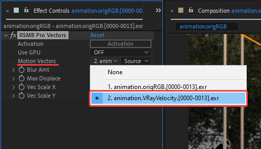

  4. In the Effect Controls panel, select the velocity sequence from the Motion Vectors drop-down menu:
    Preview of the Motion Vectors menu in AfterEffects

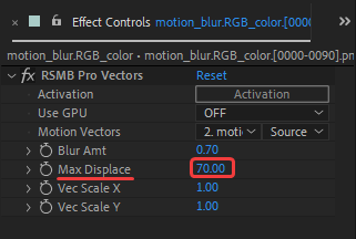

  5. Set the same value for the Max Displace as the one you used for the Max Velocity parameter in VRayVelocity render element.
    Preview of the RSMB setup

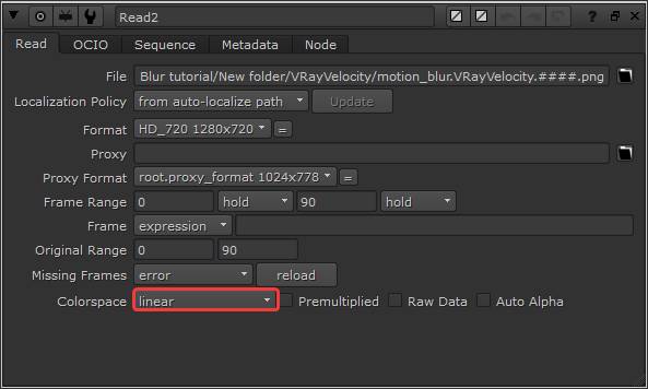

  3. Ensure the Colorspace in the Read tab of the VRayVelocity Read node to "Linear":
    Preview of the VRayVelocity's Read node setup in Nuke

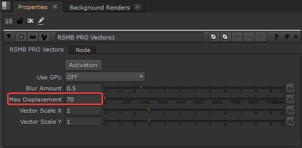

  6. In the Properties panel of the RSMB Pro Vectors node, set the same value for Max Displacement value as the one you used for the Max Velocity parameter in VRayVelocity Render Element
    Preview of the RSMB Pro Vectors setup in Nuke
