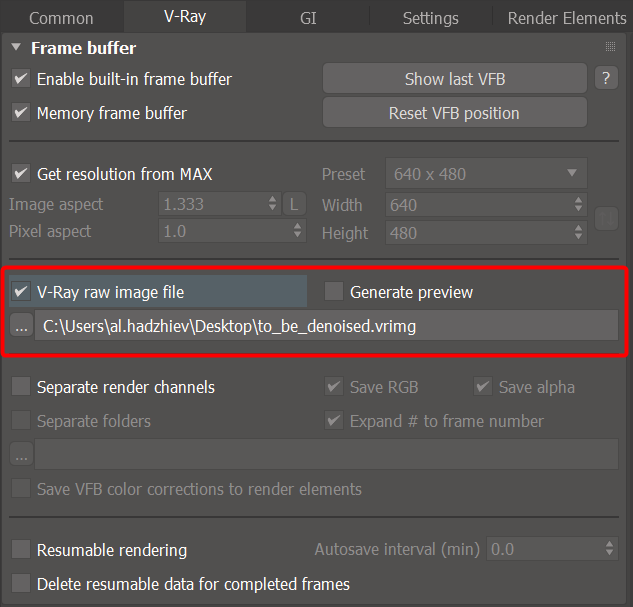

  1. Enable the Auto-Save / Image file output / V-Ray raw image file output
  2. Choose a path and format: .exr or .vrimg
    Where to find the option:
    V-Ray for 3dsMax: Render Setup > V-Ray > Frame Buffer > V-Ray Raw Image File
    V-Ray for Maya: Render Settings > Common > Image File Output
    V-Ray for SketchUp / Rhino:  Asset Editor > Render Output > Save Image
    V-Ray for Revit: V-Ray > Settings > Renderer > Auto-Save
    V-Ray for Cinema4D: Render Settings > Vray > Common > V-Ray Output System
    V-Ray for Houdini: V-Ray > Render Settings > Images
    V-Ray for Blender: Properties > Output Properties > Output
Preview of the V-Ray raw image file output's location in 3ds Max

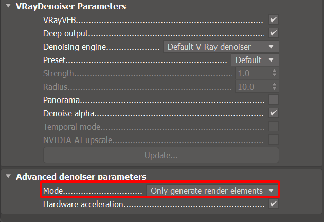

  3. Unhide the "Advanced" rollout
  4. Set the Denoiser Mode to “Only generate render elements”
    V-Ray for 3dsMax: VRayDenoiser > Advanced denoiser parameters
    V-Ray for Maya: Denoiser > Mode
    V-Ray for SketchUp / Rhino:  Denoiser > Mode
    V-Ray for Revit: Denoiser > Mode
    V-Ray for Cinema4D: Denoiser > Advanced Denoiser
    V-Ray for Houdini: V-Ray Denoiser (RE) > Mode
    V-Ray for Blender: Denoiser > Advanced
Preview of the VRayDenoiser's advanced rollout in 3ds Max

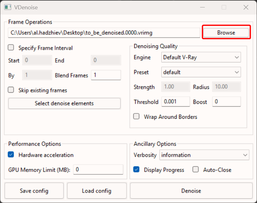

    2. Browse to the location where the rendered frames are saved
      Preview of the Browse button's location in the VDenoise tool's UI
      V-Ray will process the entire sequence. You can edit the frame interval by enabling the "Specify Frame Interval" checkbox.  By default, the VDenoise tool will denoise the RGB render element only. Additional render elements could be selected from the Select denoise elements button.

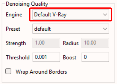

      3. Match the Engine with the one chosen in the host platform
      Preview of the Engine option's location
