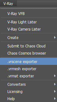

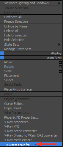

  2. Open the V-Ray tab and choose .vrscene exporter.  For the V-Ray 5 and older versions, Right-click anywhere in the viewport and press .vrscene exporter:
  3. Set an Export path and press Export.

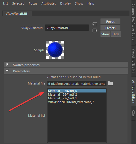

  4. In Maya, assign a VRMat material to an object and load the .vrscene into the Material file.
  5. From the Material list, choose which material to assign to your object.

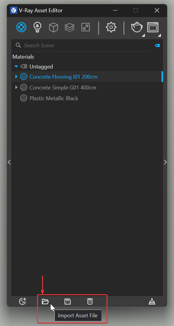

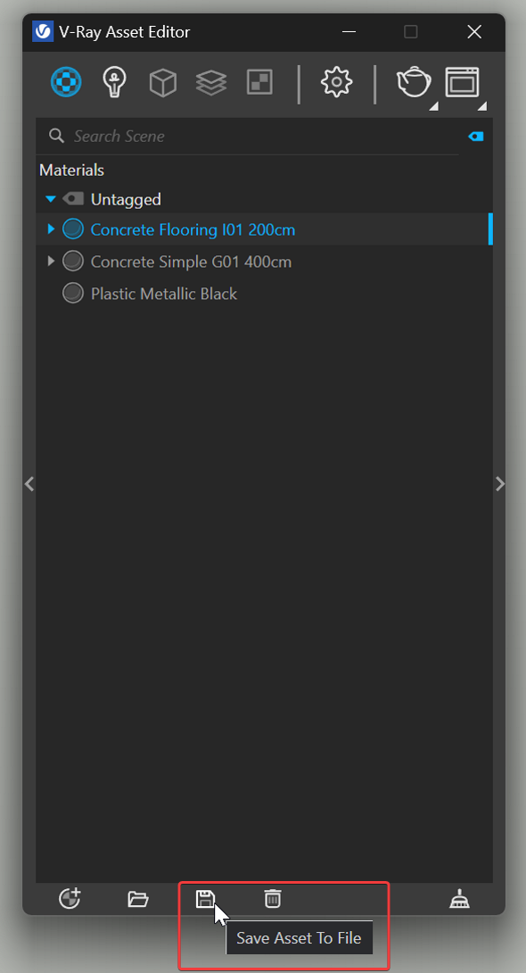

VRmat material (.vrmat) is an external V-Ray Material file format, which can be exported from SketchUp, Rhino, and Revit, and imported to any host platform. It can be used for transferring materials across applications. To transfer shaders, do the following:
  1. In SketchUp, Rhino or Revit, open the V-Ray Assets Editor.

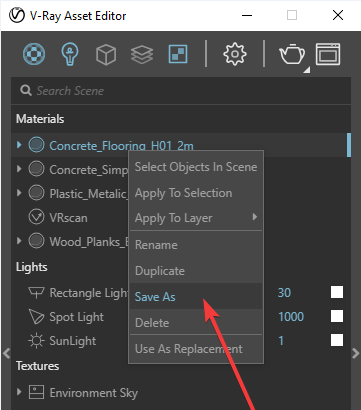

  2. Select material from your project, then right-click on the material, select Save as, and save you material as a .vrmat file.

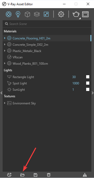

  3. To load the .vrmat file into your project click on the Import Asset File in the V-Ray Assets Editor:
For more information on how to import .vrmat files in other 3D platforms, refer to our online documentation. For example, to import the .vrmat material in V-Ray for 3ds Max, assign a VRayVRmatMtl material to your object, and then load the .vrmat file into it.
Advantages: Imported VRmat materials are editable in SketchUp, Rhino, and Revit, and allow further adjustments after importing them into your scene.
Disadvantages: In other host applications, such as 3ds Max and Maya, VRmat materials are read-only and do not allow further adjustments.

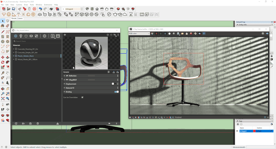

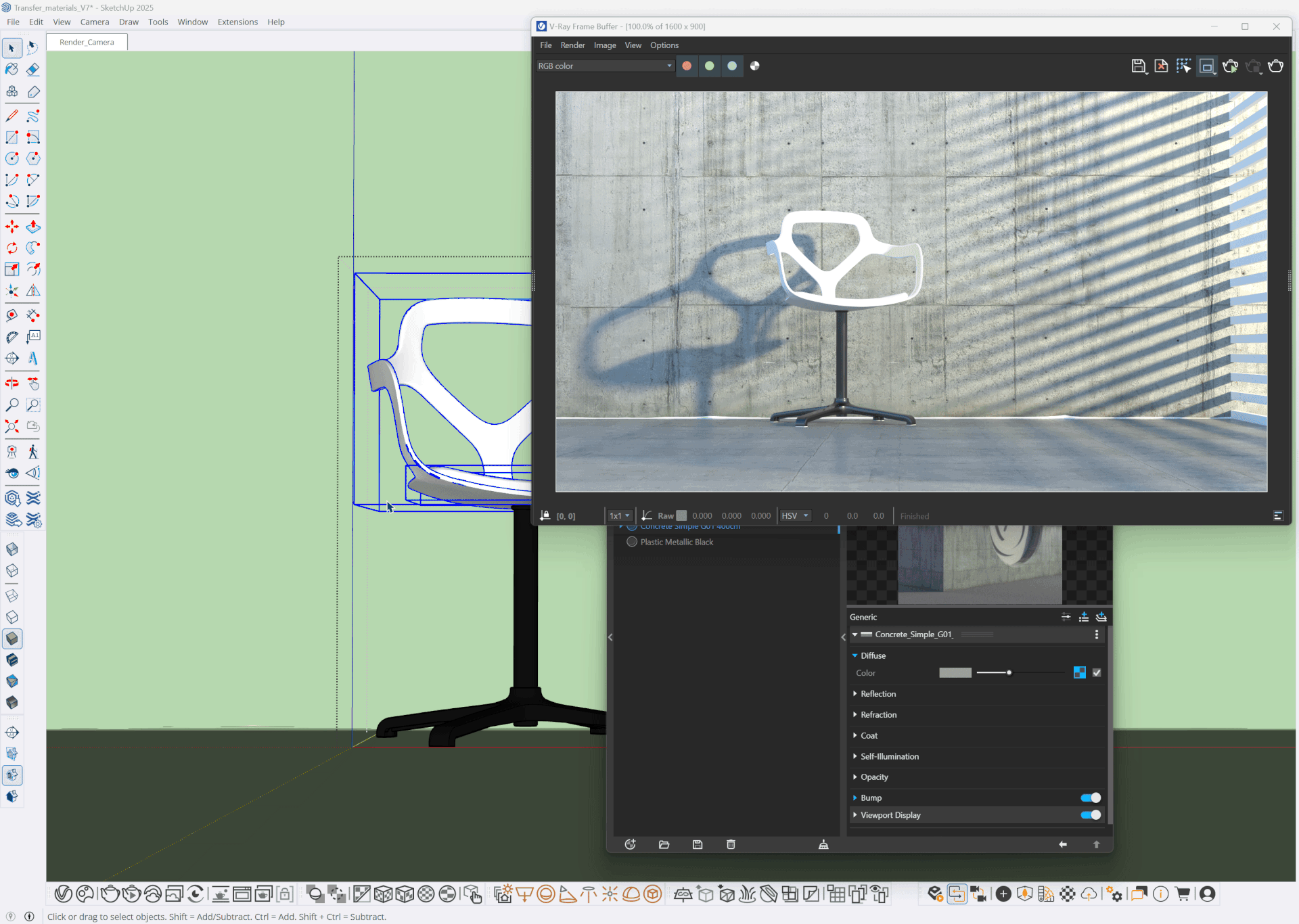

Example: Transferring a V-Ray Scene from SketchUp to 3ds Max
Following example shows how to transfer scenes from SketchUp to 3dsMax or Maya using the VRayScene file
Project files: Download Scene Files
Scene transfer workflow:
  1. In SketchUp, open Transfer_materials.skp project. To export the whole scene, open the Asset Editor, left-click on the arrow in the lower-left corner of the render button , and press the Export V-Ray Scene File button . Save the .vrscene file.
  2. In 3ds Max, from the Create panel go to Geometry > VRay category and press VRayScene.
  3. While the VRayScene node is selected, browse for the .vrscene file. Note that you can also load a V-Ray Scene by dragging and dropping a .vrscene file directly in the viewport.
  4. Set your camera and render.
