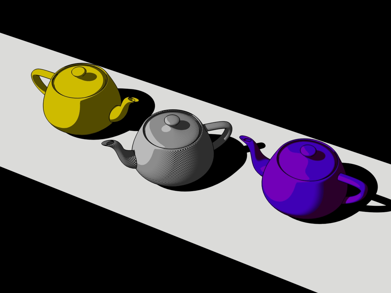

6. Finish off by adding a VRayToon effect to create Toon outlines
In 3ds Max: Environment and Effects > Atmosphere > Add > VRayToon
In Maya: V-Ray > VRayToon
Render with VRayToon outlines
