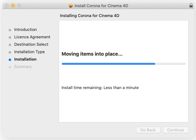

- Create a folder where the files will be extracted (e.g., you can create a folder named "Corona" on the Desktop) and click on the Choose button.
- Click on the Install button to continue with files unpacking.

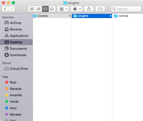

3. Installing the files:
- Once the unpacking process is complete, a new folder named "plugins" will appear inside the newly created folder (for this example, the "Corona" folder is located on the Desktop).

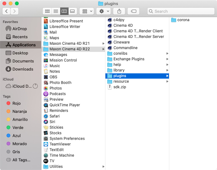

- Next, copy the contents of this "plugins" folder to the following path:
~/Applications/Maxon Cinema 4D R22/plugins/
- Run Cinema 4D, and If successful, you should now see Corona up in the main menu.
