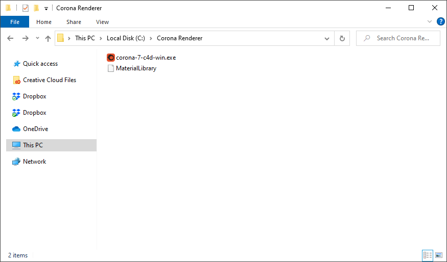

3. Place the downloaded MaterialLibrary file next to the universal installer. Make sure that the MaterialLibrary file is placed next to the unpacked executable installer file (.exe), not the downloaded archive. For example, if the universal installer is located in C:\Corona Renderer, then place the MaterialLibrary file in C:\Corona Renderer as well:

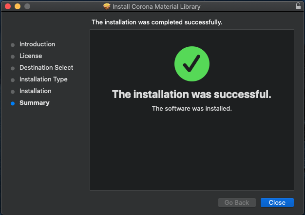

Mac users: After the Corona installation is complete, run the Material Library package (.pkg file) file to install it. Continue until the installation of the Material Library is complete.
