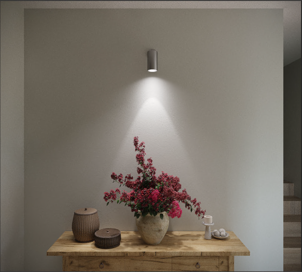

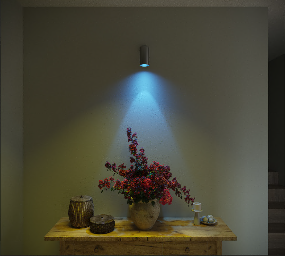

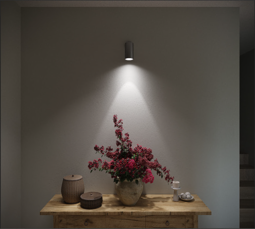

  • Keep in mind that the LightMix color acts as a filter on the original light color
    The color in the LightSelect does not replace the original color of the light but instead filters it (for example, if a light has a strong red color in the scene itself and you add green in the LightSelect, the result will be an orange color in the LightMix render). This means that the more saturated the color of the light in the scene, the less control you will have over it in LightMix - this can be resolved for any lights that you plan to control extensively in the LightMix by leaving the light a white color in the scene.

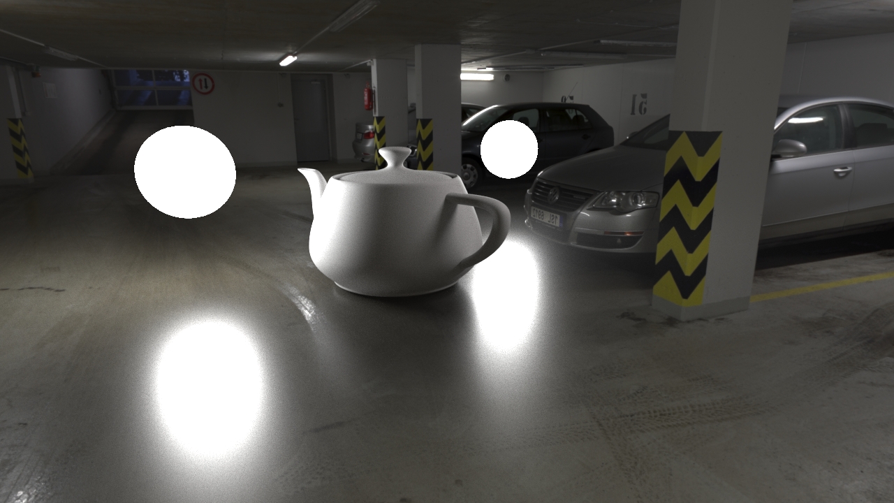

  • Using extremely high or low light intensities
    This will result in persistent noise (fireflies).
    Solution: after setting the LightMix as desired, use the >Scene (Bake) button in the VFB LightMix tab to bake your settings into the scene.
Using extremely high or low light intensities in the LightMix always leads to excessive noise.
