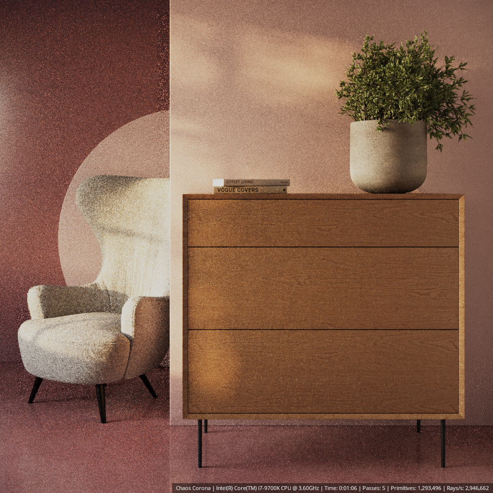

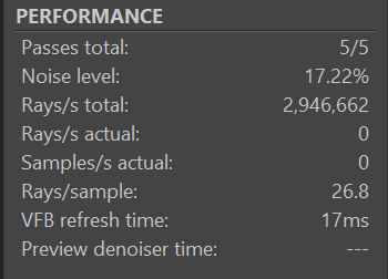

1. Noise level 100.
The rendering was stopped after 5 passes when the noise limit of 17,22% was measured.
Time: 01:06

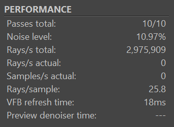

2. Noise level 10.
The rendering was stopped after 10 passes when the noise limit of 10,97% was measured.
Time: 01:49

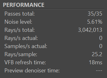

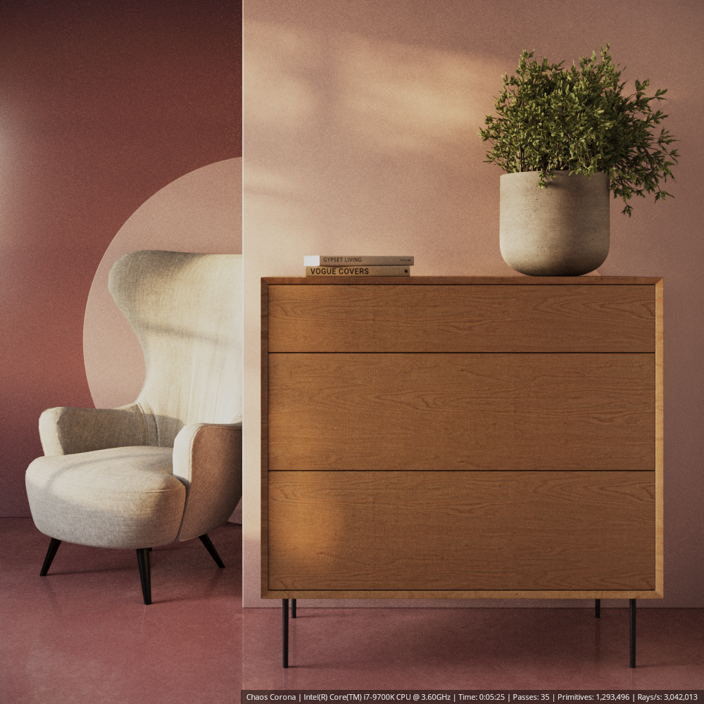

3. Noise level 5.
The rendering was stopped after 35 passes when the noise limit of 5,61% was measured.
Time: 05:25

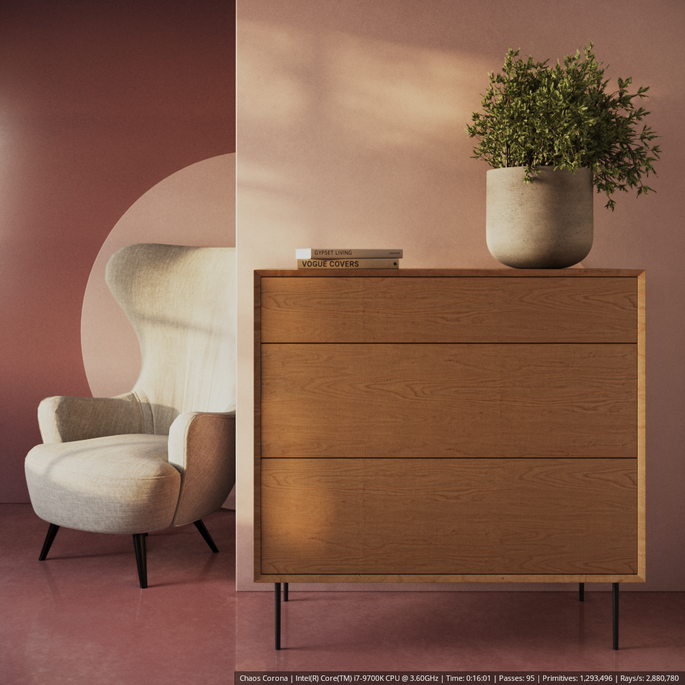

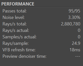

3. Noise level 3.
The rendering was stopped after 95 passes when the noise limit of 3.3% was measured.
Time: 16:01

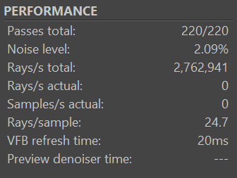

4. Noise level 2.
The rendering was stopped after 220 passes when the noise limit of 2% was measured.
Time: 41:38
