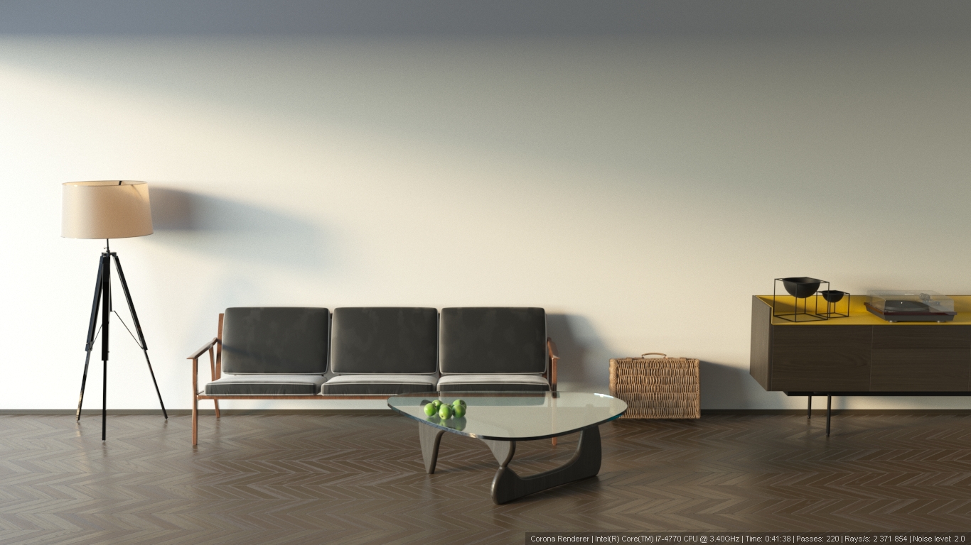

4. Noise level 2.
The rendering was stopped after 220 passes when the noise limit of 2% was measured.
Time: 41:38
