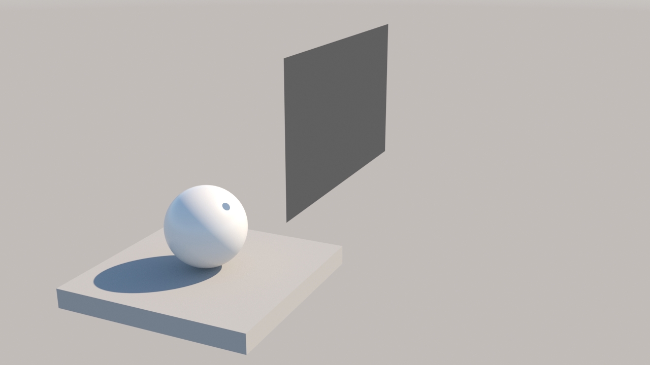

Sometimes "black highlights" or other artifacts may appear on objects with reflection glossiness level lower than 1. Example cases:
"Black highlights":

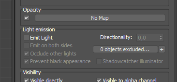

- Black reflection of sunlight may be visible on materials with glossiness lower than 1, if sunlight is passing through a Corona Light material with the "emit light" option disabled:

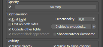

Correct result - the plane uses a Corona Light material with the "emit light" option enabled:
Incorrect result - the plane uses a Corona Light material with the "emit light" option disabled:
The workaround, which in some cases may help get rid of this issue, is using two different versions of a Corona Light Material with a Rayswitch Material: https://forum.corona-renderer.com/index.php?topic=32357.msg181607#msg181607

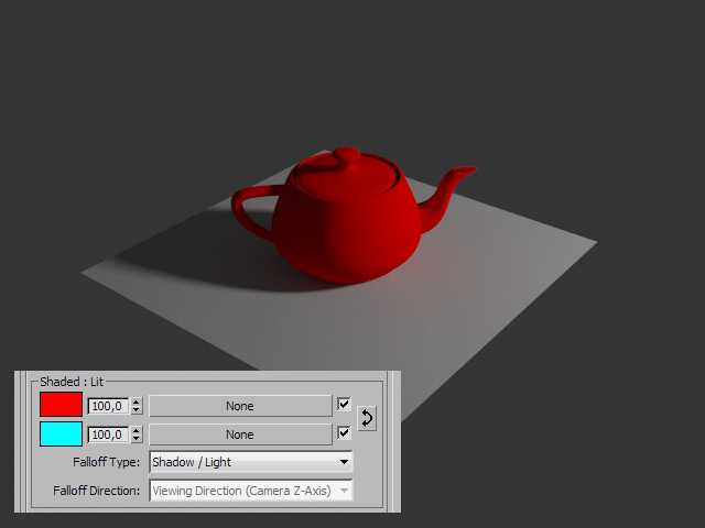

- [3ds Max] Falloff map in Shadow/Light mode is not supported:
