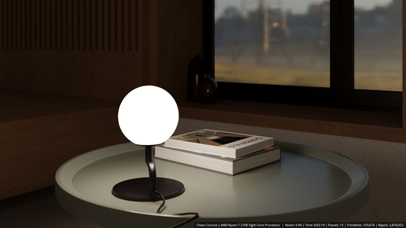

1. Key light source
Light Material
15 passes
Corona Material with self-illumination
15 passes

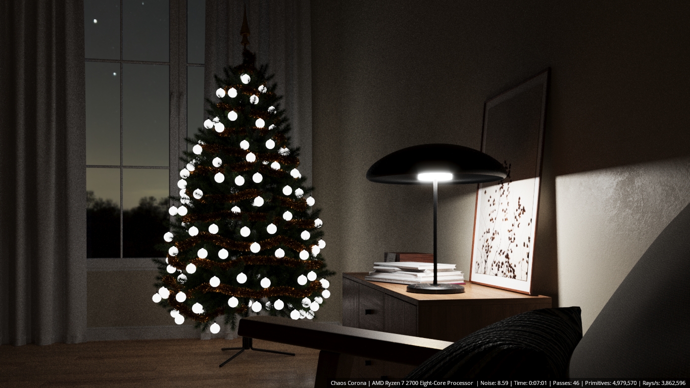

2. Key light and faint light sources
Tree lights - self-illumination
Table lamp - Corona Light material
46 passes
Rendering time: 00:07:01
Rays/s: 3,862,596
Correct setup.

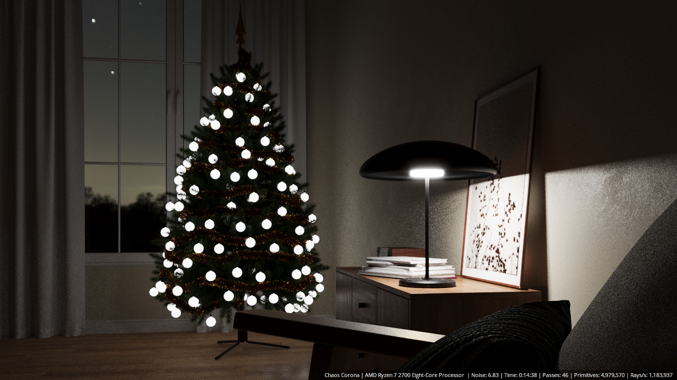

B
Tree lights - Corona Light material
46 passes
Rendering time: 00:14:38
Rays/s: 1,183,937
Incorrect setup. Samples required by the Table lamp are "stolen" by light material assigned to the lights on the tree. Rendering is slower and its quality is worse.

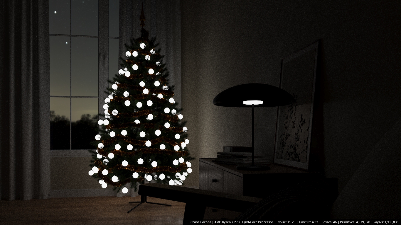

C
Table lamps - self-illumination
46 passes
Rendering time: 00:14:32
Rays/s: 1,905,835
MSI=20 (default setting)
Incorrect setup. Rendering is fast but intensive light is clamped by MSI, which produces wrong results.
