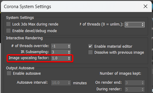

2) Image upscaling factor
Solution:
You can disable the image upscaling factor in Render Setup > System > System settings (set it to 1.0):
See: What is Image upscaling factor?

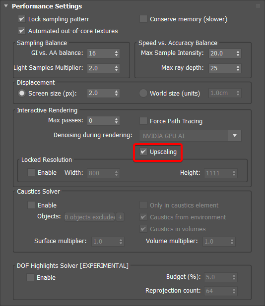

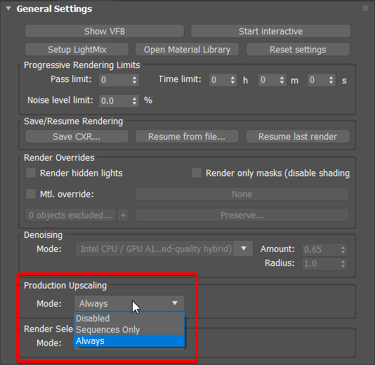

3) NVIDIA AI Upscaling
Solution:
Disable the NVIDIA AI Upscaling for production and interactive rendering:
  • Production rendering: go to Render Setup > Scene > Production Upscaling and make sure "Mode" is set to "Disabled"
  • Interactive rendering: go to Render Setup > Performance > Interactive Rendering and make sure the checkbox "Upscaling" is disabled.
