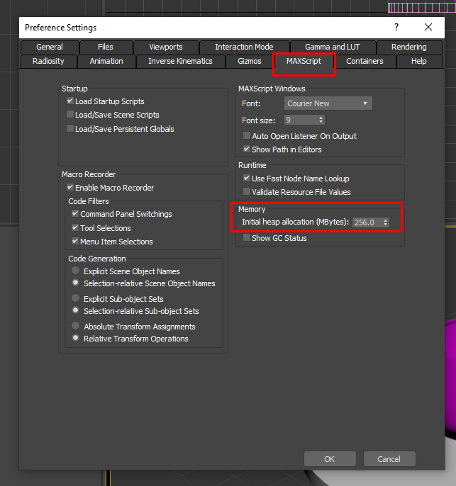

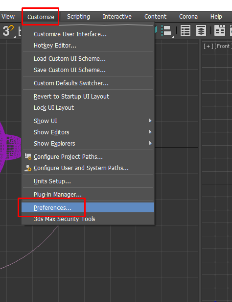

1) Set Maxscript initial heap allocation to 256 MB in 3ds Max settings as instructed in the attached screenshots and then restart 3ds Max:
If the problem still persists:

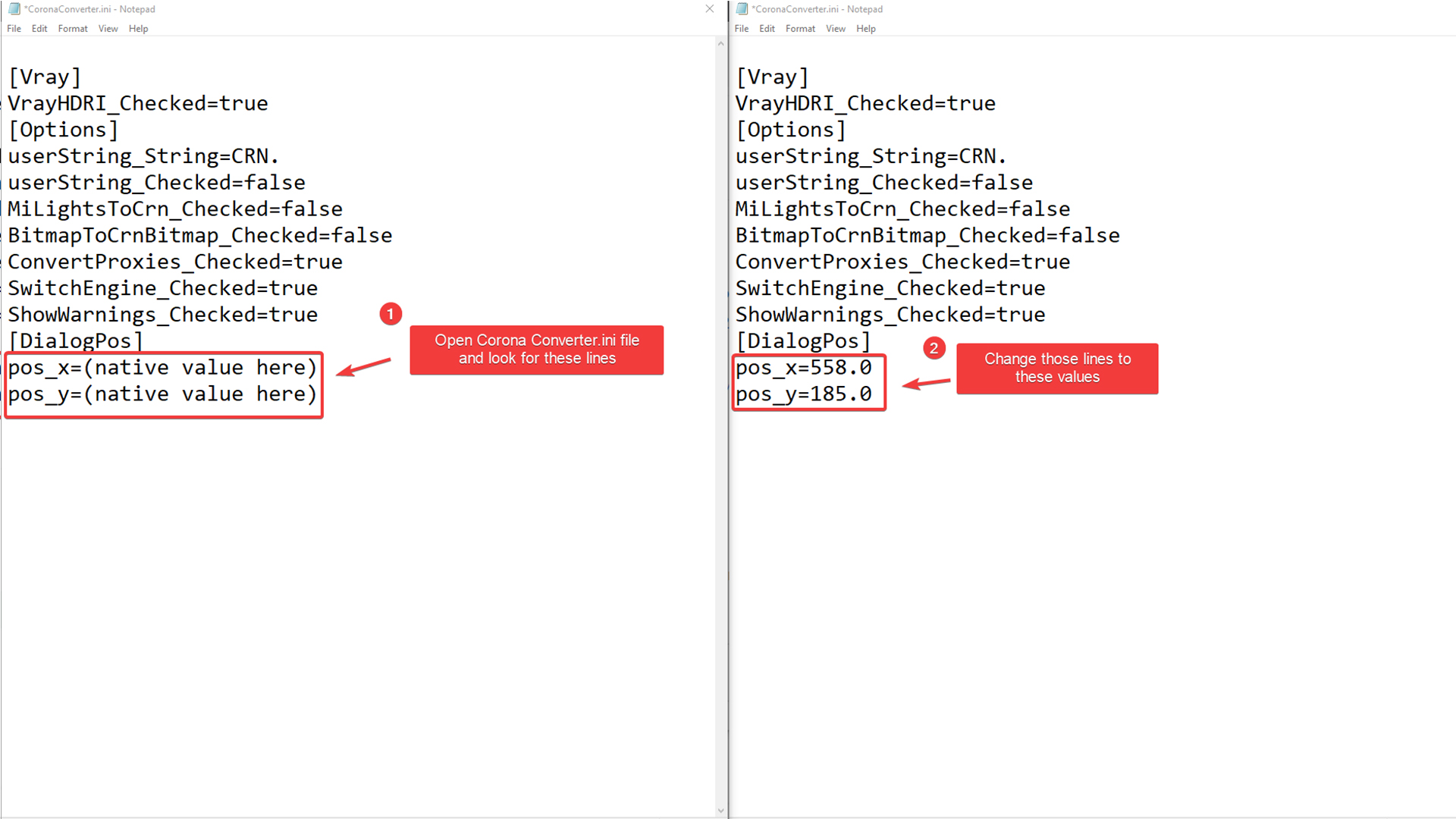

2) Try manually editing the Corona Converter.ini file in:
C: \Users\***Username***\AppData\Local\Autodesk\3dsMax\20** - 64bit\ENU\en-US\ plugcfg\
Note: Make sure 3ds Max is closed before you make any edits to the Corona Converter.ini file.
