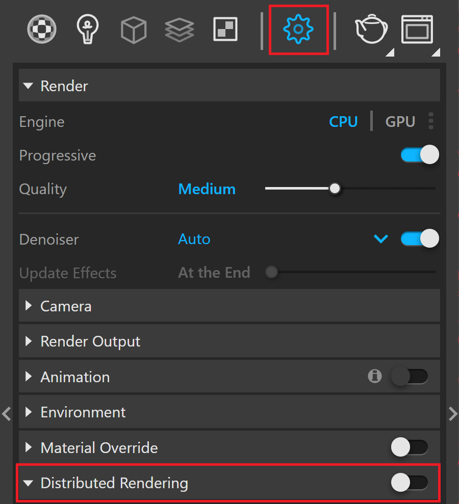

  1. Open the Asset Editor > Settings and enable Distributed Rendering.VRay7.1.0_DR_Settings2.png

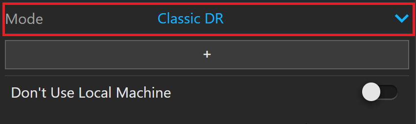

  2. In the Mode dropdown, select Classic DR instead of Swarm.
  3. Add each render node by hostname or IP address and enter its server port (As of V-Ray 7.30.00, the default port is 20209). Enable the hosts you want to use and disable or remove any that should not participate.

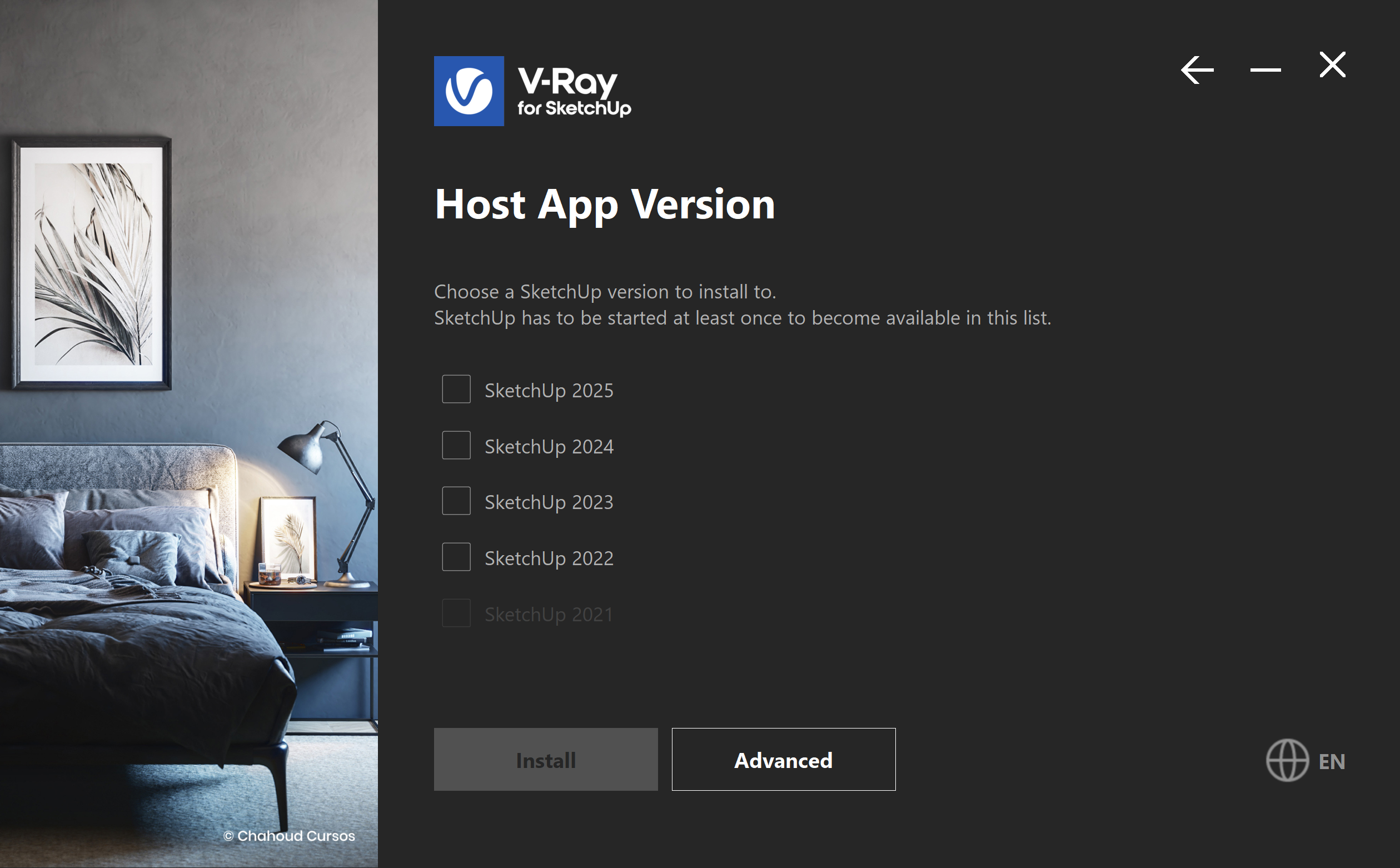

  • On the Host App Version screen, uncheck all versions and click Advanced.SketchUp2025_VRay7.1.0_Installer_HostApp.png

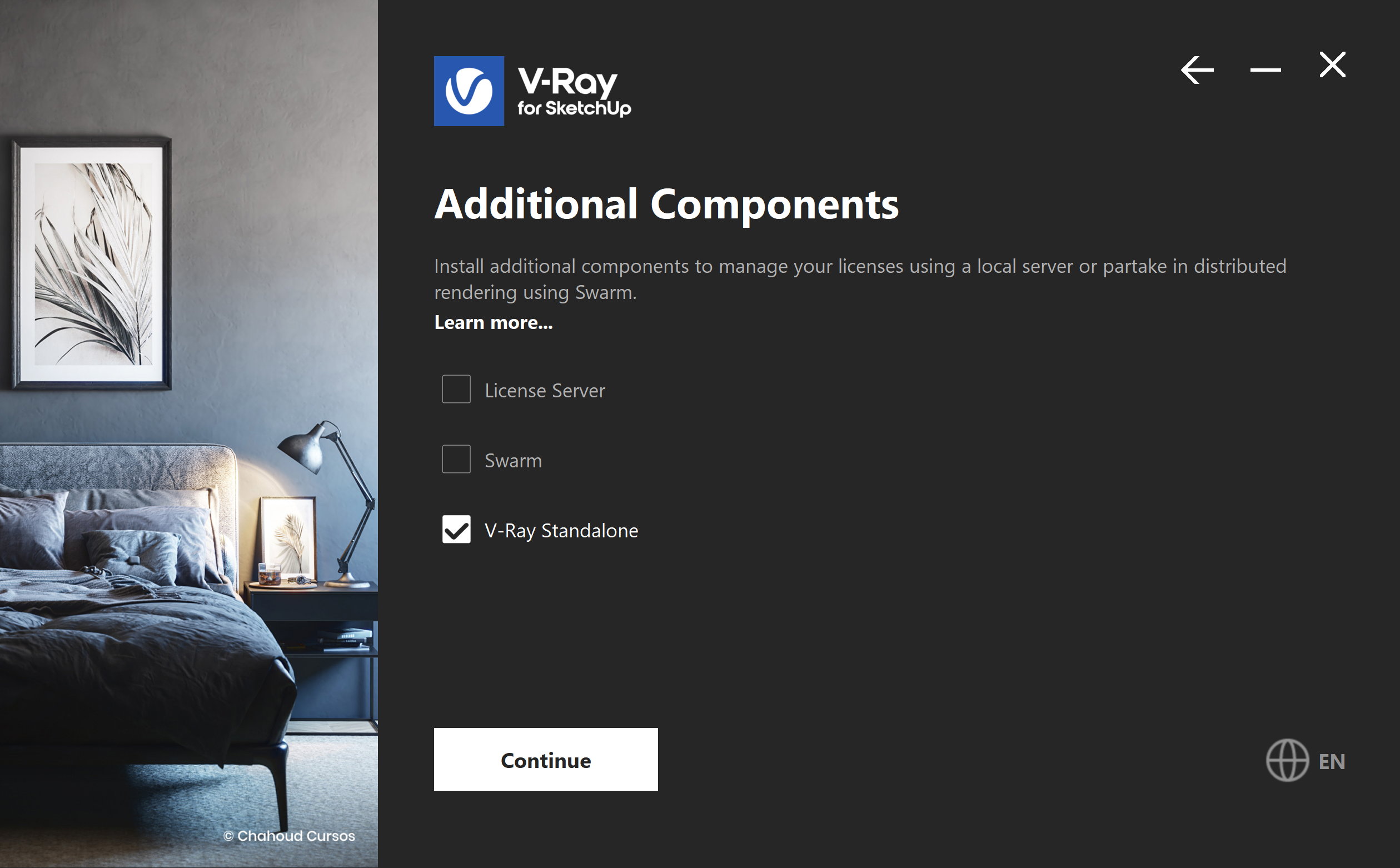

  • On the Additional Components screen, select V-Ray Standalone and complete the installation.SketchUp2025_VRay7.1.0_Installe_Components.png

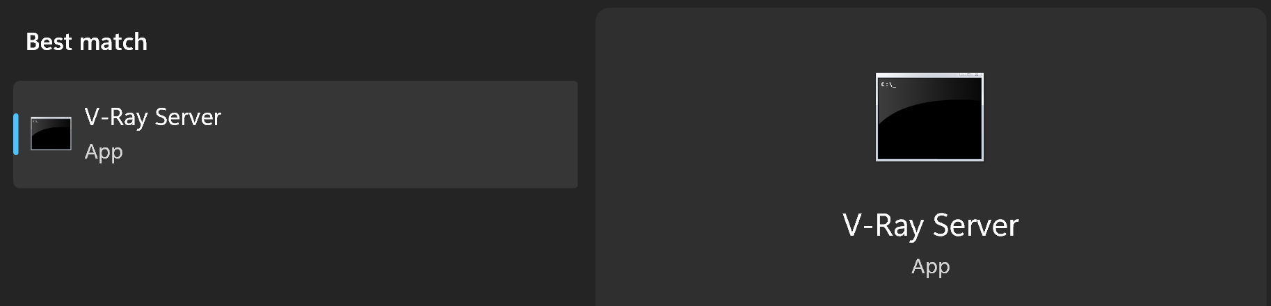

  • Use the provided Windows shortcut to run V-Ray Standalone as a server.DR_Shortcut.png

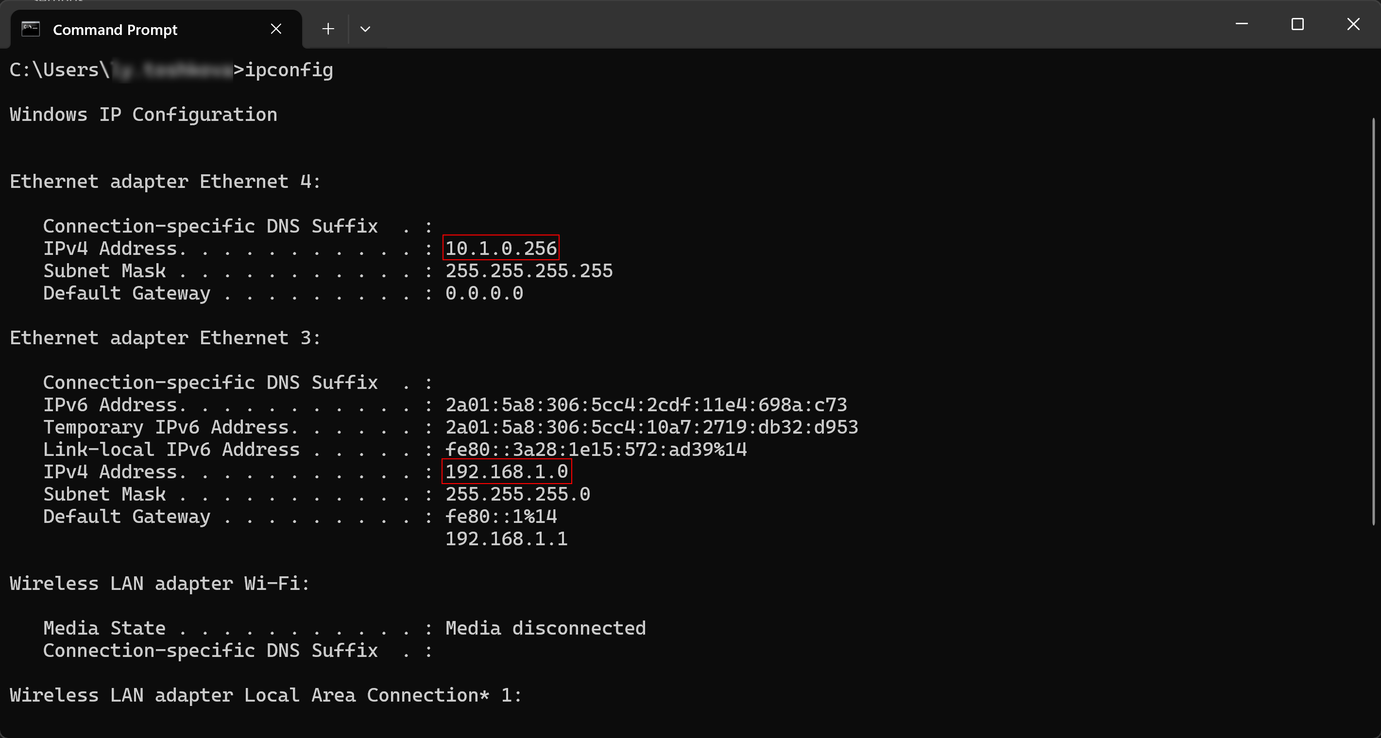

  • Find the machine’s IP address using the ipconfig command in a Command Prompt.DR_IP.png

What does the “Don’t Use Local Machine” option do?
When enabled, the local machine is excluded from rendering while the other configured nodes handle the job.
