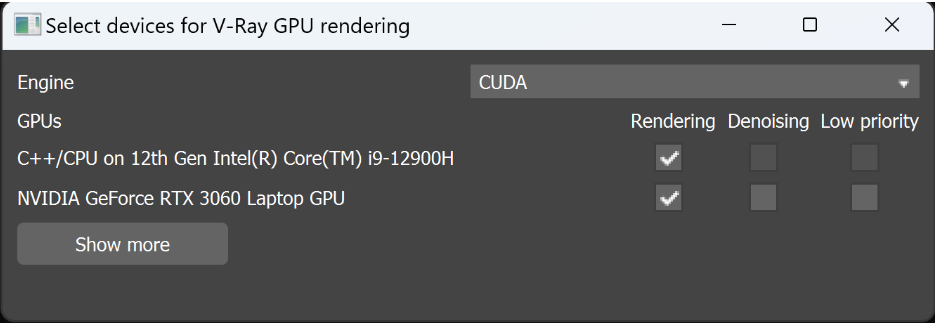

To get the full performance of your system, simply enable the C++/CPU device from the list of CUDA devices. As of V-Ray 6, this is the default behavior.
Preview of the V-Ray GPU Render Device Select rollout in 3ds Max
Learn more in our article about How to use the GPU Device Selector in V-Ray.

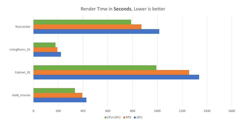

For our tests, we benchmarked 4 user-provided production scenes. We used a Ryzen 9 5950X 16-core CPU and an RTX 3090 24GB Founders Edition, unconnected to a monitor.
The results tell us that the addition of the CPU cores helped reduce render times by 21 - 34%.
Results from the tests

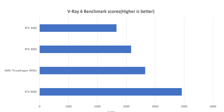

The RTX engine doesn’t use hybrid rendering for technical reasons, but we've added its results in the graphs for comparison. In most cases, using the total system performance (CUDA + CUDA-x86) is faster than using the RTX engine. Additionally, CPUs with very high core counts (e.g., an AMD Threadripper) can often rival the speed of high-end GPUs:
Results from comparing a high-core CPU and various GPUs

  • While V-Ray GPU Hybrid rendering can use the CPUs and GPUs simultaneously, CPU cores and GPU cores are not identical. For example, a GPU with 2560 cores is not simply 320 times faster than an 8-core CPU. To determine the actual speed difference, check the V-Ray Benchmark results for real-world benchmark comparisons.
    Check V-Ray Benchmark results.
