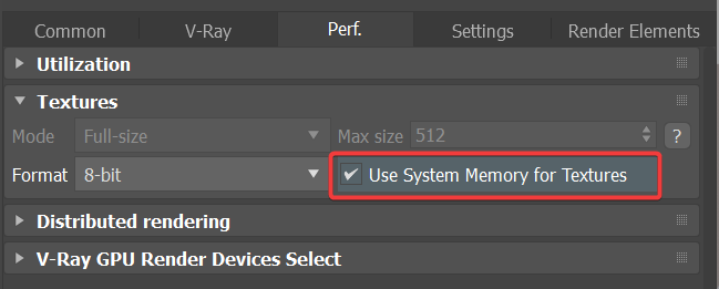

  2. Enable the "Use System Memory for Textures" option.
Preview of the "Use System Memory for Textures" option location in 3ds Max
When enabled, all textures that are bigger than 1 MB in size will be allocated in CPU memory and become accessible to all rendering devices. If your scene data already fits in the GPU memory, we recommended sticking to it.
Where to find the option:

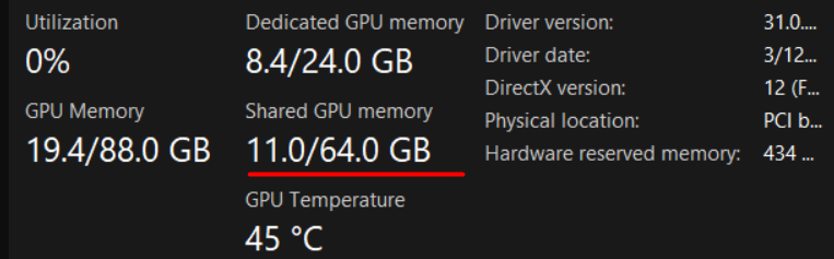

  •  Windows Task Manager
    When "Use System Memory for Textures" is enabled, the texture memory will be reported under Shared GPU memory.
Preview of the Windows Task Manager's Shared GPU memory reports

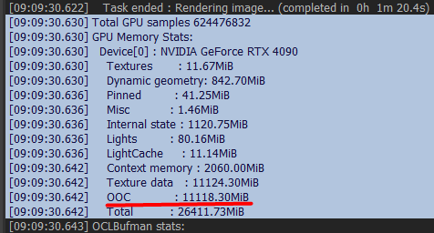

  • V-Ray Log
    When "Use System Memory for Textures" is enabled, the V-Ray log will report the texture memory transferred in the "OOC" line.
