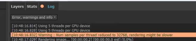

  • Slower rendering warning
Num samples per thread reduced to XXXXX, rendering might be slower
Example warning printed in the V-Ray log

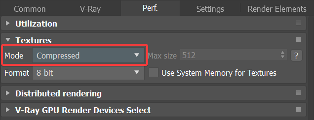

  • Using Compressed textures (V-Ray 6.1 and later)
    The Compressed Mode uses special compression for your bitmaps to reduce memory usage without sacrificing quality. It could be very useful for scenes and assets using many high-resolution bitmaps.
    Not all textures are compressed using this option; exceptions are made based on the bitmap usage. For example:
    • Bitmaps used for both normal/bump and color maps
    • Bitmaps used for displacement
    • Bitmaps used for lens effects.
The texture compression happens in a pre-pass before the rendering process starts. This mode affects rendering performance slightly for machines with a single GPU. Compressed Textures mode also works well for animation rendering, reducing flickering.
Preview of the Texture Mode option's location in 3ds Max

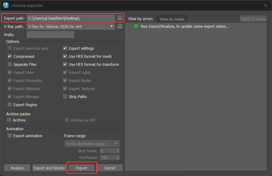

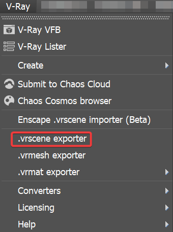

  1. Go to the V-Ray shelf menu and choose .vrscene exporter
Preview of the .vrscene exporter option's location
  1. Export a .vrscene

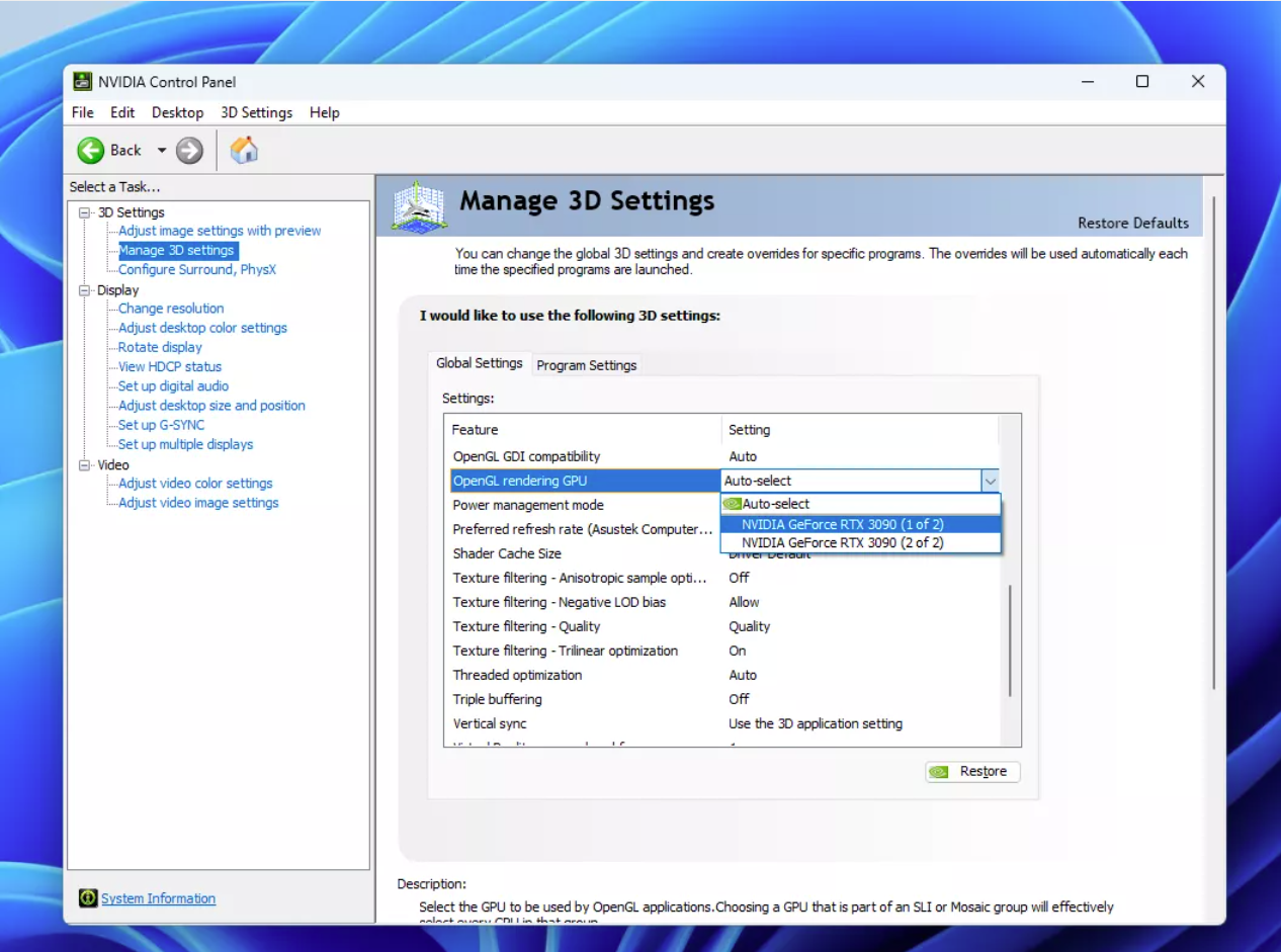

    If you have more than one GPU, you can set one of your GPUs to be used for Viewport Performance. Open NVIDIA Control Panel, and set the OpenGL rendering GPU to this device. The host DCC will use this device for viewport performance.
Preview of the OpenGL rendering GPU option

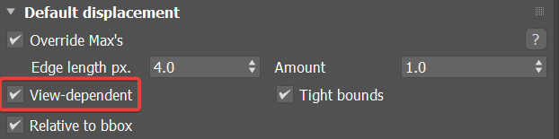

  • Optimizing Displacement

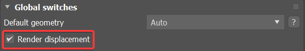

    Displacement and Subdivision of objects tend to consume a lot of GPU memory. For quick troubleshooting, you can disable/enable displacement from Global Swatches in the Settings tab to see its impact on GPU memory usage.
    Preview of the Displacement switch in the Render Settings in 3ds Max
    If you are able to render, then the issue lies in the Displacement.
    To optimize, consider:
    1. Lowering the Edge Length in the Global Displacement Defaults / VRayDisplacementMod
    2. Enabling the View-Dependent mode in the Global Displacement Defaults / VRayDisplacementMod.
      This option causes the Edge Length to be calculated in Screen pixels. For higher resolutions, the Edge Length should be lowered accordingly.
      Preview of the View-dependent option's location in the Render Settings in 3ds Max
      Learn more in our article on Optimizing V-Ray displacement.

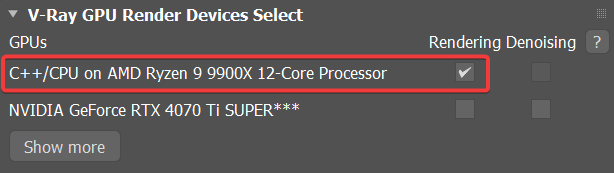

  • Using the V-Ray GPU CUDA-x86 engine (CPU)
    Although this method is not an effective approach in terms of render times, since V-Ray GPU won't benefit from using your fast GPUs, it is still possible for a scene to be rendered with V-Ray GPU using the V-Ray GPU CUDA-x86 engine (CPU). This method uses system memory (paging is supported).
Preview of the V-Ray GPU Render Device Select rollout in 3ds Max
