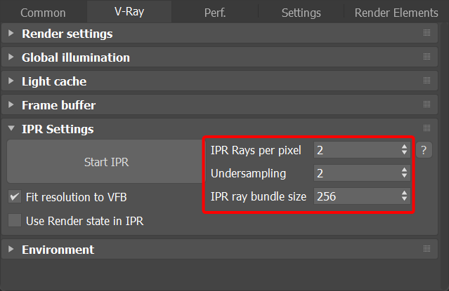

Interactive rendering
Since the default settings are optimized for best interactivity on mid-range GPUs, for optimal performance on high-end GPUs, it is necessary to adjust the interactive rendering settings.
Preview of the default IPR settings in 3ds Max
Read more about the GPU IPR Settings:
Recommendations
  • IPR Rays per pixel: 2 - 8
    Increasing this value increases the utilization of higher-end cards.
  • IPR ray bundle size: 128 - 512
  • Undersampling: personal preference
Sample presets
  • Preset for high-end GPUs (RTX 3090 and RTX 4090):
    IPR Rays per pixel: 4
    IPR ray bundle size: 256
    Undersampling 2
  • Preset for multiple high-end GPUs:
    IPR Rays per pixel: 8
    IPR ray bundle size: 512
Video demonstration of the IPR performance in Maya

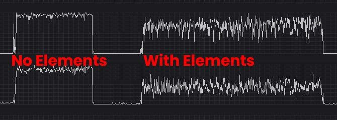

  • Use the less Render Elements
    Render elements have a big impact on GPU performance as seen in the graph below, which compares a scene with and without 25 render elements. Notice the larger fluctioations in GPU utilization.
    GPU utilization comparison between rendering with and without render elements

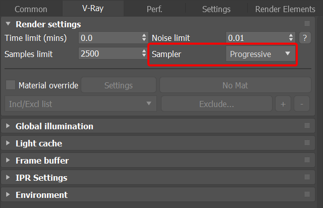

  • Use Progressive Image Sampler for production rendering.
    Generally, it is faster and more memory efficient than Bucket mode.
