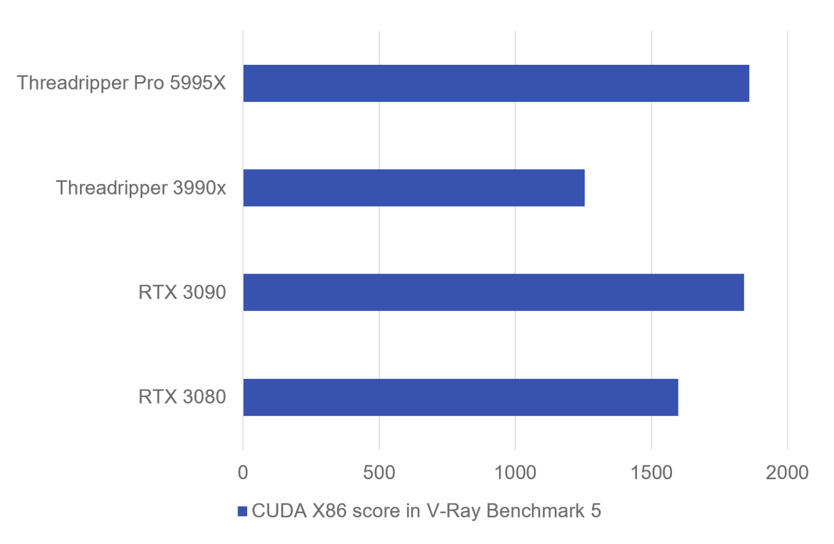

    The contribution of a CPU is similar to that of adding another (typically smaller) GPU to a multi-GPU configuration. CPUs with very high core counts (e.g., an AMD Threadripper) can often rival the speed of a GPU as shown in the graph below:
