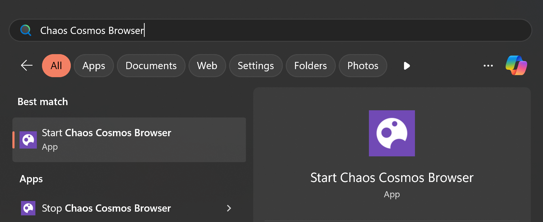

If the Cosmos Tab and the Chaos Cosmos Browser are not available and are greyed out, check whether the Cosmos Browser process (cbservice.exe) is properly running in the background. You must either Start Chaos Cosmos Browser process manually from the Windows Start Menu, or restart it by manually stopping the process and starting it again.
