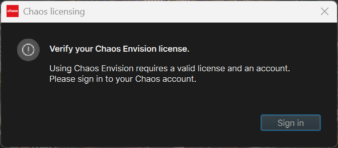

Verify your Chaos Envision license
If the "Verify your Chaos Envision license" message appears, it indicates that the application cannot validate the user's license due to a potential login or background service issue. This error may occur if some of the background processes are stuck, not running, or blocked:
  • Chaos Unified Login - ula.exe
  • Chaos Unified Login Supervisor - ulasupervisor.exe
  • Chaos License Server - vrol.exe
  • Chaos License Server Supervisor - vrlsupervisor.exe
  • Chaos Cosmos Browser Service - cbservice.exe
Go to Task Manager > Processes and you should see the above five processes. You must terminate the processes labeled as supervisor first, and then proceed to terminate the rest of the processes. Upon finishing the manual termination, start the Chaos Unified Login, Chaos License Server and Chaos Cosmos Browser Service processes again (the supervisor processes run automatically). You can start them by typing their names in the Windows Start Menu ("Start Chaos Unified Login", "Start Chaos License Server", "Start Chaos Cosmos Browser").
