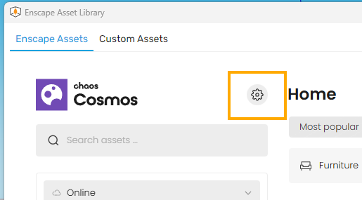

  1. Open the Asset Library to access the Cosmos browser and locate the Settings menu. cosmossettings.png
  2. In the Settings menu, determine which folder you would like to download the assets to.
  3. Click the "Download assets" button to start the download.
