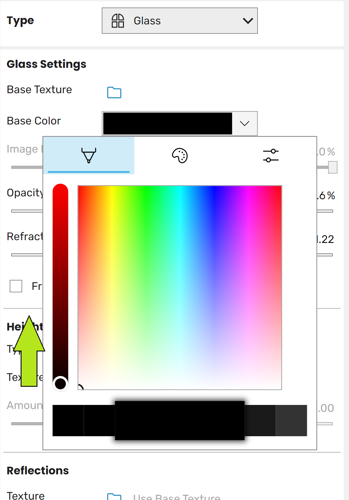

If a window, or a glass object renders black or matte, this could potentially be happening due to the updated glass material type.
To resolve this, move the 'Base color' slider up to the brightest/most saturated end in the color picker. Please see the screenshot for reference - in this example, it has to be moved from black, up to the brightest red:
