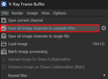

Exporting render elements from the multi-channel EXR
You can load the EXR in the V-Ray Frame Buffer and save each render element as its own file.
  1. Load the EXR file from Chaos Cloud in the V-Ray Frame Buffer: File > Load image.
  2. Save all render elements to separate files: File > Save all image channels to separate files. Choose the file type and location you prefer.
    Preview of the "Save all image channels to separate files" option location
