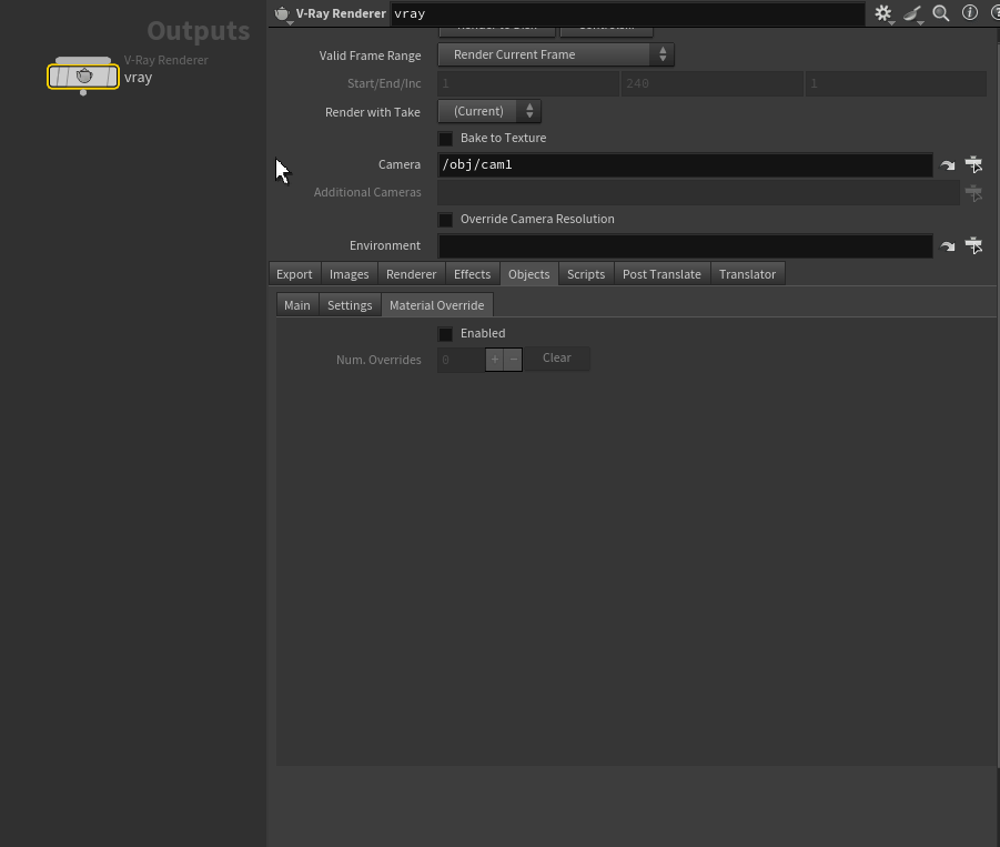

Material Override in Houdini
Using VRayRenderer ROP override:
  1. On the VRayRenderer node (your render output node), go to the “Overrides” tab.
  2. Here you can set Material override. This allows you to specify a global override material for everything.

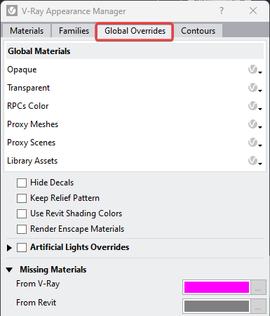

Material Override in Revit
  1. Enable V-Ray and open V-Ray Appearance Manager.
  2. In the Global Override Tab you can find options for materials and light overrides.

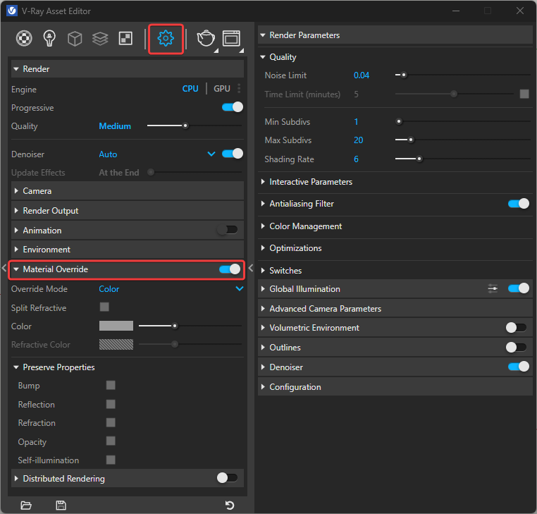

Material Override in SketchUp and Rhino
  1. Open V-Ray Asset Editor and click on Settings Tab.
  2. Enable Material Override option. Here you can adjust Override Mode and Preserve Properties.
