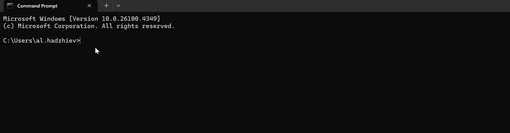

6. Open V-Ray Standalone and add the edited .vrscene after the -sceneFile flag:
  • Start the Command Prompt by clicking on the Windows start button and typing cmd
  • Paste the following code (the paths per host application are listed at the end of the article):
    cd C:\ProgramData\Autodesk\ApplicationPlugins\VRay3dsMax2026\bin
  • Press Enter
  • Type the following code:
    vray.exe -sceneFile= \path\to\exported\scene.vrscene
Demonstration of submitting a scene to render with VRayStandalone
7. Press Enter to start the rendering.
The VFB will open in preview mode to save memory. It won’t show the whole resolution, and you cannot zoom as usual. The image will be automatically saved; you don’t have to save it from the VFB.
