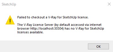

The "Failed to checkout Chaos license" error indicates that you either do not have access to the Chaos license server, or the license itself is unavailable.

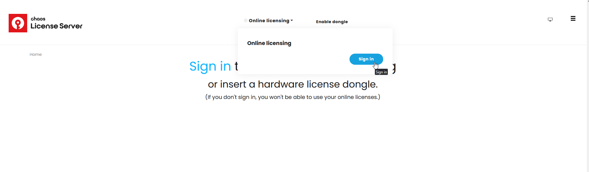

Ensure that the Chaos license server is installed. If it is running correctly, you should be able to view your licenses by opening an internet browser on the license server computer and navigating to its status page at http://localhost:30304.
License server status page screenshot
2. Verify Online Licensing
If you are using online licensing, ensure you are logged in with the correct Chaos username/email associated with your license. To switch accounts, go to "Online licensing" Deactivate/Sign Out, and then "Online licensing" Enable/Sign In with the correct account.
