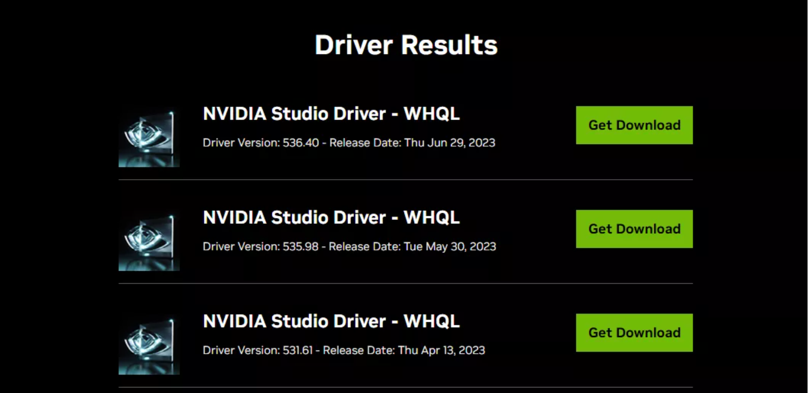

From the list of available drivers, select the recommended driver, click Get Download, then click Download Now on the next page.
Select the recommended version from the list

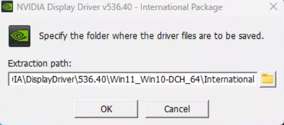

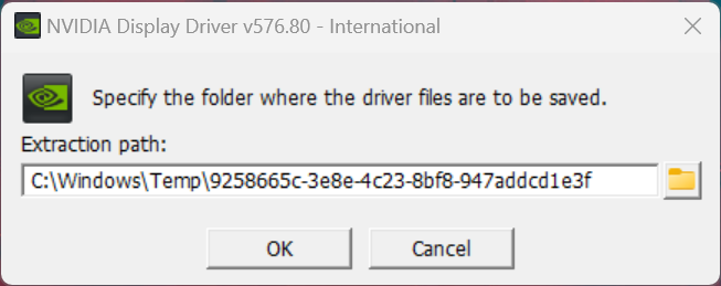

  1. Once driver is downloaded, run the installer as Administrator. When prompted for an extraction path, you can keep the default and continue:
Note: Before installing driver, make sure to save your work and close all other applications.

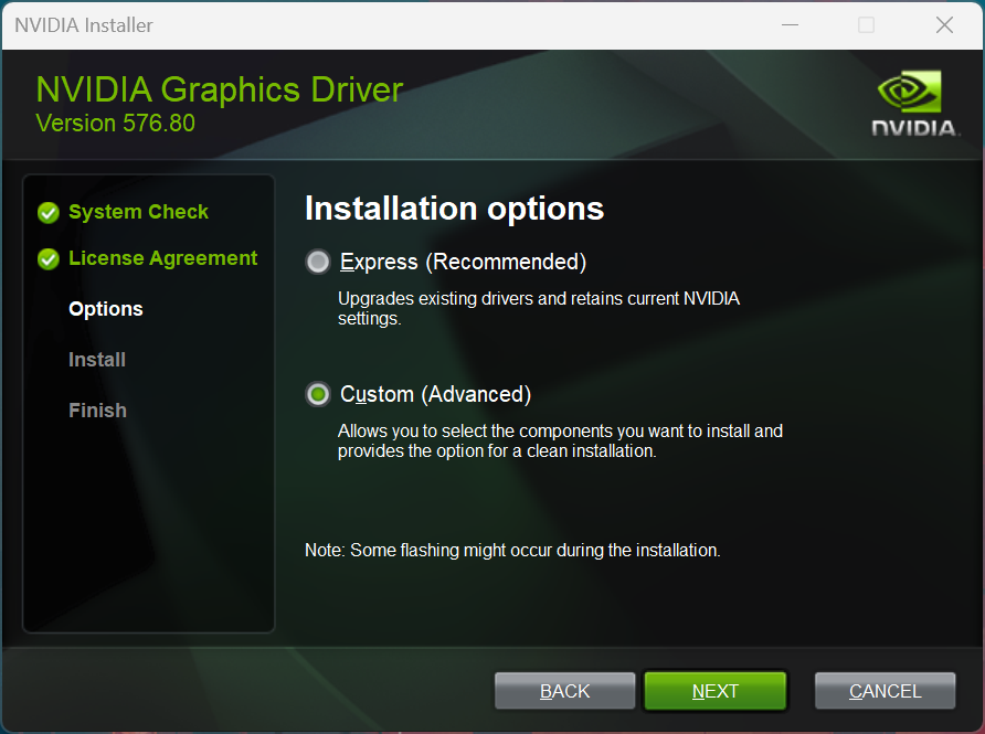

  1. In the Installation options select Custom (Advanced) instead of Express. Next enable the Perform a clean installation option.
    Note: Clean installation resets your NVIDIA Control Panel settings. You will need to reapply any custom settings after the driver installation.

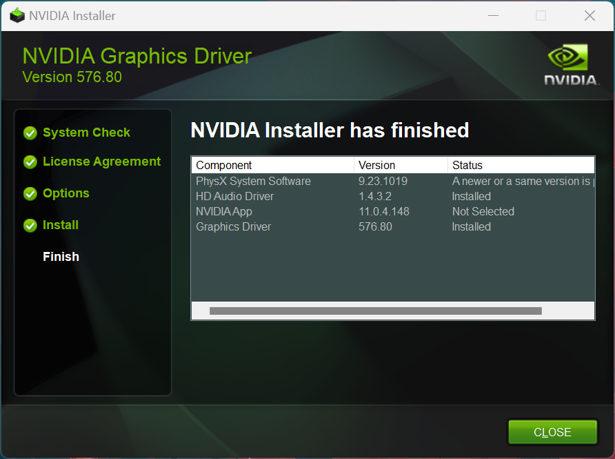

  1. Click Next, and wait for the installation to finish:
Note: Your display may flicker several times during installation - this is normal.

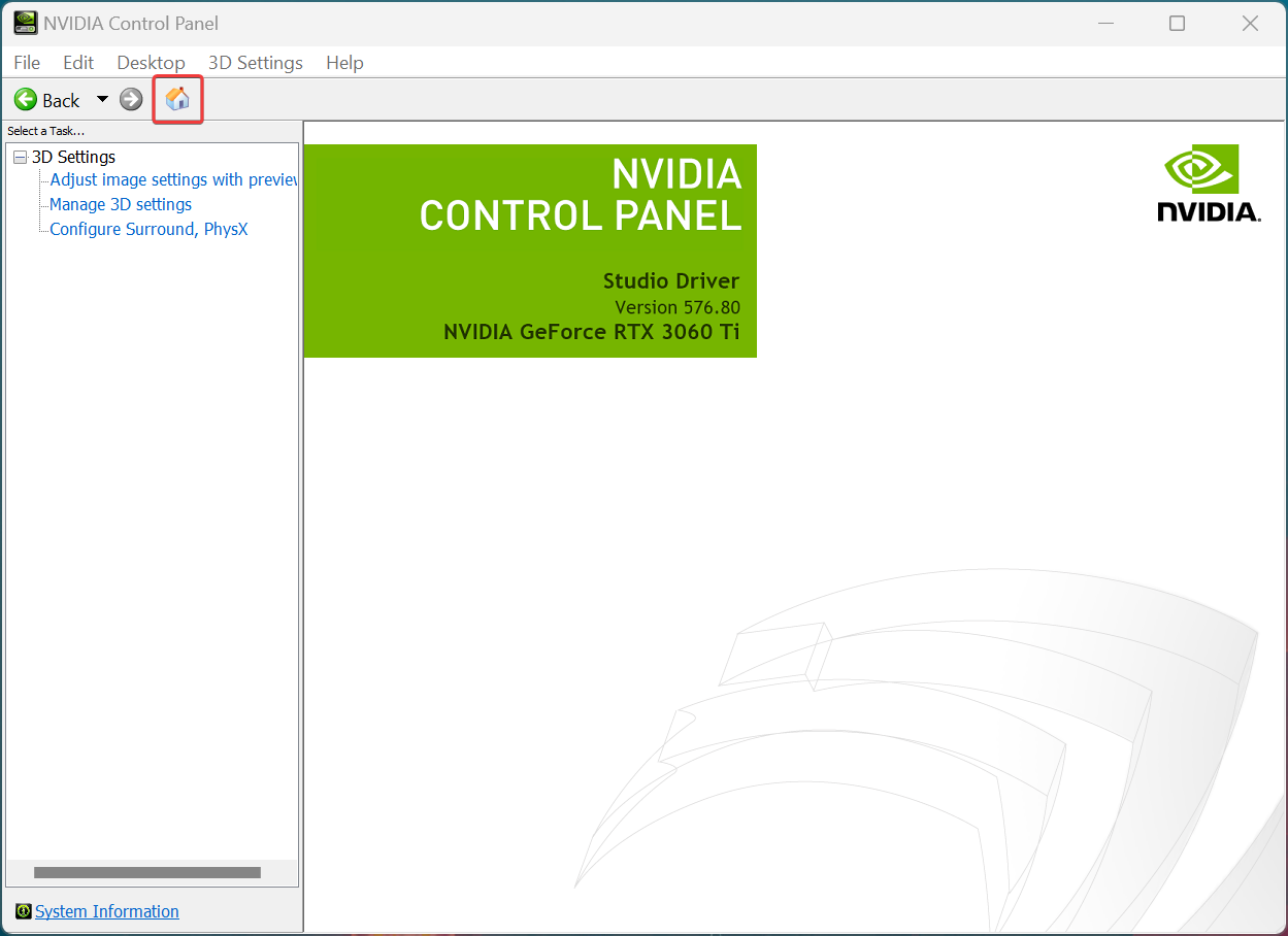

  • Click Home to view the currently installed driver version:

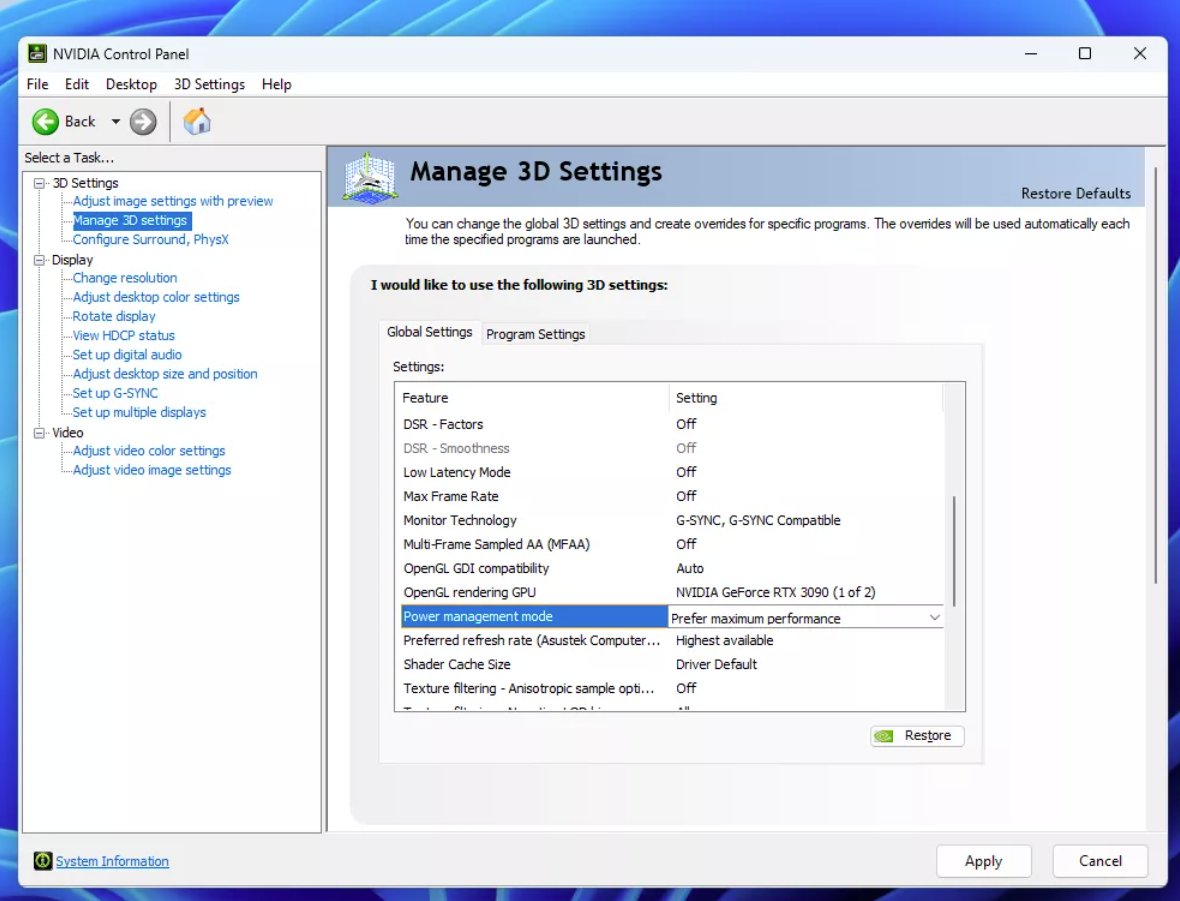

  • Go to Manage 3D Settings, Scroll down to Power Management Mode, and change it to Prefer Maximum Performance (this slightly increases the power draw of the GPUs in an idle state by a slight margin, this is very important to avoid performance issues on GPU rendering with Vantage and V-Ray GPU). Click on Apply:

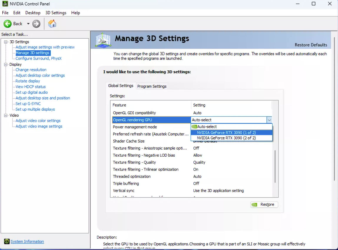

  • If you have multiple GPUs, change OpenGL rendering GPU to the card you have your monitors attached to (this card will be used for viewport performance across all DCC applications) and Click on Apply changes:
